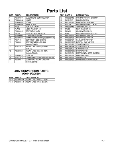

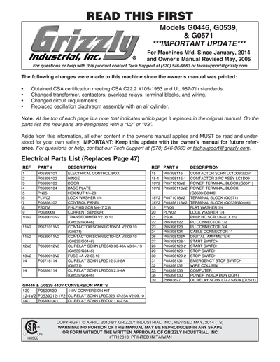

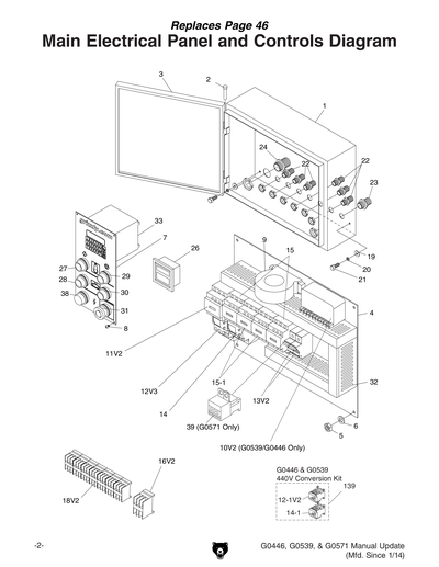

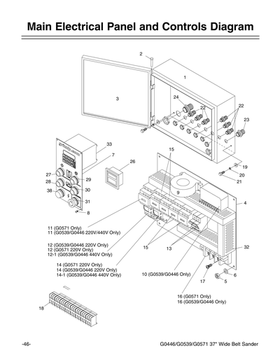

ELECTRICAL CONTROL BOX
HINGE
ELECTRICAL CONTROL BOX OF DOOR
BASE PLATE
Now: PN05
HEX NUT 1/4-20
Now: PLW02
LOCK WASHER 1/4
*DISCD*CONTROL PANEL
Now: PS07M
PHLP HD SCR M4-.7 X 8
PROPORTIONAL CURRENT DEVICE
CONTACTOR SCHN LC1D50A V2.09.10
11V2
$215.55
RELAY TE LR3D3359 220C 48-65A
$210.15
FUSE 4A GL CT 2PC V1.07.05
13V2
FUSE 4A V2.03.10
RELAY TE LR3D126 220V 5.5-8A
$44.10
CONTACTOR SCHN LC1D096M7 220V
POWER JUNCTION BLOCK 3P100A TEND V1.05.0
$71.90
16V2
POWER TERMINAL BLOCK ENTRELEC V2.03.10
$129.25
Now: PS51M
PHLP HD SCR M4-.7 X 30
TERMINAL PLATE IN13BK MARK V1.07.05
18V2
$227.65
Now: PW06
FLAT WASHER 1/4
Now: PLW02
LOCK WASHER 1/4
Now: PS04
PHLP HD SCR 1/4-20 X 1/2
PU CONNECTOR 1/2"
PU CONNECTOR 3/4"
CABLE CONNECTOR 1"
***USE PH29338126A***
START SWITCH
START SWITCH
E-STOP BUTTON 250V 10A
***USE P08191748***
WIRE COLUMN
COMPUTER
POWER INDICATOR LIGHT 220V 22MM WHT
OL RELAY SCHN LT47 5-60A
$235.20

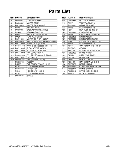

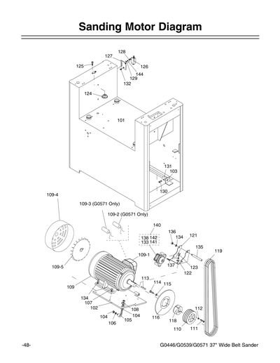

MACHINE FRAME
MOTOR BASE
MOTOR BASE HINGE
Now: PN06
HEX NUT 1/2-12
BASE ADJUSTMENT ROD
106
Now: PLW07
LOCK WASHER 1/2
107
Now: PB24
HEX BOLT 3/8-16 X 1-1/4
108
Now: PW01
FLAT WASHER 1/2
109
SANDING BELT MOTOR 10HP 220V 1-PH
109-1
MOTOR COVER
$9.70
109-2
START CAPACITOR
$58.00
109-3
R CAPACITOR 100M 300V 2-3/4 X 4
$162.15
109-4
MOTOR FAN COVER
109-5
MOTOR FAN
110
PULLEY
111
CAP SCREW 5/16-18 X 1-1/2
112
Now: PLW01
LOCK WASHER 5/16
113
KEY 8 X 10 X 75
114
Now: PB03
HEX BOLT 5/16-18 X 1
115
Now: PLW01
LOCK WASHER 5/16
116
BRAKE
118
PULLEY BUSHING
119
Now: PVA71
V-BELT A71
121
BRAKE BRACKET
122
Now: PW02
FLAT WASHER 3/8
123
Now: PB21
HEX BOLT 3/8-16 X 3/4
124
FLAT HEAD NUT
125
CAP SCREW 1/4-20 X 3/4
126
***USE P99791126***
127
LIMIT SWITCH PLATE
128
Now: PS04
129
Now: PW06
FLAT WASHER 1/4
130
CAP SCREW 5/16-18 X 3/4
131
COVER
132
FLAT HD SCR M6-1 X 25
133
BRAKE ARBOR
134
Now: PLW04
LOCK WASHER 3/8
135
BRAKE PIN
136
Now: PN08
HEX NUT 3/8-16
137
CAP SCREW M5-.8 X 15
138
BRAKE LINING
140
COMPLETE BRAKE ASSY
141
BRAKE SPRING 3.3 X 24.5 X 24
142
BRAKE ARBOR PLATE
144
Now: PLW02
LOCK WASHER 1/4

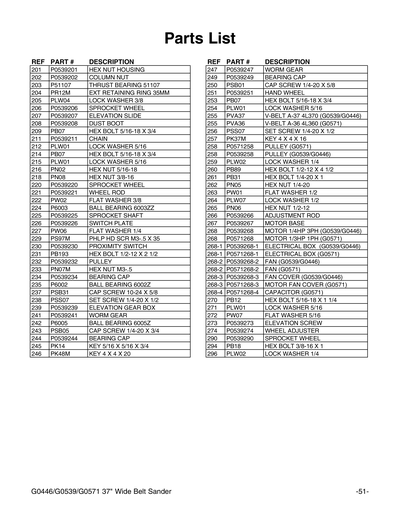

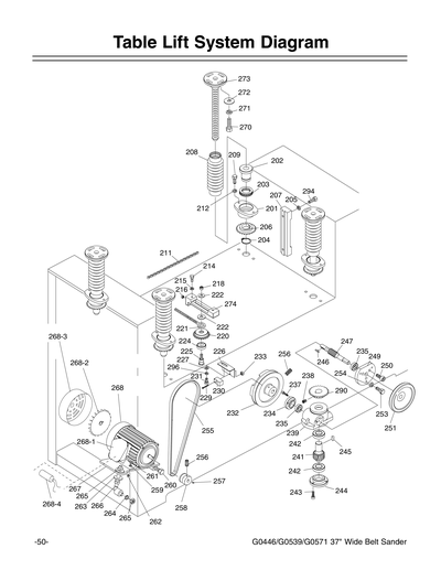

201
HEX NUT HOUSING
202
COLUMN NUT
203
THRUST BEARING 51107
204
Now: PR12M
EXT RETAINING RING 35MM
205
Now: PLW04
LOCK WASHER 3/8
206
LEADSCREW SPROCKET 24T
207
ELEVATION SLIDE
208
DUST BOOT
209
Now: PB07
HEX BOLT 5/16-18 X 3/4
211
CHAIN
212
Now: PLW01
LOCK WASHER 5/16
214
Now: PB07
215
Now: PLW01
LOCK WASHER 5/16
216
Now: PN02
HEX NUT 5/16-18
218
Now: PN08
HEX NUT 3/8-16
220
SPROCKET WHEEL
221
WHEEL ROD
222
Now: PW02
FLAT WASHER 3/8
224
Now: G3850
Bearing - 35mm x 17mm
225
SPROCKET SHAFT
226
PROXIMITY SWITCH PLATE
227
Now: PW06
FLAT WASHER 1/4
229
Now: PS97M
PHLP HD SCR M3-.5 X 34
230
PROXIMITY SWITCH
231
Now: PB19
HEX BOLT 1/4-20 X 1/2
232
PULLEY
233
Now: PN07M
HEX NUT M3-.5
234
BEARING CAP
235
BALL BEARING 6002Z
237
CAP SCREW 10-24 X 5/8
238
Now: PSS07
SET SCREW 1/4-20 X 1/2
239
ELEVATION GEAR BOX
241
WORM GEAR
242
BALL BEARING 6005Z
243
244
BEARING CAP
245
Now: PK14
KEY 5/16 X 5/16 X 3/4
246
Now: PK48M
KEY 4 X 4 X 20
247
WORM GEAR
249
BEARING CAP
250
CAP SCREW 1/4-20 X 5/8
251
HAND WHEEL
253
Now: PB07
254
Now: PLW01
LOCK WASHER 5/16
255
Now: PVA36
V-BELT A36
256
Now: PSS07
257
Now: PK37M
KEY 4 X 4 X 16
258
PULLEY
$55.00
259
Now: PLW02
LOCK WASHER 1/4
260
Now: PB89
HEX BOLT 1/2-12 X 4-1/2
261
Now: PB31
HEX BOLT 1/4-20 X 1
262
Now: PN05
HEX NUT 1/4-20
263
Now: PW01
FLAT WASHER 1/2
264
Now: PLW07
LOCK WASHER 1/2
265
Now: PN06
HEX NUT 1/2-12
266
ADJUSTMENT ROD
267
MOTOR BASE
268
TABLE ELV MOTOR 1/3HP 220V 1-PH
268-1
MOTOR ELECTRICAL BOX
$6.70
268-2
MOTOR FAN
$9.10
268-3
MOTOR FAN COVER
268-4
S CAPACITOR 100M 250V 1-1/2 X 2-1/2 W/RE
$13.35
270
Now: PB12
HEX BOLT 5/16-18 X 1-1/4
271
Now: PLW01
LOCK WASHER 5/16
272
Now: PW07
FLAT WASHER 5/16
273
***USE PH29332101***
274
CHAIN TENSIONER BRACKET
290
SPROCKET WHEEL
294
Now: PB18
HEX BOLT 3/8-16 X 1
296
Now: PLW02
LOCK WASHER 1/4

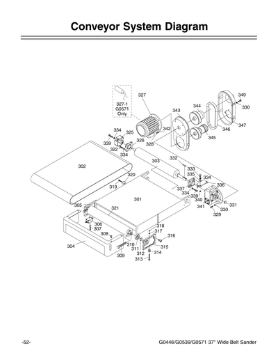

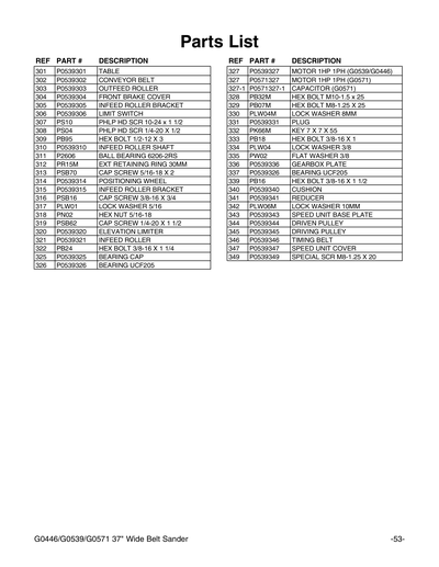

301
TABLE
302
CONVEYOR BELT
303
OUTFEED ROLLER
304
BRAKE COVER FRONT
305
INFEED ROLLER BRACKET
306
LIMIT SWITCH
307
Now: PS10
PHLP HD SCR 10-24 X 1-1/2
308
Now: PS04
309
Now: PB95
HEX BOLT 1/2-12 X 3
310
INFEED ROLLER SHAFT
311
BALL BEARING 6206-2RS
312
Now: PR15M
EXT RETAINING RING 30MM
313
CAP SCREW 5/16-18 X 2
314
POSITIONING WHEEL
315
316
CAP SCREW 3/8-16 X 3/4
317
Now: PLW01
LOCK WASHER 5/16
318
Now: PN02
HEX NUT 5/16-18
319
CAP SCREW 1/4-20 X 1-1/2
320
ELEVATION LIMITER
321
INFEED ROLLER
322
Now: PB24
325
BEARING CAP
326
BEARING UCF205
327
MOTOR 1HP 220V 1-PH
$515.05
327-1
CAPACITOR
$67.05
328
Now: PB32M
HEX BOLT M10-1.5 X 25
329
Now: PB07M
HEX BOLT M8-1.25 X 25
330
LOCK WASHER 8MM
331
PLUG
332
Now: PK66M
KEY 7 X 7 X 55
333
Now: PB18
HEX BOLT 3/8-16 X 1
334
Now: PLW04
LOCK WASHER 3/8
335
Now: PW02
FLAT WASHER 3/8
336
GEARBOX PLATE
337
BEARING UCF205
339
Now: PB16
HEX BOLT 3/8-16 X 1-1/2
340
CUSHION
341
REDUCER
342
LOCK WASHER 10MM
343
SPEED UNIT BASE PLATE
344
DRIVEN PULLEY
345
DRIVING PULLEY
346
TIMING BELT
347
SPEED UNIT COVER
349
Now: PB09M
HEX BOLT M8-1.25 X 20
350
MOTOR 1/4HP 220V/440V 3-PH

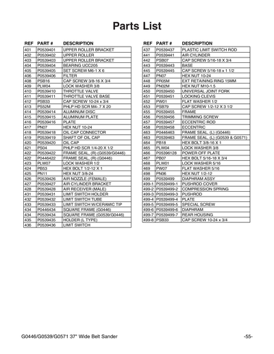

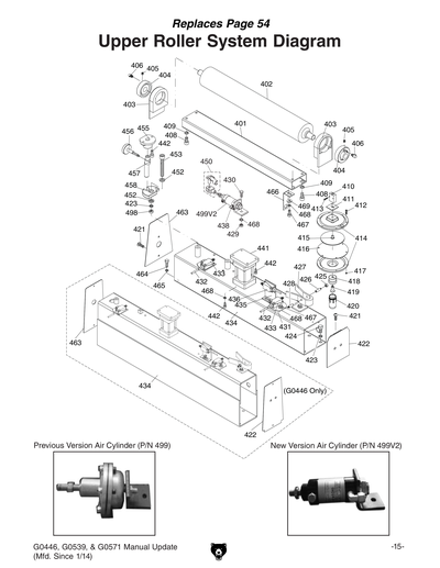

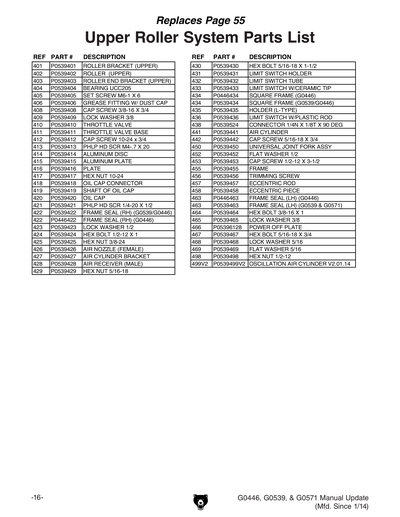

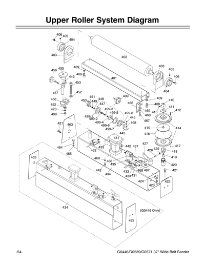

401
ROLLER BRACKET UPPER
402
ROLLER UPPER
403
404
CARTRIDGE BEARING UCC205
405
SET SCREW M6-1 X 6
406
GREASE FITTING W/DUST CAP
408
409
Now: PLW04
LOCK WASHER 3/8
410
***USE PH29336121***
411
THROTTLE VALVE BASE
412
CAP SCREW 10-24 X 3/4
413
Now: PS52M
PHLP HD SCR M4-.7 X 20
414
ALUMINUM DISC
415
ALUMINUM PLATE
416
DIAPHRAM
417
Now: PN07
HEX NUT 10-24
418
OIL CAP CONNECTOR
419
SHAFT OF OIL CAP
420
OIL CAP
421
Now: PS04
422
FRAME SEAL RIGHT
423
Now: PLW07
LOCK WASHER 1/2
424
Now: PB53
HEX BOLT 1/2-12 X 1
425
Now: PN11
HEX NUT 3/8-24
426
AIR NOZZLE FEMALE
427
***USE PH29336119***
428
***USE PH29336120***
429
Now: PN02
HEX NUT 5/16-18
430
Now: PB11
HEX BOLT 5/16-18 X 1-1/2
431
LIMIT SWITCH HOLDER
432
LIMIT SWITCH CERAMIC TIP
433
LIMIT SWITCH CERAMIC ASSY
434
SQUARE FRAME
435
HOLDER L TYPE
436
LIMIT SWITCH W/ PLASTIC ROD
437
LIMIT SWITCH ROD PLASTIC
438
CONNECTOR 1/4N X 1/8T-90-DEG
441
***USE PH29336113***
442
443
BASE
445
447
Now: PN07
HEX NUT 10-24
448
Now: PR05M
EXT RETAINING RING 15MM
449
Now: PN02M
HEX NUT M10-1.5
450
CLEVIS ASSEMBLY
451
CLEVIS ASSEMBLY
452
Now: PW01
FLAT WASHER 1/2
453
CAP SCREW 1/2-12 X 3-1/2
455
ECCENTRIC SHAFT FRAME
456
TRIMMING SCREW
457
ECCENTRIC ROD
458
ECCENTRIC
463
FRAME SEAL LEFT
464
Now: PB18
HEX BOLT 3/8-16 X 1
465
Now: PLW04
LOCK WASHER 3/8
466
SANDING BELT POWER OFF PLATE
467
Now: PB07
468
Now: PLW01
LOCK WASHER 5/16
469
Now: PW07
FLAT WASHER 5/16
498
Now: PN06
HEX NUT 1/2-12
499

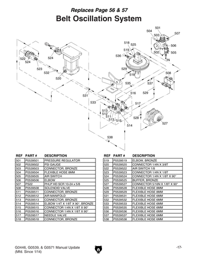

*DISCD*DIAPHRAM ASSY V1
499-1
PUSHROD COVER
499-2
COMPRESSION SPRING 3.3 X 24.5 X 24
499-3
PUSHROD
499-4
PLATE
499-5
DIAPHRAM SCREW
499-6
DIAPHRAGM
499-7
TOP COVER
499-8
499V2
OSCILLATION AIR CYLINDER 30 X 4 V2.01.14

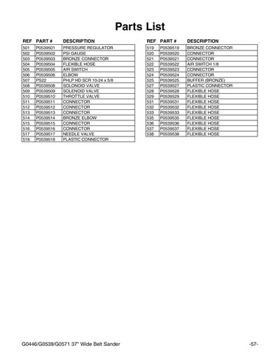

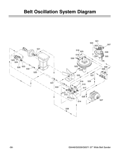

501
PRESSURE REGULATOR W/PSI GAUGE
502
503
CONNECTOR BRONZE
504
FLEXIBLE HOSE 8MM
505
AIR SWITCH
506
ELBOW
507
Now: PS22
PHLP HD SCR 10-24 X 5/8
508
SOLENOID VALVE
509
SOLENOID VALVE
510
THROTTLE VALVE
511
CONNECTOR
512
AIR MANIFOLD 4-PORT
513
CONNECTOR
514
ELBOW 1/4T X 1/8T X 90 DEG, BRONZE
515
516
517
THROTTLE VALVE
518
CONNECTOR, BRONZE
519
CONNECTOR 1/4N
520
CONNECTOR 1/4N X 3/8T
521
CONNECTOR 1/8T X 1/4N
522
AIR SWITCH 1/8"
523
524
525
BUFFER BRONZE
527
*DISCD*CONNECTOR PLASTIC V1
528
FLEXIBLE HOSE 8MM
529
FLEXIBLE HOSE 8MM
531
FLEXIBLE HOSE 6MM
532
FLEXIBLE HOSE 6MM
533
FLEXIBLE HOSE 6MM
535
FLEXIBLE HOSE 6MM
536
FLEXIBLE HOSE
537
FLEXIBLE HOSE 6MM
538
FLEXIBLE HOSE 6MM

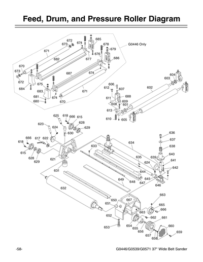

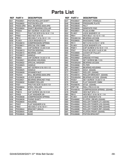

601
PISTON ROLLER SHAFT
602
PISTON ROLLER
603
BALL BEARING 6003-2RS
604
SHAFT BEARING COLLER
605
Now: PSS03
SET SCREW 1/4-20 X 3/8
606
Now: PS11
PHLP HD SCR 5/16-18 X 1-1/4
607
Now: PN02
HEX NUT 5/16-18
608
Now: PB12
609
Now: PLW01
LOCK WASHER 5/16
610
***USE PH29334103***
611
PISTON BRACKET PIN 10MM
612
613
PISTON SLIDE RAIL
615
BEARING CAP
617
HANDLE FOR FASTENING
618
CAP SCREW 1/4-20 X 1/2
621
BEARING HOUSING
622
STEP WASHER 3/8
623
HANDLE
624
Now: PSS08
SET SCREW 5/16-18 X 1/2
625
HANDLE
628
SPANNER NUT
629
BALL BEARING 6205RS
630
LEVER SHANK
631
BEARING BRACKET PAD
632
RUBBER ROLLER
633
Now: PS01
PHLP HD SCR 10-24 X 1/2
634
STEEL ROLLER
635
Now: PK34M
KEY 5 X 5 X 20
636
637
Now: PW02
FLAT WASHER 3/8
638
COMPRESSION SPRING 3.5 X 21 X 65
639
FIXING SHAFT
640
HOUSING
641
Now: PW07
FLAT WASHER 5/16
642
Now: PB03
644
BRACKET MALE
645
TUBE
646
BASE
647
***USE PH29345302***
648
PRESSURE PLATE
649
FELT PLATEN PAD 1/2 X 1-13/16 X 39"
650
GRAPHITE PAD 37" X 3-5/8"
651
BEARING HOUSING PLUG
652
Now: PLW07
LOCK WASHER 1/2
653
Now: PB41
HEX BOLT 1/2-12 X 1-1/2
654
CARTRIDGE BEARING UCC206
655
KEYED PULLEY TUBE
656
Now: PK11
KEY 5/16 X 5/16 X 1-3/16
657
Now: PLW01
LOCK WASHER 5/16
658
CAP SCREW 5/16-18 X 1-1/4
659
Now: PS07
PHLP HD SCR 1/4-20 X 3/8
660
COVER OF PULLEY
661
PULLEY
662
GREASE FITTING
663
SET SCREW M6-1 X 6
665
666
FILTER
667
BEARING HOUSING
672
SHAFT BEARING COLLAR
673
BALL BEARING 6001-2RS
688
PISTON BRACKET
689
Now: PSS03

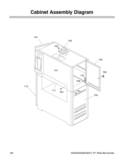

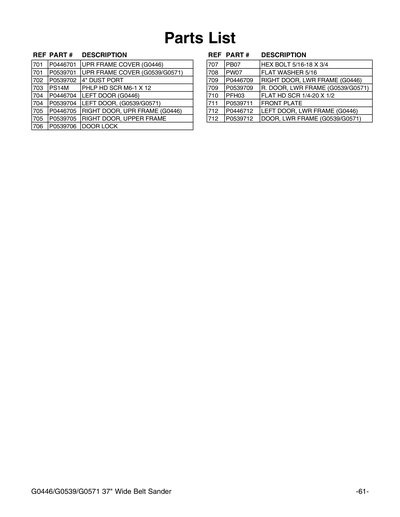

701
FRAME COVER UPPER V1
701V2
FRAME COVER UPPER V2.01.22
$2,177.15
702
DUST PORT 4"
703
Now: PS14M
PHLP HD SCR M6-1 X 12
704
DOOR LEFT UPPER FRAME
705
DOOR RIGHT UPPER FRAME
706
DOOR LOCK
707
Now: PB07
708
Now: PW07
FLAT WASHER 5/16
709
DOOR RIGHT LOWER FRAME
710
Now: PFH03
FLAT HD SCR 1/4-20 X 1/2
711
PLATE FRONT
712
DOOR LOWER FRAME

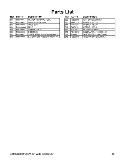

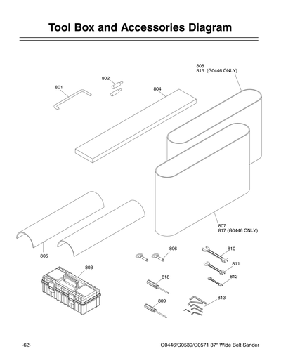

801
PLATEN REMOVAL TOOL
802
LIMIT SWITCH TUBE
803
TOOL BOX
804
805
806
DOOR KEY
807
Now: G8000
37" x 60" A/O Sanding Belt 100-Y Grit
808
SANDPAPER #180
809
FLAT HD SCREWDRIVER
810
WRENCH 17 X 19MM OPEN-ENDS
811
WRENCH 12 X 14MM OPEN-ENDS
8114
OL RELAY SCHN LR3D12 5.5-8A
$36.80
812
WRENCH 8 X 10MM OPEN-ENDS
813
814
817
*DISCD*PHLP HD SCREWDRIVER
818
PHLP HD SCREWDRIVER
MANUAL
MANUAL FOR G0571 05/05
$14.65
