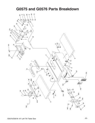

Parts Diagrams for G0575 - 1-1/2 HP 10" Table Saw

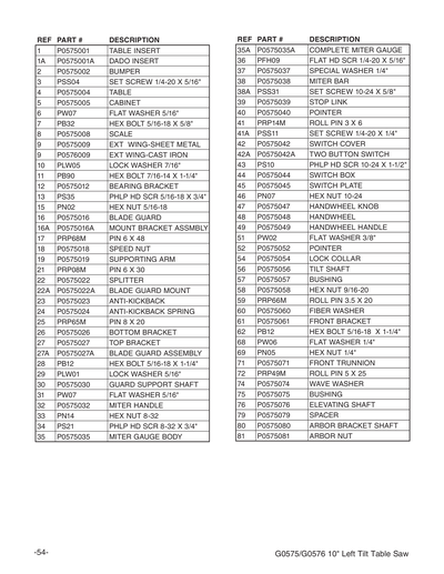

Parts List for Parts for G0575 1-1/2 HP 10" Table Saw
*DISCD*TABLE INSERT
1A
*DISCD*DADO TABLE INSERT
BUMPER
Now: PSS04
SET SCREW 1/4-20 X 5/16
TABLE
$278.90
CABINET STAND
Now: PW07
FLAT WASHER 5/16
Now: PB32
HEX BOLT 5/16-18 X 5/8
SCALE
EXTENSION WING SHEET
Now: PLW05
LOCK WASHER 7/16
Now: PB90
HEX BOLT 7/16-14 X 1-1/4
BEARING BRACKET
Now: PS35
PHLP HD SCR 5/16-18 X 3/4
Now: PN02
HEX NUT 5/16-18
*DISCD*BLADE GUARD
16A
*DISCD*MOUNTING BRACKET ASSY
ROLL PIN 6 X 48
DISC WASHER 1/4
SUPPORTING ARM
ROLL PIN 6 X 30
*DISCD*SPLITTER
22A
*DISCD*MOUNT
*DISCD*ANTI KICKBACK
ANTI KICKBACK SPRING C-SHAPE
ROLL PIN 8 X 20
*DISCD*LOWER BRACKET V1
*DISCD*UPPER BRACKET V1
27A
*DISCD*BLADE GUARD ASSY V1
Now: PB12
HEX BOLT 5/16-18 X 1-1/4
Now: PLW01
LOCK WASHER 5/16
GUARD SUPPORT SHAFT
Now: PW07
FLAT WASHER 5/16
HAND KNOB
Now: PN14
HEX NUT 8-32
Now: PS21
PHLP HD SCR 8-32 X 3/4
*DISCD*MITER GAUGE BODY
35A
*DISCD*COMPLETE MITER GAUGE ASSY
Now: PFH09
FLAT HD SCR 1/4-20 X 5/16
SLIDING BLOCK
MITER BAR
38A
Now: PSS31
SET SCREW 10-24 X 5/8
STOP LINK
POINTER
ROLL PIN 3 X 6
41A
Now: PSS11
SET SCREW 1/4-20 X 1/4
*DISCD*SWITCH BOX W/2 BUTTONS
42A
*DISCD*SWITCH
Now: PS10
PHLP HD SCR 10-24 X 1-1/2
SWITCH BOX
45
*DISCD*SWITCH FIXING PLATE
46
Now: PN07
HEX NUT 10-24

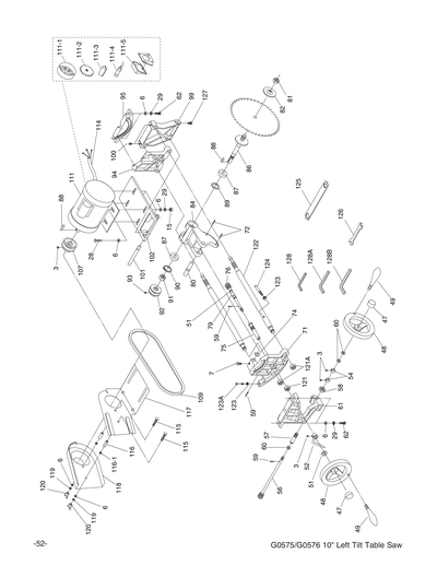

HANDWHEEL KNOB
48
HANDWHEEL
49
HANDWHEEL HANDLE
51
Now: PW02
FLAT WASHER 3/8
52
POINTER
$2.30
54
SET COLLAR
56
*DISCD*TILT SHAFT
57
ECCENTRIC
58
Now: PN16
HEX NUT 9/16-18
59
ROLL PIN 3.5 X 20
60
FIBER WASHER 3/8
61
*DISCD*BRACKET FRONT
62
Now: PB12
68
Now: PW06
FLAT WASHER 1/4
69
Now: PSS16
SET SCREW 1/4-20 X 1-1/2
71
*DISCD*TRUNNION FRONT
72
ROLL PIN 5 X 25
74
*DISCD*WAVE WASHER 18 X 30 X .5
75
ECCENTRIC
76
ELEVATING SHAFT
79
SPACER
80
ARBOR BRACKET SHAFT
81

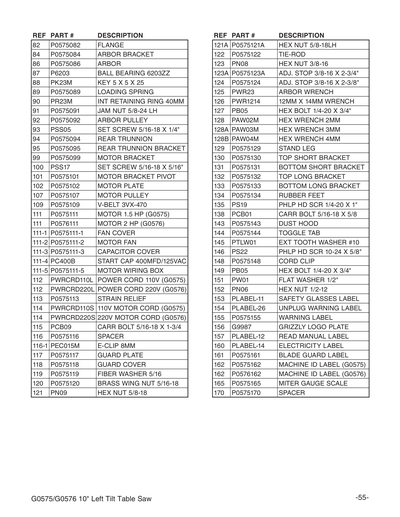

ARBOR NUT 5/8"-12
$8.65
82
FLANGE
83
BLADE OPTIONAL
84
*DISCD*ARBOR BRACKET
86
*DISCD*ARBOR
87
BALL BEARING 6203ZZ
88
Now: PK23M
KEY 5 X 5 X 25
89
LOADING SPRING 30 X 38 X .3
90
Now: PR23M
INT RETAINING RING 40MM
91
JAM NUT 5/8-24 LH
$1.60
92
ARBOR PULLEY
93
Now: PSS05
SET SCREW 5/16-18 X 1/4
94
TRUNNION REAR
$14.50
95
TRUNNION BRACKET REAR
$15.60
99
MOTOR BRACKET
$15.60
100
Now: PSS17
SET SCREW 5/16-18 X 5/16
MOTOR PLATE ROD
MOTOR PLATE
107
*DISCD*MOTOR PULLEY
109
V-BELT 3VX-470
111
MOTOR 1.5HP 110V/220V 1-PH
$481.00
111-1
FAN COVER
$17.55
111-2
MOTOR FAN
$15.80
111-3
CAPACITOR COVER
111-4
S CAPACITOR 400M 125V 2 X 3-1/2
111-5
MOTOR WIRING BOX
112
POWER CORD 16G X 3W 73"L
113
NYLON CLAMP
114
POWER CORD 16G X 3W 24"L
115
Now: PCB09
CARRIAGE BOLT 5/16-18 X 1-3/4
116
SPACER
116-1
E-CLIP 8MM
117
GUARD PLATE
$11.60
118
GUARD COVER
$10.65
119
FIBER WASHER 3/8 X 1
$1.49
120
Now: PWN03
WING NUT 5/16-18
121
Now: PN09
HEX NUT 5/8-18
121A
HEX NUT 5/8-18 LH
122
*DISCD*TIE ROD
123
Now: PN08
HEX NUT 3/8-16
123A
ADJUST STOP 3/8-16 X 2-3/4
124
ADJUST STOP 3/8-16 X 2-3/8
125
Now: PWR23
WRENCH 23MM COMBO
126
WRENCH 12 X 14MM OPEN-ENDS
127
Now: PB05
HEX BOLT 1/4-20 X 3/4
128
HEX WRENCH 2MM
128A
HEX WRENCH 3MM
128B
HEX WRENCH 4MM
129

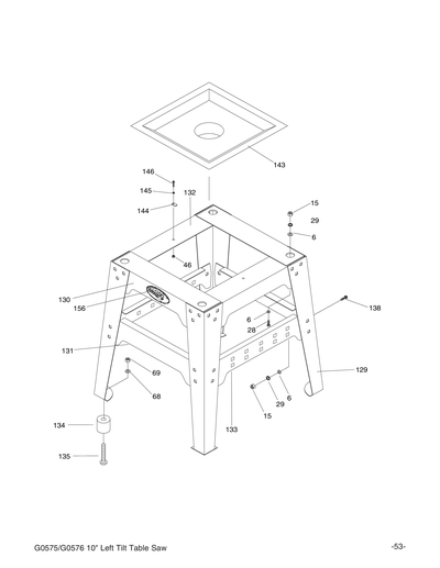

*DISCD*FOOT STAND
130
BRACKET TOP SHORT
131
BOTTOM SHORT BRACKET
132
BRACKET TOP LONG
133
BOTTOM LONG BRACKET
134
RUBBER FEET
135
Now: PS19
PHLP HD SCR 1/4-20 X 1
138
Now: PCB01
CARRIAGE BOLT 5/16-18 X 5/8
143
*DISCD*DUST HOOD
144
PLATE
145
EXT TOOTH WASHER #10
146
Now: PS22
PHLP HD SCR 10-24 X 5/8
148
CORD CLIP
$1.49
149
Now: PB05
151
Now: PW01
FLAT WASHER 1/2
152
Now: PN06
HEX NUT 1/2-12
153
154
DISCONNECT 110V 1.5W X 2.5H
155
WARNING LABEL
$4.25
156
Now: G9987
Nameplate - Mini
157
160
ELECTRICITY 1.4W X 1.2H
161
BLADE GUARD LABEL
162
MACHINE ID LABEL
165
MITER GAUGE SCALE
170
SPACER
$1.49
