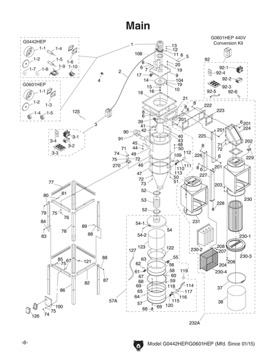

Parts for G0601HEP 5 HP 3-Phase Dual-Filtration HEPA Cyclone Dust Collector
Parts Diagrams for G0601HEP - 5 HP 3-Phase Dual-Filtration HEPA Cyclone Dust Collector
Parts List for Parts for G0601HEP 5 HP 3-Phase Dual-Filtration HEPA Cyclone Dust Collector

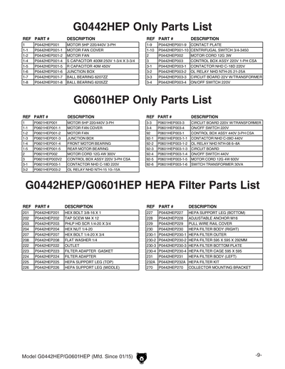

MOTOR 5HP 220/440V 3-PH
1-1
MOTOR FAN COVER
1-2
MOTOR FAN
1-3
JUNCTION BOX
1-4
FRONT MOTOR BEARING
1-5
REAR MOTOR BEARING
MOTOR CORD 12G 4W 300V
3-1
***USE P0441003V3-1***
3-2
OL RELAY NHD NTH-15 10-15A
3-3
CIRCUIT BOARD 220V W/TRANSFORMER
3-4
ON/OFF SWITCH 220V
3V2
CONTROL BOX ASSY 220V 3-PH CSA V2.04.12
REMOTE CONTROLLER
Now: PB16

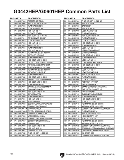

HEX BOLT 3/8-16 X 1-1/2
Now: PW02
FLAT WASHER 3/8
Now: PLW04
LOCK WASHER 3/8
Now: PN08
HEX NUT 3/8-16
BLOWER COVER
Now: PB55
HEX BOLT 1/2-13 X 1-1/2
Now: PWF04
FENDER WASHER 1/2
Now: PLW07
LOCK WASHER 1/2
Now: PN13
HEX NUT 1/2-13
IMPELLER 16"
Now: PW13
FLAT WASHER 3/4
HEX NUT 3/4-16 LH
FOAM TAPE 3 X 6 X 1800MM
IMPELLER HOUSING
Now: PW07
FLAT WASHER 5/16
Now: PB07
HEX BOLT 5/16-18 X 3/4
OUTLET GASKET 456 X 226MM
BAG CLAMP 545MM V2.11.09
Collection Bag 570 x 600mm
INTAKE CYLINDER 12"
Now: PW07
FLAT WASHER 5/16
Now: PB07
BARREL GASKET 686MM DIA.
Now: PB07
45
Now: PW07
FLAT WASHER 5/16
46
CYCLONE FUNNEL V2.08.10
47V2
CYCLONE FUNNEL V3.07.20
48
Now: PB03
HEX BOLT 5/16-18 X 1
49
INTAKE BARREL
49V2
INTAKE BARREL V2.07.20
50
Now: PW07
FLAT WASHER 5/16
51
Now: PN02
HEX NUT 5/16-18
52
HOSE CLAMP 9"
53
CLEAR FLEX PIPE 9" X 260MM
54
COLLECTION DRUM LID V2.08.06
54-1
DRUM LID HOOK
54-2
RIVET 4 X 7MM BLIND, STEEL
54V2
COLLECTION DRUM LID V2.07.20
55
DRUM SEAL TYPE-R 2M V2.11.09
56
UPPER DRUM 25GAL V1
56V2
UPPER DRUM 25GAL V2.07.20
57
COLLECTION DRUM 35GAL V2.08.10
57A
COLLCTON DRUM ASSY 55GAL V2.11.09
57AV2
COLLECTION DRUM ASSY 55GAL V2.07.20
57V2
COLLECTION DRUM 35GAL V2.07.20
58
DRUM CLAMP
59
Now: PB04
60
Now: PN02
HEX NUT 5/16-18
61
DRUM LID LATCH
62
Now: PS06
PHLP HD SCR 10-24 X 3/8
63
Now: PN07
HEX NUT 10-24
64
Now: PS06
65
Now: PN07
HEX NUT 10-24
66
CASTER 2"
67
Now: PN08
HEX NUT 3/8-16
68
Now: PLW04
LOCK WASHER 3/8
69
Now: PW02
FLAT WASHER 3/8
71
Now: PB03
72
Now: PW07
FLAT WASHER 5/16
73
***USE PLN03***
$1.49
74
Now: PB21
HEX BOLT 3/8-16 X 3/4
75
Now: PW02
FLAT WASHER 3/8
76
Now: PLN01
LOCK NUT 3/8-16
77
UPPER STAND BRACE
77V2
UPPER STAND BRACE V2.07.20
78
UPPER STAND LEG V2.08.10
78V2
UPPER STAND LEG V3.07.20
79
Now: PB21
80
Now: PW02
FLAT WASHER 3/8
81
Now: PLN01
LOCK NUT 3/8-16
82
LOWER BRACKET BRACE V2.03.12
82V2
LOWER BRACKET BRACE V2.7.20
83
Now: PB21
84
Now: PW02
FLAT WASHER 3/8
85
Now: PLN01
LOCK NUT 3/8-16
86
LOWER STAND LEG V2.08.10
86V2
LOWER STAND LEG V3.07.20
87
Now: PB21
88
Now: PW02
FLAT WASHER 3/8
89
Now: PLN01
LOCK NUT 3/8-16
90
REDUCER 10" TO 8"
91
TAP SCREW M4 X 12
92
CONTROL BOX ASSY 440V 3-PH CSA V3.03.18
92-1
CONTACTOR NHD C-09D 220V
92-2
OL RELAY NHD NTH-08 6-8A
92-3
***USE P0440003V3-3***
92-4
ON/OFF SWITCH 440V
92-5
MOTOR CORD 12G 4W 600V
92-6
TRANSFORMER SWITCH 30VA 440/460-220/230V
100
STAND SWITCH BRACKET CSA V2.03.12
100V2
STAND SWITCH BRACKET CSA V2.07.20
EXT TOOTH WASHER 1/2
108
***USE P0637006-1***
109
CYCLONE VACUUM TUBE
110
Now: PW07
FLAT WASHER 5/16
111
Now: PB07
112
TUBE PLUG 1-1/4"
113
FOAM TAPE 3 X 6 X 300MM
114
VACUUM HOSE 1-1/4" X 98"
115
COLLECTION DRUM VACUUM TUBE
116
Now: PW07
FLAT WASHER 5/16
117
Now: PB07
118
HOSE CLAMP 1-1/4"
119
TUBE PLUG 1-1/4"
120
121
VACUUM HOSE CLIP 2-1/2"
122
COLLECTION DRUM VACUUM RING
123
DRUM COLLECTION BAG 640 X 1200MM
125
GREEN GROUNDING WIRE 12G 6"
126
JUNCTION BOX
127
***USE P0638HEP158***
128
CYCLONE FUNNEL ADAPTER
129
HEX BOLT 3/8-16 X 11
130
DRUM LID CONNECTING PLATE
131
COLLECTION LID HANDLE
132
DRUM LID SPRING
133
***USE P0441099***
134
***USE P0441115***
135
Now: PS35
PHLP HD SCR 5/16-18 X 3/4
136
Now: PN40
ACORN NUT 5/16-18
137
COLLECTION DRUM HANDLE PLASTIC
138
Now: PCB05
CARRIAGE BOLT 5/16-18 X 3/4
139
HANDLE HOOK
140
HANDLE HOOK BRACKET
141
Now: PWF01
FENDER WASHER 5/16
142
FLAT WASHER 3/8 THIN
143
PRESSURE GAUGE W/MOUNTING BRACKET
144
AIR HOSE
145
STRAIN RELIEF TYPE-3 M16-2
146
***USE P0442HEP146***
$110.40
147
148
Now: PN07M
HEX NUT M3-.5
201
Now: PB18
HEX BOLT 3/8-16 X 1
202
TAP SCREW M4 X 12
203
Now: PS02
PHLP HD SCR 1/4-20 X 3/4
204
Now: PN05
HEX NUT 1/4-20
207
Now: PB05
HEX BOLT 1/4-20 X 3/4
208
Now: PW06
FLAT WASHER 1/4
222
OUTLET V1
222V2
OUTLET V2.07.20
223
FILTER ADAPTER GASKET
224
FILTER ADAPTER
225
HEPA SUPPORT LEG (TOP)
226
HEPA SUPPORT LEG (MIDDLE)
227
HEPA SUPPORT LEG (BOTTOM)
228
ADJUSTABLE ANCHOR M16
229
PULL WIRE RAIL COVER
230
HEPA FILTER BODY (RIGHT)
230-1
HEPA FILTER OUTER
230-2
HEPA Filter for G0441
230-3
HEPA FILTER BOTTOM PLATE
230-4
HEPA FILTER CAGE 595 X 595
231
HEPA FILTER BODY (LEFT)
232A
HEPA Filter Kit for G0442 Dust Collector
232AV2
***USE P0442HEP232AV2***
$3,990.50
270
COLLECTOR MOUNTING BRACKET V1
270V2
COLLECTOR MOUNTING BRACKET V2.07.20

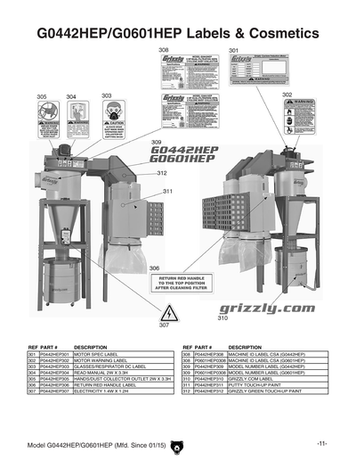

301
MOTOR SPEC LABEL
302
MOTOR WARNING LABEL
303
GLASSES/RESPIRATOR DC 2W X 3.3H
304
305
HANDS/DUST COLLECTOR OUTLET 2W X 3.3H
306
RETURN RED HANDLE LABEL
307
ELECTRICITY 1.4W X 1.2H
308
MACHINE ID LABEL CSA (G0601HEP)
309
MODEL NUMBER LABEL (G0601HEP)
310
GRIZZLY.COM LABEL
311
GREY PUTTY REF G0504
312
N/S GRIZZLY GREEN G1023S
MANUAL
MAN FOR G0442/G0601 MFD-11/09-7/10 V1.
