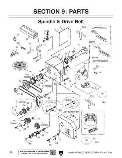

HEADSTOCK REAR COVER
Now: PS17M
PHLP HD SCR M4-.7 X 6
DEAD CENTER MT#4
BALL OILER 7MM PRESS-IN
CAP SCREW M6-1 X 25
Now: PW03M
FLAT WASHER 6MM
CLAMP
CAP SCREW M6-1 X 25
SPINDLE
KEY 10 X 10 X 55
SPACER
TAPERED ROLLER BEARING 32009
HEADSTOCK
CAP SCREW M8-1.25 X 20
CAP SCREW M6-1 X 20
SPACER
GEAR 40T PLASTIC
V-BELT M27.5 3L275
PULLEY C
Now: PVM33
V-BELT M33 3L330
SPANNER NUT 37MM
BRACKET PLATE
LOCK WASHER 10MM
Now: PN02M
HEX NUT M10-1.5
Now: PW04M
FLAT WASHER 10MM
CAP SCREW M5-.8 X 10
Now: PW02M
FLAT WASHER 5MM
GEAR SHAFT
TIMING BELT 263L
BALL BEARING 6001ZZ
TIMING PULLEY
Now: PR49M
INT RETAINING RING 12MM
SPACER
PULLEY A
Now: PK11M
KEY 6 X 6 X 40
SPACER
STANDOFF STUD M10-1.5 X 50, 15, 25
MOUNTING PLATE
Now: PW04M
FLAT WASHER 10MM
Now: PN02M
HEX NUT M10-1.5
TENSIONER ROLLER SHAFT
45
BALL BEARING 6001-2RS
46
TENSIONER ROLLER
Now: PR20M
INT RETAINING RING 28MM
48
Now: PR03M
EXT RETAINING RING 12MM
49
CHANGE GEAR COVER
51
Now: PN06M
HEX NUT M5-.8
52
SPINDLE COVER
53
Now: PS08M
PHLP HD SCR M5-.8 X 12
54
3-JAW CHUCK 5"
54-1
3-JAW CHUCK JAW INT 3-PC SET
54-2
CHUCK BACKPLATE
54-3
LATHE CHUCK KEY 9.75MM STD
54-4
3-JAW CHUCK JAW EXT 3-PC SET
55
4-JAW CHUCK 6.5"
55-1
4-JAW CHUCK JAWS 4-PC SET
55-2
4-JAW CHUCK KEY
55-3
4-JAW CHUCK BACKPLATE
56
FACEPLATE 8"
57
DEAD CENTER MT#3
60
TOOL BOX, EMPTY
62
HEX WRENCH SET (2.5,3,4,5,6MM)
63
WRENCH SET (8-10, 12-14, 17-19MM)
64
BOTTLE FOR OIL
66
SAFETY GLASSES 1.5W X 2.5H
69
STANDARD SCREWDRIVER #1
70
PHILLIPS SCREWDRIVER #1
71
SPINDLE CLAMP
72
CAP SCREW M6-1 X 20
73
CAP SCREW M6-1 X 25
74
FENDER WASHER 6MM
1001
MACHINE ID LABEL (G0602Z)
$16.40
1002
PINCH/ENTANGLEMENT 2.8W X 1.5H
1003
MODEL NUMBER LABEL
1004
ELECTRICITY 0.7W X 0.6H
1005
CARRIAGE FEED NOTICE LABEL
1006
SPINDLE SPEED HAZARD 1.5W X 2.5H
1007
IMPACT INJURY 1.5W X 2.5H
1008
DISCONNECT 110V 1.5W X 2.5H
1009
DO NOT CHANGE NOTICE LABEL

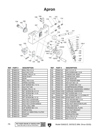

ROLL PIN 4 X 14
1010
ENTANGLEMENT HAZARD 1.5W X 2.5H
1011
FACE SHIELD & SAFETY GLASSES 2W X 3.3H
1012
READ MANUAL 1.5W X 2.5H
1013
N/S GRIZZLY GREEN G1023S
1014
GREY PUTTY REF G0504
HALF-NUT 2-PC
DOWEL PIN 5 X 12
GEAR SHAFT
GEAR
106
ROLL PIN 4 X 30
107
APRON CASTING
108
CAP SCREW M4-.7 X 12
109
HALF-NUT GIB
110
DOWEL PIN 4 X 16
111
SET SCREW M5-.8 X 16
112
SET SCREW M6-1 X 25
113
Now: PN06M
HEX NUT M5-.8
114
SET SCREW M6-1 X 12
115
HALF-NUT LEVER HUB
116
HALF-NUT LEVER STUD
117
HALF-NUT LEVER HANDLE
118
STEEL BALL 5MM
119
CAP SCREW M6-1 X 6
120
THREAD DIAL
121
122
POINTER
123
SHAFT
124
Now: PK39M
KEY 3 X 3 X 10
125
CAP SCREW M6-1 X 55
126
THREAD DIAL BODY
126A
THREAD DIAL ASSY
127
SIDE GEAR 48T
128
Now: PW01M
FLAT WASHER 8MM
129
Now: PN03M
HEX NUT M8-1.25
130
SET SCREW M6-1 X 6
131
COMPRESSION SPRING
132
HANDLE W/OUT SHAFT 10, 21 X 75
132-1
SHOULDER SCR M8-1.25 X 12, 10 X 66
133
CARRIAGE HANDWHEEL
134
SET SCREW M6-1 X 12
135
SET SCREW M6-1 X 12 CONE-PT
136
GEAR SHAFT
137
FLAT HD SCR M6-1 X 10
138
Now: PW03M
FLAT WASHER 6MM
139
HALF-NUT INDICATOR PLATE
140
LOCK CAM SHAFT
141
THREADED DIAL PLATE
142
HALF-NUT BRACKET
143
PLATE SPRING
144
GRADUATED DIAL
145
ROLL PIN 5 X 12
146
KEY 3 X 3 X 12

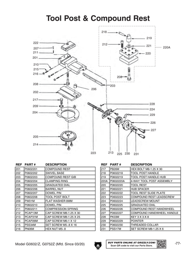

201
COMPOUND REST
202
SWIVEL BASE
203
COMPOUND REST GIB
204
CLAMPING RING
205
GRADUATED DIAL
206
BARREL NUT
207
DOWEL PIN
208
TOOL POST BOLT
209
Now: PW01M
FLAT WASHER 8MM
210
DOWEL PIN
211
COMPRESSION SPRING
212
BULLNOSE CAP SCR M8-1.25 X 29
213
CAP SCREW M6-1 X 25
214
CAP SCREW M6-1 X 12
215
216
Now: PN06M
HEX NUT M5-.8
217
Now: PB26M
HEX BOLT M8-1.25 X 30
218
TOOL POST HANDLE
219
TOOL POST HANDLE HUB
220
TOOL REST
220A
4-WAY TOOL POST ASSEMBLY
221
HUB SPACER
222
TOOL REST SLIDE PLATE
223
COMPOUND REST LEADSCREW
224
LEADSCREW MOUNT
225
GRADUATED DIAL
226
COMPOUND REST HANDWHEEL
227
COMPOUND HANDWHEEL HANDLE
228
Now: PK03M
KEY 3 X 3 X 8
229
POINTER
230
THREADED COLLAR
231
SET SCREW M8-1.25 X 6
232
Now: PN03M
HEX NUT M8-1.25

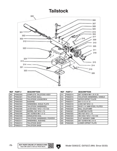

300
COMPLETE TAILSTOCK ASSY
301
TAILSTOCK QUILL
302
TAILSTOCK LEADSCREW
303
BUSHING
304
HANDWHEEL SCALE PLATE
305
TAILSTOCK HANDWHEEL
306
LEVER BOLT M12-1.75 X 50
307
Now: PW06M
FLAT WASHER 12MM
308
SET SCREW M6-1 X 12
309
GRADUATED DIAL
310
TAILSTOCK HANDWHEEL POINTER
311
***USE PW06M***
312
TAILSTOCK BODY
313
TAILSTOCK BASE
314
SET SCREW M8-1.25 X 25
315
316
UPPER OFFSET PLATE
317
Now: PK39M
KEY 3 X 3 X 10
318
LOCK NUT M10-1.5
319
320
BALL OILER 10MM PRESS-IN
321
CLAMPING PLATE
322
Now: PN09M
HEX NUT M12-1.75
323
HEX BOLT M12-1.75 X 90
324
Now: PW06M
FLAT WASHER 12MM
325
SET SCREW M5-.8 X 6
326
LOWER OFFSET PLATE

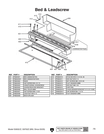

401
BED
402
RACK V2
403
CAP SCREW M5-.8 X 12
404
LONGITUDINAL LEADSCREW
405
LEADSCREW END BRACKET
406
BALL OILER 6MM PRESS-IN
407
CAP SCREW M6-1 X 20
408
LOCK NUT M10-1.5
409
BACK SPLASH
410
STUD-SE M10-1.5 X 45, 35
411
Now: PN02M
HEX NUT M10-1.5
412
SET SCREW M8-1.25 X 40
413
Now: PW01M
FLAT WASHER 8MM
414
Now: PN03M
HEX NUT M8-1.25
415
CHIP PAN
416
SENSOR BRACKET
$111.45
417
CAP SCREW M4-.7 X 10
418
Now: PW05M
FLAT WASHER 4MM

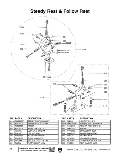

501
STEADY REST CASTING
501A
STEADY REST ASSEMBLY
502
FINGER
503
SHOULDER T-BOLT
504
LOCK WASHER 6MM
505
Now: PN01M
HEX NUT M6-1
506
ADJUSTING SCREW
507
CLAMPING PLATE
508
HEX BOLT M12-1.75 X 65
509
Now: PW04M
FLAT WASHER 10MM
510
Now: PN02M
HEX NUT M10-1.5
511
FOLLOW REST CASTING
511A
FOLLOW REST ASSEMBLY
512
FINGER
513
SHOULDER T-BOLT
514
ADJUSTING SCREW
515
Now: PN01M
HEX NUT M6-1
516
LOCK WASHER 6MM
517
CAP SCREW M8-1.25 X 35
518
Now: PW01M
FLAT WASHER 8MM

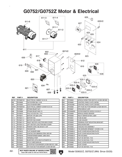

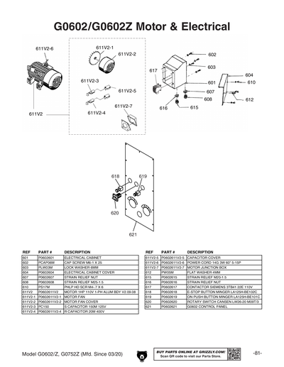

601
ELECTRICAL CABINET
602
CAP SCREW M6-1 X 25
603
LOCK WASHER 6MM
604
ELECTRICAL CABINET COVER
607
STRAIN RELIEF TYPE-3 M18-1.5 ST
608
STRAIN RELIEF TYPE-3 M24 - 1.5 ST
610
Now: PS17M
611
MOTOR 1HP 110V 1-PH ALUM BDY V2.09.08
611-1
MOTOR FAN V2.09.08
611-2
MOTOR FAN COVER V2.09.08
611-3
Now: PC150
S CAPACITOR 150M 125V 1-5/16 X 2-3/4
611-4
Now: PC20C
R CAPACITOR 20M 450V V2.09.08
611-6
POWER CORD 14G 3W 60" 5-15P
611-7
MOTOR JUNCTION BOX
612
Now: PW05M
FLAT WASHER 4MM
615
STRAIN RELIEF M20-1.5
617
CONTACTOR SIEMENS 3TB41 22E 110V V1
618
E-STOP BUTTON MINGER LA125H-BE102C
619
ON PUSH BUTTON MINGER LA125H-BE101C
620
ROTARY SWITCH CANSEN LW26-20 M09T/3
621
CONTROL PANEL FOR G0602Z
$40.25

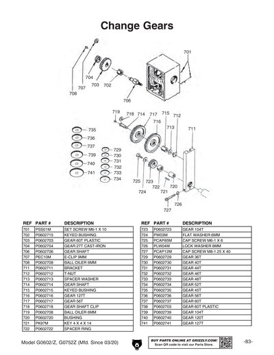

706
GEAR SHAFT
707
E-CLIP 9MM
708
711
BRACKET
712
T-NUT
713
SPACER WASHER
714
GEAR SHAFT
715
KEYED BUSHING
716
GEAR 127T
717
GEAR 56T
718
GEAR SHAFT CLIP
719
720
BUSHING
721
Now: PK97M
KEY 4 X 4 X 14
722
SPACER RING
723
GEAR 104T
724
Now: PW03M
FLAT WASHER 6MM
725
CAP SCREW M6-1 X 6
726
LOCK WASHER 8MM
727
CAP SCREW M8-1.25 X 40
728
GEAR 36T
729
GEAR 36T
730
GEAR 40T
731
GEAR 44T
732
GEAR 46T
733
GEAR 48T
734
GEAR 52T
735
GEAR 45T
736
GEAR 56T
737
GEAR 60T
738
GEAR 60T PLASTIC
739
GEAR 104T
740
GEAR 120T
741
GEAR 127T

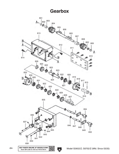

801
PLUG
802
***USE P0602846***
803
BUSHING
804
CLUSTER GEAR 30/36/33T
805
KEY 4 X 4 X 50
806
GEAR SHAFT
807
BUSHING
808
CLUSTER GEAR 22/44/33T
809
CLUSTER GEAR PLUG
810
811
REAR GEARBOX COVER
812
FILL PLUG 3/8" NPT
813
GEAR BOX CASE
814
DRAIN PLUG 3/8" NPT
815
SHEAR PIN 5 X 20
816
LEADSCREW CONNECTING COLLAR
817
***USE P0602815***
818
CAP SCREW M6-1 X 12
819
FLANGE
820
BALL BEARING 6202-OPEN
821
GEAR 33T
822
Now: PR05M
EXT RETAINING RING 15MM
823
Now: PK65M
KEY 4 X 4 X 8
824
GEAR SHAFT 22T
825
GEAR 44T
826
COLLAR
827
KEY 8 X 7 X 40
828
GEAR SHAFT
829
GEAR 33T
830
GEAR 30T
831
GEAR 35T
832
FLANGE
833
CAP SCREW M6-1 X 16
834
SHIFT FORK
835
FRONT GEARBOX COVER
836
ROLL PIN 5 X 30
837
COMPRESSION SPRING
838
SIGHT GLASS A16
839
POINTER DISC
840
SET SCREW M6-1 X 10
841
STEEL BALL 5MM
842
SHIFT HUB
843
SET SCREW M6-1 X 10
844
CAP SCREW M6-1 X 50
845
CAP SCREW M6-1 X 20
846
O-RING 1.8 X 6.7
847
SHAFT
848
ROLL PIN 5 X 20
849
SHIFT LEVER
850
SHIFT FORK
855

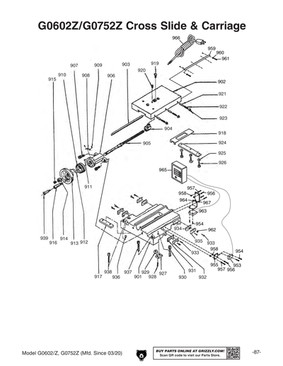

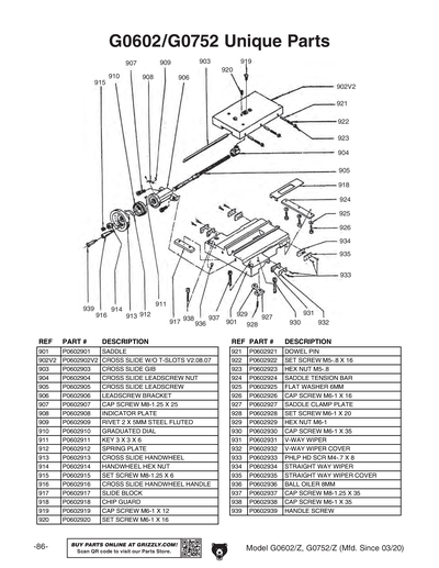

901
SADDLE
902
CROSS SLIDE
$151.60
903
CROSS SLIDE GIB
904
CROSS SLIDE LEADSCREW NUT
905
906
LEADSCREW BRACKET
907
CAP SCREW M8-1.25 X 25
908
INDICATOR PLATE
909
910
GRADUATED DIAL
911
KEY 3 X 3 X 6
912
SPRING PLATE
913
CROSS SLIDE HANDWHEEL

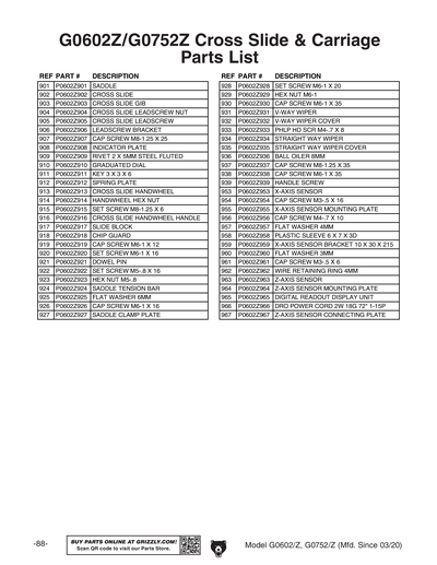

914
HANDWHEEL HEX NUT
915
916
CROSS SLIDE HANDWHEEL HANDLE
917
SLIDE BLOCK
918
CHIP GUARD
919
CAP SCREW M6-1 X 12
920
SET SCREW M6-1 X 16
921
DOWEL PIN
922
923
Now: PN06M
HEX NUT M5-.8
924
SADDLE TENSION BAR
925
Now: PW03M
FLAT WASHER 6MM
926
CAP SCREW M6-1 X 16
927
SADDLE CLAMP PLATE
928
SET SCREW M6-1 X 20
929
Now: PN01M
HEX NUT M6-1
930
CAP SCREW M6-1 X 35
931
V-WAY WIPER
932
V-WAY WIPER COVER
933
Now: PS07M
PHLP HD SCR M4-.7 X 8
934
STRAIGHT WAY WIPER
935
STRAIGHT WAY WIPER COVER
936
BALL OILER 8MM PRESS-IN
937
938
CAP SCREW M6-1 X 35
939

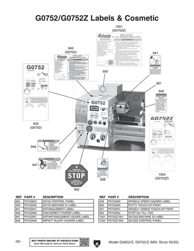

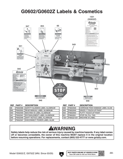

***USE P0602132-1***
941
946
SHIFT NOTICE LABEL
947
948
CARRIAGE FEED DAMAGE LABEL
949
950
951
STOP OIL FILL TAG
952V2
SPANNER WRENCH V2.03.20 (G0602)
953
X-AXIS SENSOR
$107.00
954
CAP SCREW M3-.5 X 16
955
X-AXIS SENSOR MOUNTING PLATE
$18.00
956
957
Now: PW05M
FLAT WASHER 4MM
958
PLASTIC SLEEVE 6 X 7 X 3D
$1.90
959
X-AXIS SENSOR BRACKET 10 X 30 X 215
$55.75
960
Now: PW07M
FLAT WASHER 3MM
961
CAP SCREW M3-.5 X 6
962
WIRE RETAINING RING 4MM
$2.25
963
Z-AXIS SENSOR
$107.00
964
Z-AXIS SENSOR MOUNTING PLATE
$17.45
965
DIGITAL READOUT DISPLAY UNIT
$423.40
966
DRO POWER CORD 2W 18G 72" 115P
$55.75
967
Z-AXIS SENSOR CONNECTING PLATE
$18.00
968
Now: PW01M
FLAT WASHER 8MM
969
THRUST BEARING 51100
