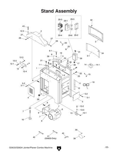

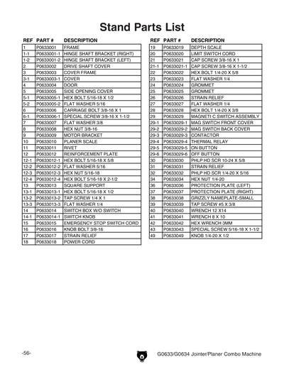

FRAME
1-1
HINGE SHAFT BRACKET RIGHT
1-2
HINGE SHAFT BRACKET LEFT
DRIVE SHAFT COVER
COVER FRAME
3-1
COVER
DOOR
SIDE OPENING COVER
5-1
Now: PB09
HEX BOLT 5/16-18 X 1/2
5-2
Now: PW07
FLAT WASHER 5/16
Now: PCB22
CARRIAGE BOLT 3/8-16 X 1
6-1
PLATE SCREW 3/8-16 X 2
Now: PW02
FLAT WASHER 3/8
Now: PN08
HEX NUT 3/8-16
MOTOR BRACKET
PLANER SCALE
REINFORCEMENT PLATE
12-1
Now: PB32
HEX BOLT 5/16-18 X 5/8
12-2
Now: PW07
FLAT WASHER 5/16
12-3
Now: PN02
HEX NUT 5/16-18
12-4
Now: PB17
HEX BOLT 5/16-18 X 2-3/4
SQUARE SUPPORT
13-1
Now: PB09
13-2
TAP SCREW 1/4 X 1
13-3
Now: PW06
FLAT WASHER 1/4
SWITCH BOX W/O SWITCH
14-1
SWITCH KNOB
EMERGENCY STOP SWITCH CORD
KNOB BOLT 3/8-16
STRAIN RELIEF 3/4"
POWER CORD
DEPTH SCALE
LIMIT SWITCH CORD
CAP SCREW 3/8-16 X 1
21-1
CAP SCREW 3/8-16 X 1-1/2
Now: PB02
HEX BOLT 1/4-20 X 5/8
Now: PW06
FLAT WASHER 1/4
GROMMET
GROMMET
STRAIN RELIEF 3/4"
Now: PW06
FLAT WASHER 1/4
Now: PB51
HEX BOLT 1/4-20 X 3/8
MAGNETIC SWITCH ASSY SDE MP-18
29-1
MAG SWITCH FRONT COVER
29-2
MAG SWITCH BACK COVER
29-3
CONTACTOR
29-4
OL RELAY SDE RA-30 18-26A
29-5
ON BUTTON
29-6
OFF BUTTON
Now: PS22
PHLP HD SCR 10-24 X 5/8
STRAIN RELIEF M16 TYPE-6 ST
Now: PS103
PHLP HD SCR 1/4-20 X 5/16
Now: PN05
HEX NUT 1/4-20
PROTECTION PLATE LEFT
PROTECTION PLATE RIGHT
Now: G8588
Nameplate - Small
TAP SCREW #5 X 3/8
WRENCH 12 X 14MM OPEN-ENDS
HEX WRENCH 3MM
COVER SCREW 5/16-18 X 1-1/2
49
*DISCD*KNOB 1/4-20 X 1/2

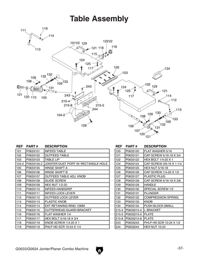

INFEED TABLE V1.05.07
101V2
INFEED TABLE V2.03.08
OUTFEED TABLE
TABLE LIP
104-1
*DISCD*PLANER DUST PORT/2 SMALL HOLES V1
104-1A
PLANER DUST PORT V2.09.07
104-2
JOINTER DUST PORT/RECTANGLE HOLE
HINGE SHAFT A
106
HINGE SHAFT B
107
OUTFEED TABLE ADJ KNOB
108
GUIDE SCREW
109
Now: PN01
HEX NUT 1/2-20
110
INFEED HANDGRIP
111
INFEED LOCK LEVER
112
OUTFEED LOCK LEVER
113
PLASTIC KNOB
114
Now: PR03M
EXT RETAINING RING 12MM
115
CUTTERHEAD GUARD BRACKET V1
116
Now: PW06
FLAT WASHER 1/4
117
Now: PB07
HEX BOLT 5/16-18 X 3/4
118
KNOB SCREW 1/4-20 X 1/2
119
Now: PS18
PHLP HD SCR 10-24 X 1/4
120
Now: PW07
FLAT WASHER 5/16
121
CAP SCREW 5/16-18 X 3/4
122
Now: PB31
HEX BOLT 1/4-20 X 1
122V2
Now: PB03
124
CAP SCREW 3/8-16 X 1-1/4
125
Now: PN02
HEX NUT 5/16-18
126
CAP SCREW 1/4-20 X 1/2
127
*DISCD*PLASTIC PLUG
128
CAP SCREW 5/16-18 X 3/8
129
HANDLE
130
PLUNGER SCREW 1/2
131
PLUNGER
132
COMPRESSION SPRING
133
KNOB
134
Now: W1400

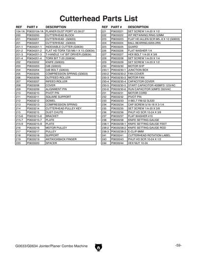

Safety Push Block - Small

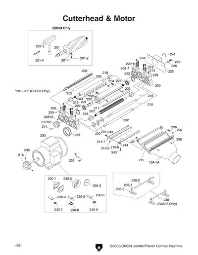

200
CUTTERHEAD BLOCK
201
SPIRAL CUTTERHEAD 12"
$899.95
201-1
Now: H7319
Indexable Carbide Inserts - 14 x 14 x 2mm, 10-Pk.
201-2
FLAT HD TORX T20 M6-1 X 15
201-3
T-HANDLE 1/4" BIT DRIVER
201-4
*DISCD*TORX BIT T-20
202
*DISCD*KNIFE
203
*DISCD*GIB
204
GIB BOLT
205
COMPRESSION SPRING
206
OUTFEED ROLLER
207
INFEED ROLLER
208
COVER V1
209
ALIGNMENT PIN
210
PIVOT PIN
211
SQUARE SUPPORT
212
DOWEL
213
COMPRESSION SPRING
214
KEY 5 X 5 X 30
215
DUST CHUTE
215-4
L BRACKET
215-5
PLATE
215-6
BRACKET
215-7
PLATE
215-8
JDP PLASTIC PLATE
215-9
PDF PLASTIC PLATE
216
MOTOR PULLEY
217
PULLEY STANDARD V1.05.07
218
SUPPORT
219
ANTI KICKBACK FINGER
220
SPACER
221
Now: PSS07
SET SCREW 1/4-20 X 1/2
222
Now: PR26M
INT RETAINING RING 52MM
224
BALL BEARING 6205-2RS
225
GUARD
226
Now: PW06
FLAT WASHER 1/4
227
Now: PB51
228
Now: PSS11
SET SCREW 1/4-20 X 1/4
228V2
SET SCREW M5-.8 X 4 V2.01.08
229
Now: PSS07
230
MOTOR 5HP 220V 1-PH
230-1
JUNCTION BOX
230-2
FAN COVER
230-3
MOTOR FAN
230-4
CAPACITOR COVER
230-5
S CAPACITOR 400M 125V 1-3/8 X 3-1/8
230-6
R CAPACITOR 50M 350V 2 X 3-1/2
230-7
CENTRIFUGAL SWITCH 3450
230-8
CONTACT PLATE
230-9
MOTOR BEARING
231
MOTOR CORD
232
PIVOT PIN
233
Now: PVM52
V-BELT M52 3L520
234
CAP SCREW 5/16-18 X 3-1/4
235
Now: PSS03
SET SCREW 1/4-20 X 3/8
236
Now: PS06
PHLP HD SCR 10-24 X 3/8
237
Now: PW03
FLAT WASHER #10
241
CUTTERHEAD ROTATION LABEL
242
Now: PS06
243
Now: PFS17
FLANGE SCREW 10-24 X 1/2
244
Now: PN07
HEX NUT 10-24

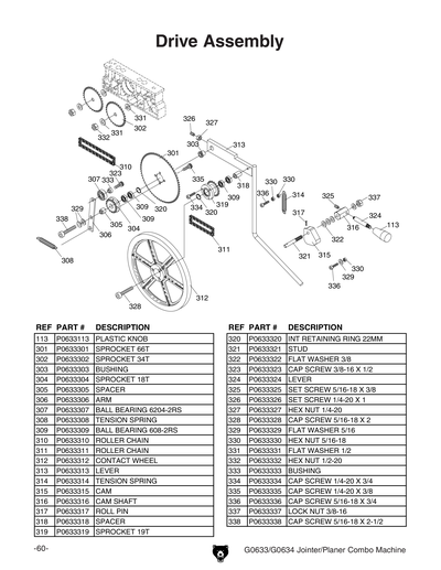

301
SPROCKET 66T
302
SPROCKET 34T
303
BUSHING
304
SPROCKET 18T
305
SPACER
306
ARM
307
BALL BEARING 6204-2RS
308
TENSION SPRING
309
BALL BEARING 608-2RS
310
ROLLER CHAIN
311
ROLLER CHAIN
312
CONTACT WHEEL
313
LEVER
314
TENSION SPRING
315
CAM
316
CAM SHAFT
317
ROLL PIN
318
*DISCD*SPACER
319
SPROCKET 19T
320
Now: PR57M
INT RETAINING RING 22MM
321
SPRING STUD
322
Now: PW02
FLAT WASHER 3/8
323
CAP SCREW 3/8-16 X 1/2
324
LEVER
325
Now: PSS02
SET SCREW 5/16-18 X 3/8
326
Now: PSS12
327
Now: PN05
HEX NUT 1/4-20
328
CAP SCREW 5/16-18 X 2
329
Now: PW07
FLAT WASHER 5/16
330
Now: PN02
HEX NUT 5/16-18
331
Now: PW01
FLAT WASHER 1/2
332
Now: PN01
HEX NUT 1/2-20
333
BUSHING
334
CAP SCREW 1/4-20 X 3/4
335
CAP SCREW 1/4-20 X 3/8
336
337
Now: PLN01
LOCK NUT 3/8-16
338
CAP SCREW 5/16-18 X 2-1/2

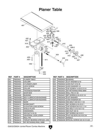

401
PLANER TABLE
402
COLUMN
403
CYLINDER LINER
404
LOCK SCREW
405
COLLAR
406
THICKNESS POINTER
407
GEAR BOX
408
BUSHING
408-1
SELF LUBRICATING SHLDR BUSHING
408-2
SELF LUBRICATION BUSHING
409
GEAR
410
WORM SHAFT
411
ELEVATION LEAD SCREW
412
SHIELD PLATE
413
HANDWHEEL
414
Now: PN02
HEX NUT 5/16-18
415
UNIVERSAL LOCK LEVER
417
ROLL PIN
418
THRUST BEARING NTB1528 +2AS
419
Now: PR79M
INT RETAINING RING 19MM
420
BUSHING
421
Now: PW07
FLAT WASHER 5/16
422
Now: PLN03
LOCK NUT 5/16-18
423
Now: PLW02
LOCK WASHER 1/4
424
CAP SCREW 1/4-20 X 2-1/4
425
Now: PR88M
INT RETAINING RING 8MM
426
ROLL PIN 5 X 30
427
Now: PSS05
SET SCREW 5/16-18 X 1/4
428
FLAT WASHER
429
Now: PLW04
LOCK WASHER 3/8
430
Now: PB16
HEX BOLT 3/8-16 X 1-1/2
431
Now: PSS01
432
433
Now: PB09
434
Now: PN08
HEX NUT 3/8-16
435
Now: PSS36
SET SCREW 3/8-16 X 2
436
Now: PS35
PHLP HD SCR 5/16-18 X 3/4
437
HANDLE
438
HANDLE SCREW 3/8-16 X 3-3/8

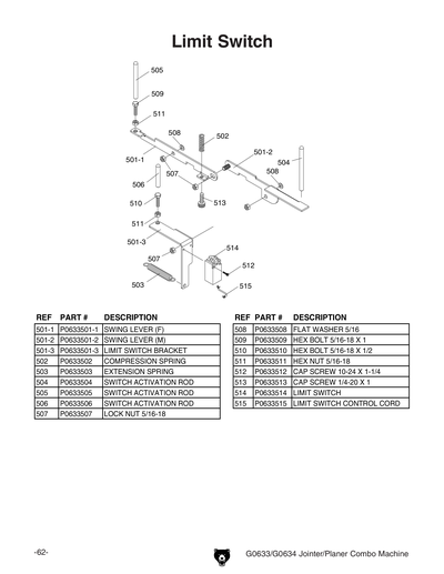

501-1
SWING LEVER F
501-2
SWING LEVER M
501-3
LIMIT SWITCH BRACKET
502
COMPRESSION SPRING
503
TENSION SPRING
504
SWITCH ACTIVATION ROD #1
505
SWITCH ACTIVATION ROD #2
506
SWITCH ACTIVATION ROD #3
507
Now: PLN03
LOCK NUT 5/16-18
508
Now: PW07
FLAT WASHER 5/16
509
Now: PB03
510
Now: PB09
511
Now: PN02
HEX NUT 5/16-18
512
CAP SCREW 10-24 X 1-1/4
513
514
*DISCD*LIMIT SWITCH
515
LIMIT SWITCH CONTROL CORD

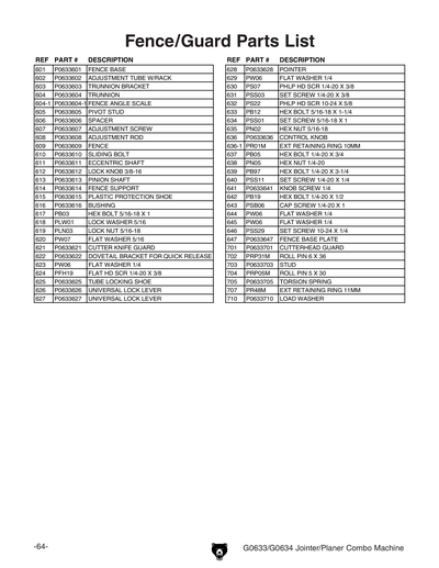

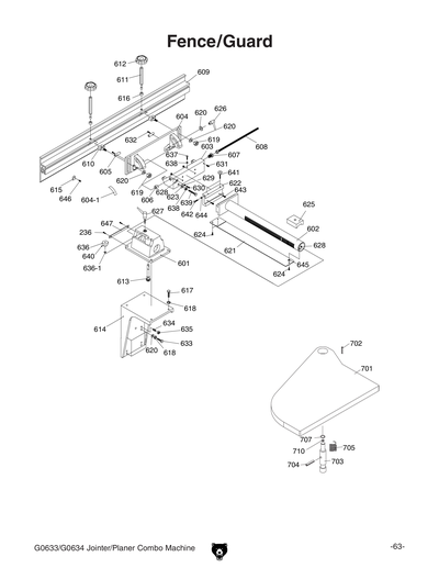

601
FENCE BASE
602
ADJUSTMENT TUBE W/RACK
603
TRUNNION BRACKET
604
TRUNNION
604-1
FENCE ANGLE SCALE
605
PIVOT STUD
606
SPACER
607
ADJUSTMENT SCREW
608
ADJUSTMENT ROD
609
FENCE
610
SLIDING BOLT
611
ECCENTRIC SHAFT
612
LOCK KNOB 3/8"-16
613
PINION SHAFT
614
FENCE SUPPORT
615
PLASTIC PROTECTION SHOE
616
BUSHING
617
Now: PB03
618
Now: PLW01
LOCK WASHER 5/16
619
Now: PLN03
LOCK NUT 5/16-18
620
Now: PW07
FLAT WASHER 5/16
621
CUTTER KNIFE GUARD
622
DOVETAIL BRACKET FOR QUICK RELEASE
623
Now: PW06
FLAT WASHER 1/4
624
Now: PFH18
FLAT HD CAP SCR 1/4-20 X 1/4
625
TUBE LOCKING SHOE
626
627
628
POINTER
629
Now: PW06
FLAT WASHER 1/4
630
Now: PS07
PHLP HD SCR 1/4-20 X 3/8
631
Now: PSS03
632
Now: PS22
633
Now: PB12
HEX BOLT 5/16-18 X 1-1/4
634
Now: PSS01
635
Now: PN02
HEX NUT 5/16-18
636
CONTROL KNOB
636-1
Now: PR01M
EXT RETAINING RING 10MM
637
Now: PB05
HEX BOLT 1/4-20 X 3/4
638
Now: PN05
HEX NUT 1/4-20
639
Now: PB97
HEX BOLT 1/4-20 X 3-1/4
640
Now: PSS11
641
KNOB SCREW 1/4
642
Now: PB19
HEX BOLT 1/4-20 X 1/2
643
644
Now: PW06
FLAT WASHER 1/4
645
Now: PW03M
FLAT WASHER 6MM
646
Now: PSS29
SET SCREW 10-24 X 1/4
647
FENCE BASE PLATE
701
CUTTERHEAD GUARD
702
ROLL PIN 6 X 36
703
GUARD TORSION PIN
704
ROLL PIN 5 X 35
705
TORSION SPRING
707
Now: PR48M
EXT RETAINING RING 11MM
710
WAVY WASHER 12MM

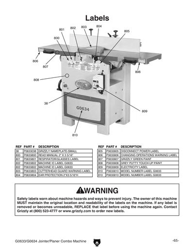

800
801
GLASSES/RESPIRATOR 2W X 3.3H
802
MACHINE ID LABEL
803
CUTTERHEAD GUARD WARNING LABEL
804
EAR PROTECTION 2W X 3.3H V2.04.08
805
DISCONNECT POWER LABEL
806
CHANGING OPERATIONS WARNING LABEL
807
N/S GRIZZLY GREEN G1023S
808
GREY PUTTY REF G0504
809
ELECTRICITY 1.4W X 1.2H
810
MODEL NUMBER LABEL
$16.40
812
CHANGE LEVER NOTICE
