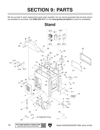

FRAME
1-1
HINGE SHAFT BRACKET RIGHT
1-2
HINGE SHAFT BRACKET LEFT
DRIVE SHAFT COVER
COVER FRAME
3-1
COVER
DOOR
SIDE OPENING COVER
5-1
Now: PB09
HEX BOLT 5/16-18 X 1/2
5-2
Now: PW07
FLAT WASHER 5/16
Now: PCB22
CARRIAGE BOLT 3/8-16 X 1
6-1
PLATE SCREW 3/8-16 X 2
Now: PW02
FLAT WASHER 3/8
Now: PN08
HEX NUT 3/8-16
MOTOR BRACKET
PLANER SCALE
REINFORCEMENT PLATE
12-1
Now: PB32
HEX BOLT 5/16-18 X 5/8
12-2
Now: PW07
FLAT WASHER 5/16
12-3
Now: PN02
HEX NUT 5/16-18
12-4
Now: PB23
HEX BOLT 5/16-18 X 2-1/2
SQUARE SUPPORT
13-1
Now: PB09
13-2
TAP SCREW 1/4 X 1
13-3
Now: PW06
FLAT WASHER 1/4
SWITCH BOX W/O SWITCH
14-1
SWITCH KNOB
EMERGENCY STOP SWITCH CORD
KNOB BOLT 3/8-16
STRAIN RELIEF 3/4"
POWER CORD
DEPTH SCALE
LIMIT SWITCH CORD
CAP SCREW 3/8-16 X 1
21-1
CAP SCREW 3/8-16 X 1-1/2
Now: PB02
HEX BOLT 1/4-20 X 5/8
Now: PW06
FLAT WASHER 1/4
GROMMET
GROMMET
*DISCD*STRAIN RELIEF TYPE-3 M22-1.5
Now: PW06
FLAT WASHER 1/4
Now: PB51
HEX BOLT 1/4-20 X 3/8
MAGNETIC SWITCH ASSY SDE MP-18
29-1
MAG SWITCH FRONT COVER
29-2
MAG SWITCH BACK COVER
29-3
CONTACTOR
29-4
OL RELAY SDE RA-30 18-26A
29-5
ON BUTTON
29-6
OFF BUTTON
Now: PS22
PHLP HD SCR 10-24 X 5/8
STRAIN RELIEF M16 TYPE-6 ST
Now: PS103
PHLP HD SCR 1/4-20 X 5/16
Now: PN05
HEX NUT 1/4-20
POINTER
35-1
Now: PS18
PHLP HD SCR 10-24 X 1/4
PROTECTION PLATE LEFT
PROTECTION PLATE RIGHT
Now: G8588
Nameplate - Small
TAP SCREW #5 X 3/8
WRENCH 12 X 14MM OPEN-ENDS
WRENCH 8 X 10MM OPEN-ENDS
HEX WRENCH 3MM
COVER SCREW 5/16-18 X 1-1/2
49
*DISCD*KNOB 1/4-20 X 1/2
51
CABLE CLAMP
52
Now: PN07
HEX NUT 10-24

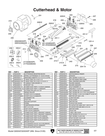

200
CUTTERHEAD BLOCK
201
SPIRAL CUTTERHEAD 12" 10-32 V1
$1,409.80
201-1
15 x 15 x 2.5mm Replacement Carbide Inserts
201-1V2
201-2
FLAT HD TORX T25 10-32 X 1/2 V1.09.09
$1.60
201-2V2
*DISCD*T-HEAD TORX T25 10-32 X 1/2 V2.01.11
201-3
WRENCH T-HANDLE TORX 1/4
$7.25
201-4
***USE PBT02***
$1.75
201-4V2
Now: PBT02
TORX BIT T-25
201V2
204-1A
PLANER DUST PORT V2.09.07
206
OUTFEED ROLLER V2.01.20
206V2
$68.25
207
INFEED ROLLER
208
COVER V1
208V2
COVER V2.04.16
209
ALIGNMENT PIN
210
PIVOT PIN
211
SQUARE SUPPORT
212
DOWEL
213
COMPRESSION SPRING
214
Now: PK12M
KEY 5 X 5 X 30
215
DUST CHUTE
215-4
L BRACKET
215-5
PLATE
215-6
BRACKET
215-7
PLATE
215-8
JDP PLASTIC PLATE
215-9
PDF PLASTIC PLATE
216
MOTOR PULLEY
217
PULLEY STANDARD V1.05.07
217V2
PULLEY METRIC V2.01.08
218
SUPPORT
219
ANTI KICKBACK FINGER
220
SPACER
221
Now: PSS07
SET SCREW 1/4-20 X 1/2
222
Now: PR26M
INT RETAINING RING 52MM
224
BALL BEARING 6205-2RS
225
GUARD
226
Now: PW06
FLAT WASHER 1/4
227
Now: PB51
228
Now: PSS11
SET SCREW 1/4-20 X 1/4
228V2
SET SCREW M5-.8 X 4
229
Now: PSS07
229V2
SET SCREW 1/4-20 X 3/4 CONE-PT
230
MOTOR 5HP 220V 1-PH
230-1
JUNCTION BOX
230-2
FAN COVER
230-3
MOTOR FAN
230-4
CAPACITOR COVER
230-5
S CAPACITOR 400M 125V 1-3/8 X 3-1/8
230-6
R CAPACITOR 50M 350V 2 X 3-1/2
231
MOTOR CORD
232
PIVOT PIN
233
Now: PVM52
V-BELT M52 3L520
234
CAP SCREW 5/16-18 X 3-1/4
235
Now: PSS03
SET SCREW 1/4-20 X 3/8
236
Now: PS06
PHLP HD SCR 10-24 X 3/8
237
Now: PW03
FLAT WASHER #10
239
SET SCREW M5-.8 X 6
241
CUTTERHEAD ROTATION LABEL
243
Now: PFS17
FLANGE SCREW 10-24 X 1/2
244
Now: PN07
HEX NUT 10-24

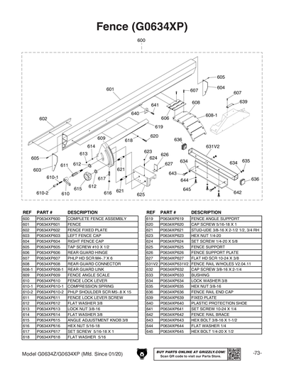

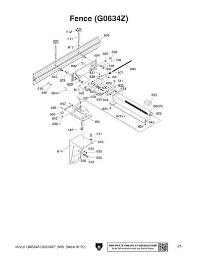

601
FENCE BASE
602
ADJUSTMENT TUBE W/RACK
602V2
ADJUSTMENT TUBE W/RACK V2.08.16
603
TRUNNION BRACKET
604
TRUNNION
604-1
FENCE ANGLE SCALE
605
PIVOT STUD
606
SPACER
607
ADJUSTMENT SCREW
608
ADJUSTMENT ROD
609
FENCE
610
SLIDING BOLT
611
ECCENTRIC SHAFT
612
LOCK KNOB 3/8"-16
613
PINION SHAFT
614
FENCE SUPPORT
615
PLASTIC PROTECTION SHOE
616
BUSHING
617
Now: PB03
618
Now: PLW01
LOCK WASHER 5/16
619
Now: PLN03
LOCK NUT 5/16-18
620
Now: PW07
FLAT WASHER 5/16
621
CUTTER KNIFE GUARD
621V2
CUTTER KNIFE GUARD V2.08.16
622
DOVETAIL BRACKET FOR QUICK RELEASE
623
Now: PW06
FLAT WASHER 1/4
624
Now: PFH19
FLAT HD SCR 1/4-20 X 3/8
625
TUBE LOCKING SHOE
626
UNIVERSAL LOCK LEVER
627
628
POINTER
629
Now: PW06
FLAT WASHER 1/4
630
Now: PS07
PHLP HD SCR 1/4-20 X 3/8
631
Now: PSS03
632
Now: PS22
633
Now: PB12
HEX BOLT 5/16-18 X 1-1/4
634
Now: PSS01
SET SCREW 5/16-18 X 1
635
Now: PN02
HEX NUT 5/16-18
636
CONTROL KNOB
636-1
Now: PR01M
EXT RETAINING RING 10MM
637
Now: PB05
HEX BOLT 1/4-20 X 3/4
638
Now: PN05
HEX NUT 1/4-20
639
Now: PB97
HEX BOLT 1/4-20 X 3-1/4
