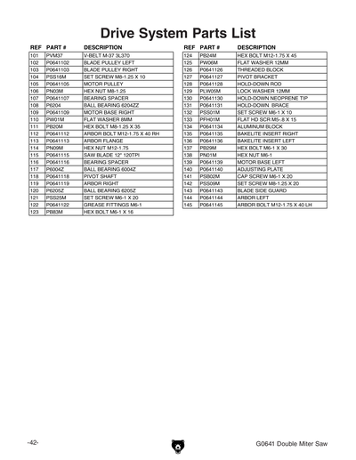

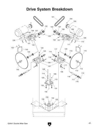

BLADE PULLEY LEFT
BLADE PULLEY RIGHT
SET SCREW M8-1.25 X 10
MOTOR PULLEY
106
Now: PN03M
HEX NUT M8-1.25
107
BEARING SPACER
108
BALL BEARING 6204ZZ
109
COMPLETE MOTOR BASE RIGHT ASSY
109A
110
Now: PW01M
FLAT WASHER 8MM
111
Now: PB20M
HEX BOLT M8-1.25 X 35
112
ARBOR BOLT M12-1.75 X 40 RH
113
ARBOR FLANGE
114
Now: PN09M
HEX NUT M12-1.75
114A
COMPLETE MOTOR BASE LEFT ASSY
115
SAW BLADE 12" 120TPI
116
117
BALL BEARING 6004Z
118
119
ARBOR RIGHT
120
BALL BEARING 6205Z
1201A
COMPLETE TIE ROD PIVOT BOLT ASSY
121
SET SCREW M6-1 X 20
122
123
Now: PB83M
HEX BOLT M6-1 X 16
124
Now: PB24M
HEX BOLT M12-1.75 X 45
125
Now: PW06M
FLAT WASHER 12MM
126
THREADED BLOCK
127
128
HOLD DOWN ROD
129
LOCK WASHER 12MM
130
HOLD DOWN NEOPRENE TIP
$10.10
131
HOLD DOWN BRACE
132
SET SCREW M6-1 X 10
133
FLAT HD SCR M5-.8 X 15
134
ALUMINUM BLOCK
135
BAKELITE INSERT RIGHT
136
BAKELITE INSERT LEFT
137
Now: PB29M
HEX BOLT M6-1 X 30
138
Now: PN01M
HEX NUT M6-1
139
140
ADJUSTING PLATE
141
CAP SCREW M6-1 X 20
142
SET SCREW M8-1.25 X 20
143
BLADE SIDE GUARD
144
ARBOR LEFT
145
ARBOR BOLT M12-1.75 X 40 LH

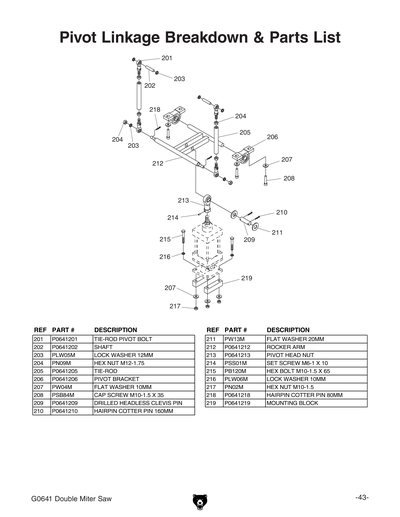

201
TIE-ROD W/PIVOT BOLT
201A
202
SHAFT
203
LOCK WASHER 12MM
204
Now: PN09M
HEX NUT M12-1.75
205
206
PIVOT BRACKET
207
Now: PW04M
FLAT WASHER 10MM
208
CAP SCREW M10-1.5 X 35
209
DRILLED HEADLESS CLEVIS PIN
210
HAIRPIN COTTER PIN 160MM
211
Now: PW13M
FLAT WASHER 20MM
212
ROCKER ARM
213
PIVOT HEAD NUT
213A
COMPLETE MAIN AIR CYLINDER ASSY
214
SET SCREW M6-1 X 10
215
HEX BOLT M10-1.5 X 65
216
LOCK WASHER 10MM
217
Now: PN02M
HEX NUT M10-1.5
218
HAIRPIN COTTER PIN 80MM
219
MOUNTING BLOCK

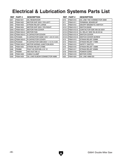

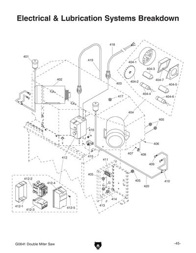

OIL RESERVOIR
402
MOTOR 2HP 220V 1-PH 10A LEFT
403
STRAIN RELIEF M25 TYPE-6 ST
404
MOTOR 2HP 1PH 220V RIGHT
404-1
MOTOR FAN COVER
404-2
MOTOR FAN
404-3
S CAPACITOR COVER
404-4
S CAPACITOR 500M 125V 1-3/4 X 3-3/4
404-5
MOTOR WIRING JUNCTION BOX
404-6
R CAPACITOR 50M 250V 1-1/2 X 2-3/8
404-7
405
STRAIN RELIEF 27MM
406
Now: PS08M
PHLP HD SCR M5-.8 X 12
407
Now: PN06M
HEX NUT M5-.8
408
CABLE CLAMP
409
OIL LINE ELBOW CONNECTOR 4MM
410
OIL LINE TEE CONNECTOR 4MM
411
TERMINAL BOARD 6P
412
ON/OFF MAGNETIC SWITCH
412-1
SWITCH BASE
412-2
CONTACTOR SDE MA-30 220V
412-3
OL RELAY SDE RA-30 22-34A
412-4
SWITCH COVER
412-5
SWITCH COVER SCREW
413
STRAIN RELIEF 22MM
414
STRAIN RELIEF 17MM
415
SAFETY SWITCH
416
STRAIN RELIEF 14MM
417
STRAIN RELIEF 20MM
418
POWER CORD
419
MOTOR CORD
420
OIL LINE 4MM

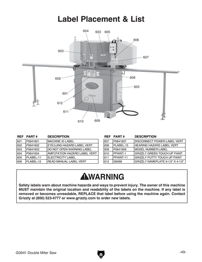

MACHINE ID LABEL
602
EYE/LUNG HAZARD LABEL VERT
603
DO NOT OPEN WARNING LABEL
604
AMPUTATION HAZARD LABEL VERT
605
606
607
DISCONNECT POWER LABEL VERT
608
EAR PROTECTION 2W X 3.3H V2.04.08
609
MODEL NUMBER LABEL
610
N/S GRIZZLY GREEN G1023S
611
GREY PUTTY REF G0504
612
Now: G8589
Nameplate - Large
MAN
