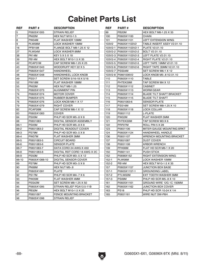

STRAIN RELIEF PG16 TYPE-6 ST

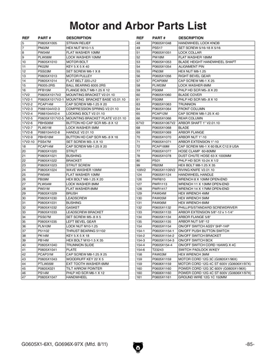

MOTOR 7.5HP 220V/440V 3-PH V1
6-1
MOTOR FAN COVER
6-2
MOTOR FAN
6-3
WIRING JUNCTION BOX
Now: PN02M
HEX NUT M10-1.5
Now: PW04M
FLAT WASHER 10MM
LOCK WASHER 10MM
MOTOR BOLT
Now: PK02M
KEY 5 X 5 X 40
SET SCREW M6-1 X 8
MOTOR PULLEY
FLAT BELT 220-J12
BALL BEARING 6005-2RS
FLANGE BOLT M8-1.25 X 12

STRUT
BUSHING
BRACKET
STRUT SCREW
WAVY WASHER 10MM
Now: PW04M
FLAT WASHER 10MM
Now: PB09M
HEX BOLT M8-1.25 X 20
LOCK WASHER 8MM
Now: PW01M
FLAT WASHER 8MM
BRUSH
LEADSCREW
BUSHING
GASKET
***USE P0651056***
SET SCREW M5-.8 X 5
LEFT BEVEL GEAR
LOCK NUT M10-1.25
THRUST BEARING 51102
Now: PK14M
KEY 5 X 5 X 18
Now: PB14M
HEX BOLT M10-1.5 X 35
TRUNNION SLIDE
PLATE
CAP SCREW M8-1.25 X 25
WOODRUFF KEY 22 X 5
EXT TOOTH WASHER 6MM
45

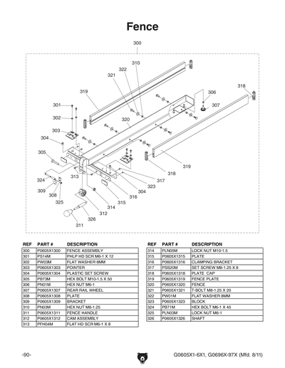

FENCE MOUNTING BRACKET

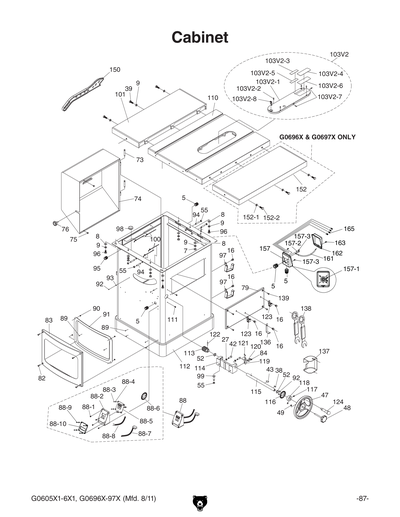

EXTENSION WING
FLAT HD SCR M5-.8 X 20
*DISCD*TABLE INSERT V1.02.09
103V2
TABLE INSERT ASSY V2.01.10
103V2-1

110
TABLE
111
TAP SCREW M4 X 12
112
CABINET
113

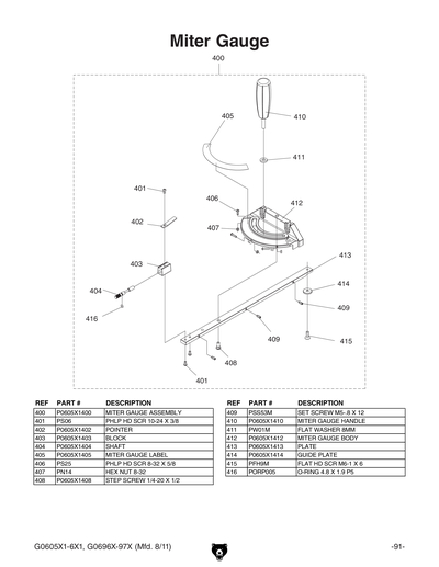

MITER GAUGE MOUNTING BRACKET

ON/OFF SWITCH BRACKET
154-3
ON/OFF SWITCH BOX
154-4
SWITCH CORD ON/OFF 14AWG X 3C
154-5
SAFETY PIN
154-6
SWITCH DISABLING LOCK
157
JUNCTION BOX BASE
157-1
GROUND LABEL
157-2
EXT TOOTH WASHER 5MM
157-3
Now: PS09M
PHLP HD SCR M5-.8 X 10
158
HEX WRENCH 3MM
159
MOTOR CORD 12G 4W ST 600V
160
POWER CORD 12G 4W ST 600V
161
GROUND WIRE 12G 1C 150MM
162
JUNCTION BOX COVER
163
Now: PS18
PHLP HD SCR 10-24 X 1/4
165
WIRE NUT SW-P6H

GUARD CONVERSION KIT
300
FENCE ASSY
301
Now: PS14M
PHLP HD SCR M6-1 X 12
302
Now: PW03M
FLAT WASHER 6MM
303
POINTER
304
***USE P0651304***
305
Now: PB73M
HEX BOLT M10-1.5 X 50
306
Now: PN01M
HEX NUT M6-1
307
REAR RAIL WHEEL
308
PLATE
309
BRACKET
310
Now: PN03M
HEX NUT M8-1.25
311
***USE P0495X155***
312
CAM
313
FLAT HD SCR M6-1 X 8
314
LOCK NUT M10-1.5
315
PLATE
316
RAIL CLAMPING BRACKET
317
SET SCREW M8-1.25 X 8
318
PLATE CAP
319
FENCE PLATE
320
FENCE
321
T-BOLT M8-1.25 X 20
322
Now: PW01M
FLAT WASHER 8MM
323
***USE P0651323***
324
Now: PB71M
HEX BOLT M6-1 X 45
325
LOCK NUT M6-1
326
SHAFT
400
MITER GAUGE ASSEMBLY
401
Now: PS06
PHLP HD SCR 10-24 X 3/8
402
POINTER
403
BLOCK
404
SHAFT
405
MITER GAUGE LABEL
406
Now: PS25
PHLP HD SCR 8-32 X 5/8
407
Now: PN14
HEX NUT 8-32
408
STEP SCREW 1/4-20 X 1/2
409
SET SCREW M5-.8 X 12
410
MITER GAUGE HANDLE
411
Now: PW01M
FLAT WASHER 8MM
412
MITER GAUGE BODY
413
PLATE
414
GUIDE PLATE
415
Now: PFH9M
FLAT HD SCR M6-1 X 6
416
O-RING 4.8 X 1.9 P5

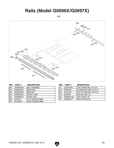

500
COMPLETE BOX 2 OF 3 FOR G0696X
501
REAR RAIL
502
END CAP
503
FENCE TUBE
504
FRONT RAIL
509
Now: PW01M
FLAT WASHER 8MM
510
LOCK WASHER 8MM
511
512
513
FLAT HD SCR M8-1.25 X 25
514
Now: PN03M
HEX NUT M8-1.25
516
LEFT SCALE 18"
517
RIGHT SCALE 36"

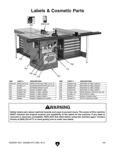

700
GUARD AND ANTI-KICKBACK LABEL
701
DISCONNECT POWER-BLADE CHANGE LABEL
702
GLASSES/RESPIRATOR 2W X 3.3H
703
Now: H7942
Extreme Series Nameplate
704
MODEL NUMBER LABEL
$16.40
705
Now: G8589
Nameplate - Large
706
MACHINE ID LABEL
$16.40
707
708
ELECTRICITY 1.4W X 1.2H
709
N/S GRIZZLY GREEN G1023S
710
GREY PUTTY REF G0504

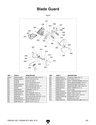

MAN
MANUAL G0605X1-97X MFD-2/9-8/11 V1.02.09
P06967200V4-1
FLAT HD SCR M4-.7 X 8
P06967200V4-10
REAR COVER
P06967200V4-12
Now: PN06M
HEX NUT M5-.8
P06967200V4-13
Now: PS19M
PHLP HD SCR M5-.8 X 6
P06967200V4-14
KNOB BOLT V2.01.10
P06967200V4-15
BLADE GUARD BODY
P06967200V4-16
LEFT BRACKET V2.01.10
P06967200V4-17
MOUNTING BLOCK (RIGHT)
P06967200V4-18
Now: PS38M
PHLP HD SCR M4-.7 X 10
P06967200V4-19
MOUNTING PIN V2.01.10
P06967200V4-2
UPPER COVER
P06967200V4-20
ROLL PIN 5 X 45
P06967200V4-21
Now: PW02M
FLAT WASHER 5MM
P06967200V4-22
LEFT PAWL V2.01.10
P06967200V4-23
RIGHT TORSN SPRING V2.01.10
P06967200V4-24
SHAFT SPRING V2.01.10
P06967200V4-25
E-CLIP 7MM
P06967200V4-26
LEFT TORSION SPRING V2.01.10
P06967200V4-27
RIGHT PAWL V2.01.10
P06967200V4-28
PAWL MOUNTING BRKT V2.01.10
P06967200V4-29
LOCATING PIN 5.25 X 10, 5 X 16
P06967200V4-3
Now: PN01M
HEX NUT M6-1
P06967200V4-30
ANTI-KICKBACK PAWL RELEASE PIN
P06967200V4-31
SPREADER V2.01.10
P06967200V4-32
Now: PS60M
PHLP HD SCR M5-.8 X 30
P06967200V4-33
BLADE GUARD WARNING LABEL
P06967200V4-34
BLADE GUARD COVER (LEFT)
P06967200V4-4
BLADE GUARD COVER (RIGHT)
P06967200V4-5
Now: PW03M
FLAT WASHER 6MM
P06967200V4-6
CONNECTING PLATE
P06967200V4-7
Now: PW03M
FLAT WASHER 6MM
P06967200V4-8
FLAT HD SCR M6-1 X 16
P06967200V4-9
BRACKET
