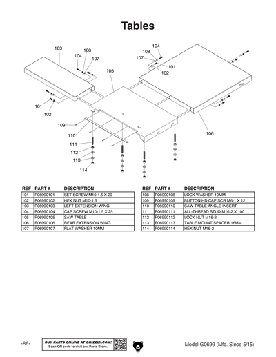

LEFT EXTENSION WING
$199.70
CAP SCREW M10-1.5 X 25
SAW TABLE
$1,221.05
106
REAR EXTENSION WING
$502.80
107
Now: PW04M
FLAT WASHER 10MM
108
LOCK WASHER 10MM
109
BUTTON HD CAP SCR M6-1 X 12
110
SAW TABLE ANGLE INSERT
$24.60
111
ALL-THREAD STUD M16-2 X 100
$31.80
112
LOCK NUT M16-2
113
TABLE MOUNT SPACER 16MM
$9.00
114
Now: PN13M
HEX NUT M16-2

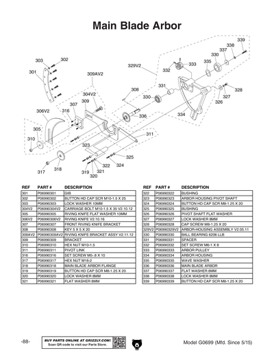

BLADE COVER
$121.45
224
BLADE COVER DOOR HINGE
$14.35
225
Now: PW02M
FLAT WASHER 5MM
226
LOCK WASHER 5MM
227
CAP SCREW M5-.8 X 8
228
HINGE BRACKET
$9.95
229
Now: PW02M
FLAT WASHER 5MM
230
LOCK WASHER 5MM
231
CAP SCREW M5-.8 X 10
232
MAGNET HOLDER
$43.30
233
ELEVATION TRUNNION
$443.85
234
V-BELT 3VX-250
$39.00
235
SET SCREW M8-1.25 X 10
236
MAIN BLADE MOTOR PULLEY
$148.05
237
SPACER
$22.50

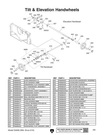

401
LOCK KNOB M10-1.5
$4.90
402
Now: PW04M
FLAT WASHER 10MM
403
HANDWHEEL FLAT WASHER 10MM
$1.49
404
HANDWHEEL W/HANDLE
405
Now: PK25M
KEY 7 X 7 X 20
406
*DISCD*HANDWHEEL SHAFT
406A
HANDWHEEL SHAFT ASSEMBLY
$153.70
407
BEARING WASHER
$14.95
408
BALL BEARING 6902ZZ
408V2
BALL BEARING 6902-2RS
409
BEARING SEAT
$36.35
410
LOCK WASHER 8MM
411
THRUST BEARING NTB1528 AS
$11.60
412
UNIVERSAL JOINT
$84.80
413
TILT LEADSCREW
$64.25
414
Now: PW01M
FLAT WASHER 8MM
415
CAP SCREW M8-1.25 X 20
416
SET SCREW M6-1 X 6
417
TRUNNION CONNECTOR
$47.40
418
SET SCREW M6-1 X 6
419
TILT LEADSCREW NUT
$20.45
420
LOCK KNOB M10-1.5
421
Now: PW04M
FLAT WASHER 10MM
422
423
HANDWHEEL ASSY
425
LEADSCREW SLEEVE
$28.10
426
CONNECTING SHAFT
427
SET SCREW M6-1 X 6
428
SHAFT LOCK COLLAR
429
CAP SCREW M6-1 X 25
429V2
CAP SCREW M6-1 X 30
430
LOCK WASHER 6MM
431
ELEVATION LEADSCREW CLAMP
$36.85
432
CAP SCREW M8-1.25 X 60
433
LOCK WASHER 8MM
434
LEADSCREW BRACKET
$38.75
435
Now: PW03M
FLAT WASHER 6MM
436
LOCK WASHER 6MM
437
CAP SCREW M6-1 X 12
438
Now: PK34M
KEY 5 X 5 X 20
439
Now: PW03M
FLAT WASHER 6MM
440
CAP SCREW M6-1 X 10
441
CAP SCREW M10-1.5 X 35
442
Now: PN02M
HEX NUT M10-1.5
443
LOCK COLLAR
$10.85
444
445
Now: PR19M
EXT RETAINING RING 28MM

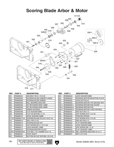

G0699 BOX 2 OF 2 SLIDING TABLE
$3,793.50
501
Now: PB49M
HEX BOLT M12-1.75 X 20
502
SCORING BLADE ARBOR FLANGE
$10.65
503
SCORING BLADE ARBOR
$78.00
504
BALL BEARING 6202-2RS
505
Now: PR54M
INT RETAINING RING 15MM
506
Now: PR21M
INT RETAINING RING 35MM
507
ARBOR HOUSING
$73.50
508
Now: PW03M
FLAT WASHER 6MM
509
FLAT HD SCR M6-1 X 16
510
WAVE WASHER 26MM
$5.65
511
*DISCD*SCORING BLADE PULLEY V1
$39.60
511V3
SCORING BLADE PULLEY V3.01.16
$41.00
512
ROLL PIN 5 X 25
513
PULLEY FLAT WASHER 6MM
$2.50
514
HEX BOLT M6-1 X 16 LH
$3.20
515
Scoring Blade 4-3/4 (120mm) x 20mm for G0699 and G0764Z
516
CAP SCREW M12-1.75 X 100
517
LOCK WASHER 12MM
518
SCORING MOTOR PULLEY
$54.10
519
SET SCREW M6-1 X 20
520
RIBBED FLAT BELT 140J7 V1
$38.55
520V2
FLAT BELT 18 X 355MM V2.01.16
$49.90
521
PIVOT SHAFT
$20.55
522
BUTTON HD CAP SCR M8-1.25 X 20
523
LOCK WASHER 8MM
524
SCORING MOTOR MOUNTING PLATE
$79.00
525
LOCK NUT M14-2
526
SCORING MOTOR 1HP 220V/440V 3-PH
$240.95
527
Now: PN02M
HEX NUT M10-1.5
528
CAP SCREW M10-1.5 X 20
529
TENSION SPRING
$9.50
530
CAP SCREW M10-1.5 X 50
531
Now: PN02M
HEX NUT M10-1.5
532
Now: PW03M
FLAT WASHER 6MM
533
LOCK WASHER 6MM
534
CAP SCREW M6-1 X 16
535
Now: PW10M
FLAT WASHER 14MM
536
536V2
BALL BEARING 6003-2RS
601
601V2
Now: PB03M
HEX BOLT M8-1.25 X 16
602
Now: PW01M
FLAT WASHER 8MM
603
HORIZONTAL ADJUSTMENT SHAFT
$26.40
604
ECCENTRIC SHAFT
$36.95
605
LOCK NUT M6-1
606
BELLEVILLE DISC SPRING 6MM
$6.55
607
COMPRESSION SPRING
$17.50
608
PIVOT ARM
$13.75
609
Now: PW03M
FLAT WASHER 6MM
610
LOCK WASHER 6MM
611
CAP SCREW M6-1 X 16
612
VERTICAL ADJUSTMENT SHAFT
$15.70
613
SET SCREW M6-1 X 25
614
Now: PN01M
HEX NUT M6-1
615
Now: PN03M
HEX NUT M8-1.25
616
ROLL PIN 3 X 12
617
VERTICAL ADJUSTMENT BOLT
$21.05

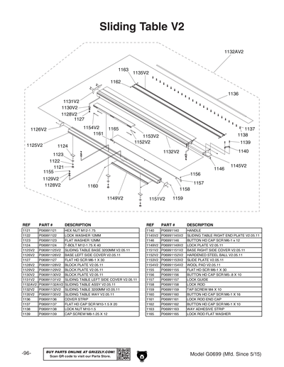

1121
Now: PN09M
HEX NUT M12-1.75
1122
LOCK WASHER 12MM
1123
Now: PW06M
FLAT WASHER 12MM
1124
T-BOLT M12-1.75 X 40
$7.80
1125
*DISCD*SLIDING TABLE SET 3200MM V2.08.07
1125V2
SLIDING TABLE W/BASE 3200MM V2.05.11
1126
1126V2
BASE LEFT SIDE COVER V2.05.11
$38.30
1127
FLAT HD SCR M6-1 X 30
1128
1128V2
BLOCK PLATE V2.05.11
1129
1129V2
1130
1130V2
$19.70
1131
1131V2
SLIDING TABLE LEFT SIDE COVER V2.05.11
$42.95
1132
1132-1
HANDLE M12-1.75 X 20
$24.20
1132-2
T-SLOT NUT M12-1.75
$11.60
1132-3
FLAT WASHER 12MM (COPPER)
$12.10
1132-4
FLAT WASHER 12MM
$3.20
1132AV2
SLIDING TABLE ASSY V2.05.11
$3,722.60
1132V2
1133
1134
FLAT HD SCR M6-1 X 10
1135
1135V2
SLIDING TABLE WAY V2.05.11
$53.80
1137
FLAT HD CAP SCR M10-1.5 X 20
1138
LOCK NUT M10-1.5
1139
CAP SCREW M8-1.25 X 12
1140
HANDLE
$4.90
1141
1142
SET SCREW M5-.8 X 8
1143
1144
CAP SCREW M8-1.25 X 16
1145
1145V2
SLIDING TABLE RIGHT END PLATE V2.05.11
$83.90
1146
1147
CAP SCREW M6-1 X 10
1148
Now: PW03M
FLAT WASHER 6MM
1149
1149V2
LOCK PLATE V2.05.11
$20.70
1150
TAP SCREW M5 X 16
1151
1151V2
BASE RIGHT SIDE COVER V2.05.11
$38.30
1152
1152V2
STEEL BALL BEARING 16.7MM V2.05.11
$4.35
1153
1153V2
SLIDE PLATE V2.05.11
$82.00
1154
1154V2
WOOL PAD V2.05.11
$6.90
1155
1156
BUTTON HD CAP SCR M5-.8 X 10
1157
LOCK GUIDE
$9.50
1158
LOCK ROD
$75.90
1159
TAP SCREW M4 X 10
1160
BUTTON HD CAP SCR M6-1 X 16
1161
LOCK ROD END CAP
$2.25
1162
BUTTON HD CAP SCR M6-1 X 10
1163
WAY ADHESIVE STRIP
$20.85
1164
1165
LOCK ROD FLAT WASHER
$4.65

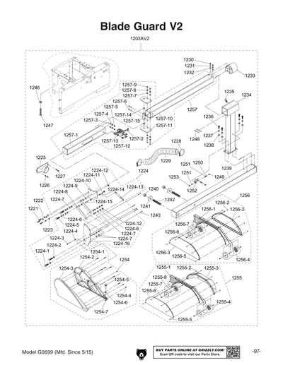

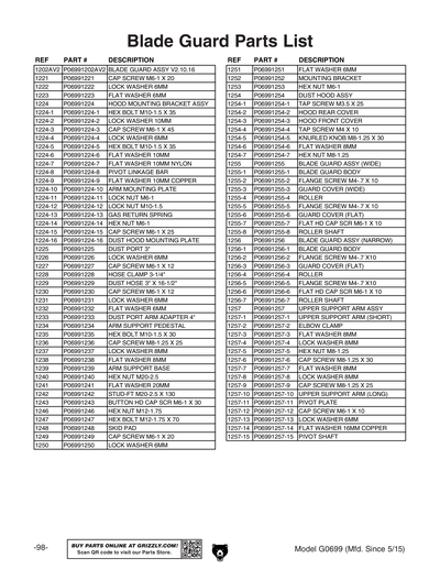

1224-1
Now: PB14M
HEX BOLT M10-1.5 X 35
1224-10
ARM MOUNTING PLATE
1224-11
LOCK NUT M6-1
1224-12
LOCK NUT M10-1.5
1224-13
GAS RETURN SPRING
1224-14
Now: PN01M
HEX NUT M6-1
1224-15
CAP SCREW M6-1 X 25
1224-16
DUST HOOD MOUNTING PLATE
1224-2
LOCK WASHER 10MM
1224-3
CAP SCREW M6-1 X 45
1224-4
LOCK WASHER 6MM
1224-5
Now: PB14M
1224-6
Now: PW04M
FLAT WASHER 10MM
1224-7
FLAT WASHER 10MM NYLON
1224-8
PIVOT LINKAGE BAR
1224-9
FLAT WASHER 10MM COPPER
1225
BLADE SHROUD DUST PORT
1226
LOCK WASHER 6MM
1227
CAP SCREW M6-1 X 12
1228
HOSE CLAMP 3-1/4"
1229
DUST HOSE 3" X 16-1/2"
1230
CAP SCREW M6-1 X 12
1231
LOCK WASHER 6MM
1232
Now: PW03M
FLAT WASHER 6MM
1233
DUST PORT ARM ADAPTER 4"
1234
ARM SUPPORT PEDESTAL
1235
Now: PB01M
HEX BOLT M10-1.5 X 30
1236
CAP SCREW M8-1.25 X 25
1237
LOCK WASHER 8MM
1238
Now: PW01M
FLAT WASHER 8MM
1239
ARM SUPPORT BASE
1240
Now: PN28M
HEX NUT M20-2.5
1241
Now: PW13M
FLAT WASHER 20MM
1242
STUD-FT M20-2.5 X 130
1243
BUTTON HD CAP SCR M6-1 X 30
1246
Now: PN09M
HEX NUT M12-1.75
1247
HEX BOLT M12-1.75 X 70
1248
SKID PAD
1249
CAP SCREW M6-1 X 20
1250
LOCK WASHER 6MM
1251
Now: PW03M
FLAT WASHER 6MM
1252
MOUNTING BRACKET
1253
Now: PN01M
HEX NUT M6-1
1254
DUST HOOD ASSY
1254-1
TAP SCREW M3.5 X 25
1254-2
HOOD REAR COVER
1254-3
HOOD FRONT COVER
1254-4
TAP SCREW M4 X 10
1254-5
KNURLED KNOB M8-1.25 X 30
1254-6
Now: PW01M
FLAT WASHER 8MM
1254-7
Now: PN03M
HEX NUT M8-1.25
1255
BLADE GUARD ASSY (WIDE)
1255-1
BLADE GUARD BODY
1255-2
FLANGE SCREW M4-.7 X 10
1255-3
RIGHT BLADE COVER V2.03.10
1255-4
ROLLER
1255-5
1255-6
LEFT BLADE COVER V2.03.10
1255-7
FLAT HD CAP SCR M6-1 X 10
1255-8
ROLLER SHAFT
1256
BLADE GUARD ASSY (NARROW)
1256-1
BLADE GUARD BODY
1256-2
1256-3
1256-4
ROLLER
1256-5
1256-6
1256-7
ROLLER SHAFT
1257
UPPER SUPPORT ARM ASSY
1257-1
UPPER SUPPORT ARM (SHORT)
1257-10
UPPER SUPPORT ARM (LONG)
1257-11
PIVOT PLATE
1257-12
CAP SCREW M6-1 X 10
1257-13
LOCK WASHER 6MM
1257-14
FLAT WASHER 16MM COPPER
1257-15
PIVOT SHAFT
1257-2
ELBOW CLAMP
1257-3
Now: PW01M
FLAT WASHER 8MM
1257-4
LOCK WASHER 8MM
1257-5
Now: PN03M
HEX NUT M8-1.25
1257-6
CAP SCREW M8-1.25 X 30
1257-7
Now: PW01M
FLAT WASHER 8MM
1257-8
LOCK WASHER 8MM
1257-9

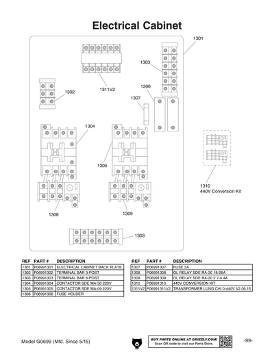

1301
ELECTRICAL CABINET BACK PLATE
$506.15
1302
TERMINAL BAR 3-POST
$17.20
1303
TERMINAL BAR 6-POST
$12.70
1304
CONTACTOR SDE MA-30 220V
$200.50
1305
CONTACTOR SDE MA-09 220V
$166.05
1306
FUSE HOLDER
$17.50
1307
FUSE 2A
$5.55
1308
OL RELAY SDE RA-30 18-26A
$94.85
1309
OL RELAY SDE RA-20 2.7-4.4A
$105.50
1310
440V CONVERSION KIT
$86.85
1311
TRANSFORMER LUNG CHI 0-440V V2.05.15
1311V2
$86.15

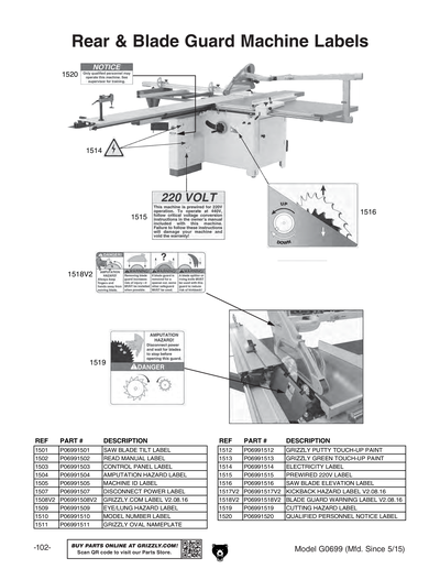

1501
SAW BLADE TILT LABEL
$9.60
1502
1503
CONTROL PANEL LABEL
$80.80
1504
MOVING BLADE/AMPUTATION 3.8W X 2H
1505
MACHINE ID LABEL
$16.40
1506
ENTANGLEMENT HAZARD 2W X 3.3H
1507
DISCONNECT 220V 2W X 3.3H
1508
GRIZZLY LABEL V1
$16.90
1508V2
GRIZZLY.COM LABEL 13",GREEN
1509
GLASSES/RESPIRATOR 2W X 3.3H
1510
MODEL NUMBER LABEL
$12.30
1511
Now: G8589
Nameplate - Large
1512
GREY PUTTY REF G0504
1513
N/S GRIZZLY GREEN G1023S
1514
ELECTRICITY 1.4W X 1.2H
1515
PREWIRED 220V 4.3W X 2.9H
1516
SAW BLADE ELEVATION LABEL
$9.60
1517
KICKBACK HAZARD LABEL V1
$8.40
1517V2
KICKBACK HAZARD LABEL V2.08.16
$9.40
1518
BLADE GUARD WARNING LABEL V1
$8.40
1518V2
BLADE GUARD WARNING LABEL V2.08.16
$13.75
1519
CUTTING HAZARD LABEL
$8.40
