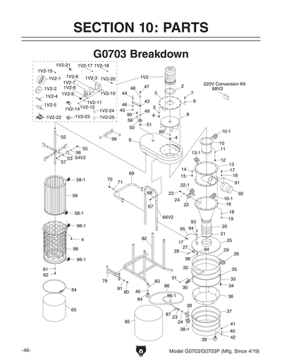

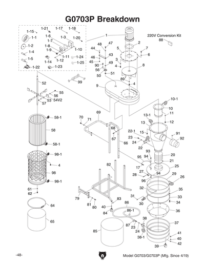

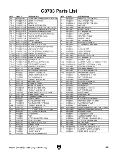

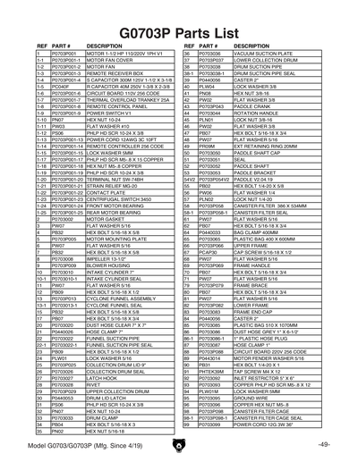

Parts for G0703 1-1/2 HP 2 Stage Cyclone Dust Collector
Parts Diagrams for G0703 - 1-1/2 HP 2 Stage Cyclone Dust Collector
Parts List for Parts for G0703 1-1/2 HP 2 Stage Cyclone Dust Collector
MOTOR 1.5HP 110V/220V 1-PH V1
$479.55
1-1
MOTOR FAN COVER
1-2
MOTOR FAN
1-3
MOTOR JUNCTION BOX
1-4
S CAPACITOR 300M 125V 1-1/2 X 3-1/8
$29.00
1-5
R CAPACITOR 40M 250V 1-3/8 X 2-3/8
1V2
MOTOR 1.5HP 110V/220V 1-PH V2.01.12
$694.65
1V2-1
MOTOR FAN COVER
$24.15
1V2-10
Now: PN07
HEX NUT 10-24
1V2-11
Now: PW03
FLAT WASHER #10
1V2-12
Now: PS06
PHLP HD SCR 10-24 X 3/8
1V2-14
REMOTE CONTROLLER 256 CODE
$70.60
1V2-15
LOCK WASHER 5MM
1V2-17
PHLP HD SCR M5-.8 X 15 COPPER
1V2-18
HEX NUT M5-.8 COPPER
1V2-19
Now: PS06
1V2-2
MOTOR FAN
1V2-20
TERMINAL NUT SW-74BH
1V2-21
STRAIN RELIEF TYPE-6 ST
1V2-22
CENTRIFUGAL SWITCH 3450 W/CONTACT PLATE
1V2-23
$32.65
1V2-24
BALL BEARING 6205ZZ
1V2-25
BALL BEARING 6203ZZ
1V2-3
REMOTE RECEIVER BOX
1V2-4
1V2-5
1V2-6
CIRCUIT BOARD 110V 256 CODE
$116.30
1V2-7
OVERLOAD TRANKEY 25A
$27.95
1V2-8
REMOTE CONTROL PANEL
$32.65
1V2-9
POWER SWITCH
MOTOR GASKET
$4.30
Now: PW07
FLAT WASHER 5/16
Now: PB07
HEX BOLT 5/16-18 X 3/4
MOTOR MOUNTING PLATE
$61.60
Now: PW07
FLAT WASHER 5/16
Now: PB07
7V2
Now: PB32
HEX BOLT 5/16-18 X 5/8
IMPELLER 13-1/2"
$159.40
BLOWER HOUSING
$189.75
INTAKE CYLINDER 7"
$54.35
10-1
INTAKE CYLINDER SEAL
$3.65
Now: PW07
FLAT WASHER 5/16
Now: PB07
INTAKE BARREL 9-13/16 X 16-1/2" V2.09.20
13-1
INTAKE BARREL SEAL
$5.50
13V2
Now: PW07
FLAT WASHER 5/16
Now: PB07
15V2
Now: PB32
CYCLONE FUNNEL 7" V1
$152.15
16-1
CYCLONE FUNNEL SEAL
16V2
CYCLONE FUNNEL 7" V2.09.20
Now: PB07
Now: PW07
FLAT WASHER 5/16
Now: PN02
HEX NUT 5/16-18
DUST HOSE CLEAR 7 X 7"
$47.10
HOSE CLAMP 7"
FUNNEL SUCTION PIPE
$18.15
22-1
FUNNEL SUCTION PIPE SEAL
$3.05
Now: PB07
23V2
Now: PB09
HEX BOLT 5/16-18 X 1/2
Now: PLW01
LOCK WASHER 5/16
COLLECTION DRUM LID 7" V1
$97.85
25V2
COLLECTION DRUM LID 7" V2.09.20
COLLECTION DRUM SEAL 1.6M
$16.35
LATCH HOOK
$3.90
RIVET 4 X 13MM BLIND, STEEL
$1.49
UPPER COLLECTION DRUM V1
$126.80
29V2
UPPER COLLECTION DRUM V2.09.20
DRUM LID LATCH ASSEMBLY
Now: PS06
Now: PN07
HEX NUT 10-24
DRUM CLAMP
$29.00
Now: PB04
Now: PN02
HEX NUT 5/16-18
VACUUM SUCTION PLATE
$101.45
COLLECTION DRUM LOWER V1
$144.90
37V2
COLLECTION DRUM LOWER V2.09.20
DRUM SUCTION PIPE
$21.75
38-1
DRUM SUCTION PIPE SEAL
$4.85
CASTER 2"
Now: PLW04
LOCK WASHER 3/8
Now: PN08
HEX NUT 3/8-16
Now: PW02
FLAT WASHER 3/8
PADDLE CRANK
$14.50
ROTATION HANDLE
$19.95
45
Now: PLN01
LOCK NUT 3/8-16
46
Now: PW02
FLAT WASHER 3/8
Now: PB07
48
Now: PW07
FLAT WASHER 5/16
49
Now: PR83M
INT RETAINING RING 20MM
50
PADDLE SHAFT CAP
51
SEAL
52
PADDLE SHAFT
53
PADDLE BRACKET
$6.40
54
PADDLE V1
$6.90
54V2
PADDLE V2.04.19
$6.05
55
Now: PB02
HEX BOLT 1/4-20 X 5/8
56
Now: PW06
FLAT WASHER 1/4
57
Now: PLN02
LOCK NUT 1/4-20
58
CARTRIDGE FILTER V1
$391.25
58V2
CANISTER FILTER 386 X 534MM V2.03.11
$275.35
58V2-1
CANISTER FILTER SEAL V2.03.11
$23.60
59
PADDLE SUPPORT
60
TAP SCREW M4 X 12
61
Now: PW07
FLAT WASHER 5/16
62
Now: PB03
63
CARTRIDGE FILTER CLAMP
64
BAG CLAMP 400MM V1.06.05
64V2
65
PLASTIC BAG 400 X 600MM
$9.70
66
FRAME UPPER
$29.00
67
CAP SCREW 5/16-18 X 3/4
68
Now: PW07
FLAT WASHER 5/16
69
FRAME HANDLE
$26.00
70
Now: PB07
71
Now: PW07
FLAT WASHER 5/16
72
ELECTRICAL BOX MOUNTING PLATE
$20.70
73
Now: PB07
74
Now: PW07
FLAT WASHER 5/16
75
REMOTE MAG SWITCH 110V V2.02.06
75-1
CONTACTOR NHD C-09D 110V
75-2
OL RELAY NHD NTH-21 17-21A
$43.50
75-3
CIRCUIT BOARD 110V
$65.25
75-4
ON/OFF SWITCH 110/220V
75-5
REMOTE CONTROL BOX
76
POWER CORD 14AWG W/PLUG V1.02.05
77
MOTOR CORD 10G 3W
78
REMOTE CONTROLLER
79
FRAME BRACE
$19.00
80
Now: PB07
81
Now: PW07
FLAT WASHER 5/16
82
FRAME LOWER
83
FRAME END CAP
84
CASTER 2"
85
BAG 510 X 1070MM PLASTIC
$23.60
86
DUST HOSE GREY 1" X 6-1/2'
$22.20
86-1
PLASTIC HOSE PLUG 1"
$1.49
87
HOSE CLAMP 1"
88
CONVERSION KIT 220V
$221.75
88-1
CONTACTOR NHD C-09D 220V
$31.40
88-2
OL RELAY NTH-11 8-11A
$34.45
88-3
CIRCUIT BOARD 220V W/TRANSFORMER
88V2
CIRCUIT BOARD 220V 256 CODE
89
IMPELLER FENDER WASHER 5/16
90
Now: PB31
HEX BOLT 1/4-20 X 1
91
Now: PS02M
PHLP HD SCR M4-.7 X 12
92
INLET RESTRICTOR 5" X 6"
$68.85
93
Now: PS08M
PHLP HD SCR M5-.8 X 12
94
LOCK WASHER 5MM
95
GROUND WIRE
96
97
Now: PW03
FLAT WASHER #10
98
GREEN CANISTER CAGE ASSY V1
$253.60
98-1
CANISTER FILTER CAGE SEAL
98A
GREEN CANISTER ASSEMBLY V1
98AV2
BEIGE CANISTER ASSEMBLY V2.07.12
98V2
BEIGE CANISTER CAGE ASSY V2.07.12
$289.80

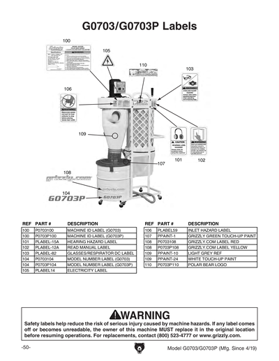

MAN
MANUAL G0703 MFD-08.09-02.12 V1.08.09
100
MACHINE ID LABEL V1
100V2
MACHINE ID LABEL CSA V2.01.12
EAR PROTECTION 2W X 3.3H V2.04.08
GLASSES/RESPIRATOR DC 2W X 3.3H
MODEL NUMBER LABEL
ELECTRICITY 1.4W X 1.2H
106
HANDS/DUST COLLECTOR OUTLET 2W X 3.3H
107
N/S GRIZZLY GREEN G1023S
108
GRIZZLY.COM LABEL RED 11 X 2-1/4"
111
HEX BOLT 3/8-16 X 11
112
CYCLONE FUNNEL ADAPTER
113
COLLECTION LID HANDLE
114
Now: PB18
HEX BOLT 3/8-16 X 1
115
DRUM LID CONNECTING PLATE
116
FLAT WASHER 5/16 THIN
117
Now: PLN03
LOCK NUT 5/16-18
118
DRUM LID SPRING
119
Now: PS35
PHLP HD SCR 5/16-18 X 3/4
120
Now: PWF01
FENDER WASHER 5/16
121
PLASTIC DRUM HANDLE
122
Now: PN40
ACORN NUT 5/16-18
123
DRUM WINDOW 80MM
124
RIVET
MAN
MANV2
MANUAL G0703 MFD-03.12-03.19 V2.04.12
MANV3
MANUAL G0703 MFD-04.19+ V3.04.19
