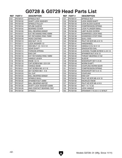

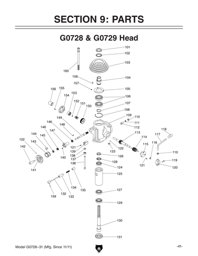

SPINDLE NUT
$37.20
SHAFT LOCK WASHER
$6.90
SPINDLE PULLEY
$169.50
SPLINE SLEEVE
$75.20
BEARING COVER
$7.25
106
BALL BEARING 6009ZZ
107
Now: PR56M
EXT RETAINING RING 45MM
108
Now: PR67M
INT RETAINING RING 75MM
109
HEAD CASTING
$543.40
110
Now: PN13
HEX NUT 1/2-13
111
Now: PLW07
LOCK WASHER 1/2
112
Now: PB49
HEX BOLT 1/2-13 X 1/2
113
GEAR SHAFT
$142.15
114
TORSION SPRING
$13.15
115
END CAP
116
Now: PR08M
EXT RETAINING RING 19MM
117
HANDLE LEVER
$24.25
118
KNOB 1/2-13
$10.70
119
CAP SCREW M8-1.25 X 20
120
HANDLE BASE
$76.45
121
CAP SCREW M5-.8 X 16
122
SET SCREW M6-1 X 8
123
OIL CUP 1/8" NPT X 8MM X 24MM ELBOW
124
BALL BEARING 6206ZZ
125
SPINDLE QUILL
$408.00
126
SPANNER NUT 30MM
127
BALL BEARING 6007ZZ
128
SHAFT LOCK WASHER 30MM
129
Now: P7207
ANGULAR CONTACT BEARING 7207
130
SPINDLE
$348.45
130-1
SET SCREW M4-.7 X 10
131
SPINDLE NUT
$25.40
132
LOCK KNOB SHAFT
$21.30
133
LOCK BLOCK SLEEVE
$12.95
134
COMPRESSION SPRING
$2.45
135
LOCK PLUNGER SMALL
$13.25
136
LIMIT BLOCK SCREW
$26.00
137
DOWNFEED LOCK RING
$9.10
138
DOWNFEED STOP RING
$9.10
139
QUILL DOG
$18.15
140
Now: PS20M
PHLP HD SCR M5-.8 X 15
141
HANDWHEEL
$56.35
142
HANDLE 5/16-18 X 1/2
$7.90
143
GRADUATED DIAL
$33.35
144
LOCKING THUMB SCREW 5-.8 X 12
$5.85
145
SPANNER NUT 9/16-12
$3.40
146
THRUST BEARING 51102
147
SLEEVE
$46.55
148
Now: PK34M
KEY 5 X 5 X 20
149
WORM SHAFT
$51.95
150
COUPLING WORM GEAR
$61.90
151
COMPRESSION SPRING
$4.85
152
KEY 6 X 6 X 15
$4.30
153
BUSHING
154
END CAP
$35.00
155
Now: PS09M
PHLP HD SCR M5-.8 X 10
156
KNURLED KNOB
$40.10
157
Now: PS05M
PHLP HD SCR M5-.8 X 8
158
Now: PK25M
KEY 7 X 7 X 20
159
LOCK HANDLE
$9.70
160
DRAWBAR 7/16-20 X 12 W/NUT
$26.70

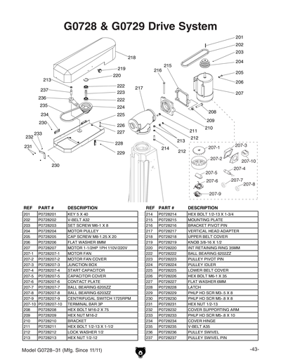

201
Now: PK02M
KEY 5 X 5 X 40
202
Now: PVA32
V-BELT A32
203
SET SCREW M6-1 X 8
204
MOTOR PULLEY
$103.00
205
206
Now: PW01M
FLAT WASHER 8MM
207
MOTOR 1.5HP 110V/220V 1-PH
$640.35
207-1
MOTOR FAN
207-10
TERMINAL BAR 3P
207-2
MOTOR FAN COVER
207-3
JUNCTION BOX
207-4
S CAPACITOR 400M 125V 1-3/4 X 3-9/16
207-5
CAPACITOR COVER
$12.10
207-6
CONTACT PLATE
207-7
BALL BEARING 6205ZZ
207-8
BALL BEARING 6203ZZ
207-9
CENTRIFUGAL SWITCH 1725RPM
208
HEX BOLT M16-2 X 75
209
Now: PN13M
HEX NUT M16-2
210
BRACKET
$108.45

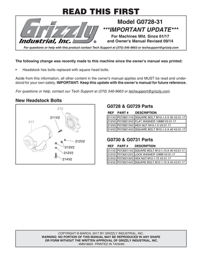

211V2
SQUARE BOLT M10-1.5 X 35 V2.01.17
$7.60
212V2
Now: PW04M
FLAT WASHER 10MM
213V2
Now: PN02M
HEX NUT M10-1.5
214V2
SQUARE BOLT M10-1.5 X 40 V2.01.17
$7.20
215
MOUNTING PLATE
$68.85
216
PIVOT BOLT 1/2 X 140
217
VERTICAL HEAD ADAPTER
218
UPPER BELT COVER
$207.00
219
KNOB 3/8-16 X 1/2
$3.05
220
Now: PR21M
INT RETAINING RING 35MM
222
BALL BEARING 6202ZZ
223
PULLEY PIVOT PIN
$29.30
224
PULLEY IDLER
$66.75
225
LOWER BELT COVER
$166.50
226
Now: PB52M
HEX BOLT M6-1 X 35
227
Now: PW03M
FLAT WASHER 6MM
228
LATCH
229
Now: PS79M
PHLP HD SCR M3-.5 X 8
230
Now: PS05M
231
Now: PN13
HEX NUT 1/2-13
232
COVER SUPPORTING ARM
$16.10
233
Now: PS09M
234
COVER HINGE
$12.25
235
Now: PVA35
V-BELT A35
236
PULLEY SWIVEL
237
PULLEY SWIVEL PIN
$14.25

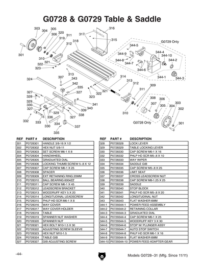

301
HANDLE 3/8-16 X 1/2
$24.75
302
Now: PN04
HEX NUT 5/8-11
303
SET SCREW M6-1 X 8
304
HANDWHEEL
$97.55
305
GRADUATED DIAL
$56.50
306
$3.95
307
CAP SCREW M6-1 X 25
308
SPACER
$55.20
309
Now: PR09M
EXT RETAINING RING 20MM
310
BALL BEARING 6004ZZ
311
CAP SCREW M6-1 X 45
312
LEADSCREW BRACKET
$89.70
313
Now: PK34M
KEY 5 X 5 X 20
314
LONGITUDINAL LEADSCREW
$303.25
315
Now: PS03M
PHLP HD SCR M6-1 X 8
316
WAY COVER
$37.10
317
WAY COVER HOLDER
$15.95
318
TABLE
319
SPANNER NUT WASHER
320
SPANNER NUT
$19.10
321
Now: PB01M
HEX BOLT M10-1.5 X 30
322
ADJUSTING SCREW SLEEVE
323
Now: PN02M
HEX NUT M10-1.5
324
TABLE GIB
$48.10
327
GIB ADJUSTING SCREW
$6.40
328
LOCK LEVER
329
TABLE LOCKING LEVER
$6.70
330
CAP SCREW M6-1 X 16
332
Now: PS09M
333
WAY WIPER
$22.95
334
SADDLE GIB
$46.60
335
CAP SCREW M5-.8 X 25
336
LIMIT SEAT
$18.15
337
CROSS LEADSCREW NUT
$70.15
338
CAP SCREW M8-1.25 X 25
339
SADDLE
340
LIMIT BLOCK
341
Now: PS06M
PHLP HD SCR M5-.8 X 20
342
LONGITUDINAL NUT
$116.30
343
Now: PW03M
FLAT WASHER 6MM

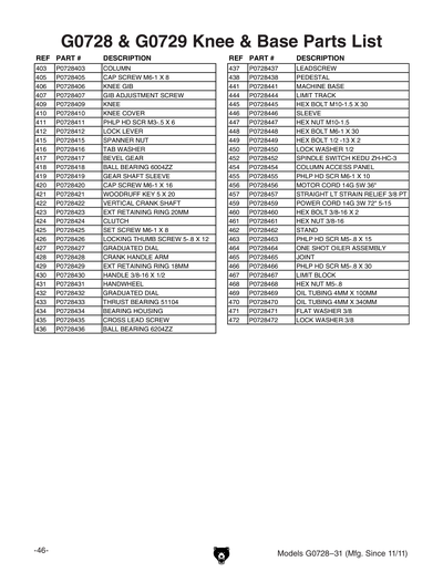

403
COLUMN
405
CAP SCREW M6-1 X 8
406
KNEE GIB
$50.75
407
GIB ADJUSTMENT SCREW
$11.45
409
KNEE
$740.55
410
KNEE COVER
411
Now: PS12M
PHLP HD SCR M3-.5 X 6
412
LOCK LEVER
415
SPANNER NUT
$19.00
416
TAB WASHER
417
BEVEL GEAR
$72.45
418
BALL BEARING 6004ZZ
419
GEAR SHAFT SLEEVE
420
CAP SCREW M6-1 X 16
421
Now: PK34M
KEY 5 X 5 X 20
422
VERTICAL CRANK SHAFT
423
Now: PR09M
424
CLUTCH
425
SET SCREW M6-1 X 8
426
$6.40
427
GRADUATED DIAL
$50.15
428
CRANK HANDLE ARM
$92.55
429
Now: PR07M
EXT RETAINING RING 18MM
430
HANDLE 3/8-16 X 1/2
431
HANDWHEEL
$92.05
432
GRADUATED DIAL
$53.80
433
THRUST BEARING 51104
434
BEARING HOUSING
435
CROSS LEAD SCREW
$175.75
436
BALL BEARING 6204ZZ
437
LEADSCREW
438
PEDESTAL
441
MACHINE BASE
444
LIMIT TRACK
445
Now: PB01M
446
SLEEVE
447
Now: PN02M
HEX NUT M10-1.5
448
Now: PB29M
HEX BOLT M6-1 X 30
449
Now: PB72
HEX BOLT 1/2-13 X 2
450
Now: PLW07
LOCK WASHER 1/2
452
SPINDLE SWITCH KEDU ZH-HC-3
$75.50
454
COLUMN ACCESS PANEL
455
Now: PS68M
PHLP HD SCR M6-1 X 10
456
MOTOR CORD 14G 5W 36"
457
STRAIN RELIEF TYPE-10 ST
459
POWER CORD 14G 3W 72" 5-15
460
Now: PB58
HEX BOLT 3/8-16 X 2
461
Now: PN08
HEX NUT 3/8-16
462
STAND
463
Now: PS20M
464
ONE SHOT OILER ASSEMBLY
465
JOINT
$11.20
466
Now: PS60M
PHLP HD SCR M5-.8 X 30
467
LIMIT BLOCK
468
Now: PN06M
HEX NUT M5-.8
469
OIL TUBING 4MM X 100MM
470
OIL TUBING 4MM X 340MM
$7.25
471
Now: PW02
FLAT WASHER 3/8
472
Now: PLW04
LOCK WASHER 3/8

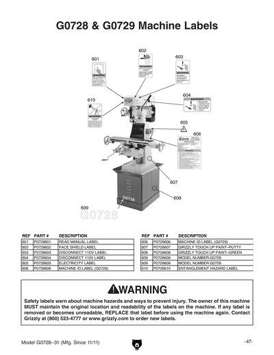

601
READ MANUAL 1.5W X 2.5H
602
FACE SHIELD 1.5W X 2.5H
603
DISCONNECT 110V 1.5W X 2.5H
604
DISCONNECT 110V 2.8W X 1.5H
605
ELECTRICITY 0.7W X 0.6H
606
MACHINE ID LABEL
607
GREY PUTTY REF G0504
608
N/S GRIZZLY GREEN G1023S
609
MODEL NUMBER LABEL
610
ENTANGLEMENT HAZARD 1.5W X 2.5H
611
MANUAL G0728 MFG-9.11 V1.12.11
