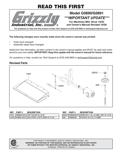

GAS STRUT 400N (LEFT) V2.12.23
144V2

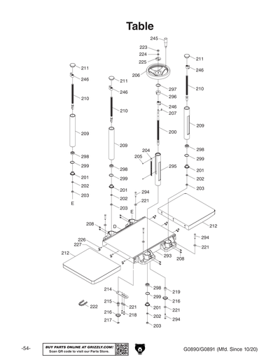

LEADSCREW
201
SPROCKET
202
Now: PW04M
FLAT WASHER 10MM
203
Now: PN08M
HEX NUT M10-1.25
204
DEPTH-OF-CUT SCALE
205
PHLP HD SCR M3-.5 X 4
206
HANDWHEEL TYPE-3 216D X 10B-K X M10-1.5
207
Now: PK48M
KEY 4 X 4 X 20
208
SET SCREW M10-1.5 X 12
209
COLUMN
210
LEADSCREW
211
CAP
212
CAST IRON EXTENSION TABLE
214
BRACKET
215
SHAFT
216
SPROCKET
217
Now: PR05M
EXT RETAINING RING 15MM
218
Now: PB07M
HEX BOLT M8-1.25 X 25
219
SLEEVE
221
Now: PW01M
FLAT WASHER 8MM
222
CHAIN 410 X 148P
223
Now: PN08M
HEX NUT M10-1.25
223V2
KNOB M10-1.25, 6-LOBE, D62 V2.12.23
224
Now: PW04M
FLAT WASHER 10MM
225
***USE P0550053***
226
Now: PB07M
227
SET SCREW M8-1.25 X 20
227V2
SET SCREW M8-1.25 X 12
228
SPACER 18 X 37.5 X 6MM
245
REVOLVING HANDLE 24 X 92, M10-1.5 X 12
246
LEADSCREW MOUNT
293
MAIN TABLE
294
HEX BOLT M8-1.25 X 45
295
COLUMN
296
BUSHING
297
Now: PR22M
INT RETAINING RING 38MM
298
BALL BEARING 6202Z
299
Now: PR21M
INT RETAINING RING 35MM

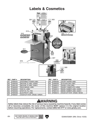

301
DISCONNECT 110V 1.5W X 2.5H
302
MACHINE ID LABEL
$16.40
303
READ MANUAL 1.5W X 2.5H
304
ADD OIL NOTICE
305
STOP OIL FILL TAG 4W X 4H
306
ELECTRICITY 0.7W X 0.6H
307
N/S GRIZZLY GREEN G1023S
308
INJURY HAZARD LABEL
309
EYE/FACE/LUNG LABEL 1.5W X 2.5H
310
***USE PGZCOM-44B***
311
Now: G8589
Nameplate - Large
312
MODEL NUMBER LABEL
$16.40
313
BEIGE REF G0555
