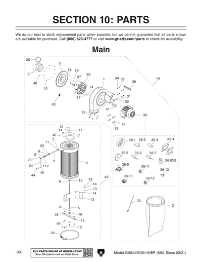

Parts Diagrams for G0944HEP - 1-1/2 HP Wall Mount Dust Collector with HEPA Filter

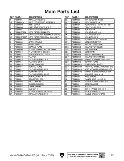

Parts List for Parts for G0944HEP 1-1/2 HP Wall Mount Dust Collector with HEPA Filter
IMPELLER HOUSING
1A
IMPELLER HOUSING ASSEMBLY
INLET COVER
INLET ADAPTER 6" X 4" X 2
0.3 Micron Canister Filter for G0944HEP Dust Collector
4A
HEPA FILTER ASSEMBLY
$536.15
4AV2
HEPA FILTER ASSEMBLY V2.05.24
$578.35
4V2
HEPA FILTER V2.05.24
$509.65
MAIN SPINDLE
5V2
MAIN SPINDLE V2.05.24
CRANK SPINDLE
BEVEL GEAR
BEARING PLATE
8V2
MOUNTING PLATE V2.05.24
SLEEVE BEARING 12 X 14 X 6MM
Now: PS06
PHLP HD SCR 10-24 X 3/8
Now: PSS04
SET SCREW 1/4-20 X 5/16
FLAPPER
Now: PS68M
PHLP HD SCR M6-1 X 10
Now: PW06
FLAT WASHER 1/4
PADDLE SPINDLE BRACKET
BEARING PLATE
Now: PS05M
PHLP HD SCR M5-.8 X 8
MOUNTING PLATE
Now: PS20M
PHLP HD SCR M5-.8 X 15
Now: PB83M
HEX BOLT M6-1 X 16
Dust Collection Bag for G0583Z, G0785 and G0944 Series
***USE P0860051***
RUBBER BUSHING
CRANK HANDLE
END CAP 4"
ALUMINUM IMPELLER 12-3/4"
IMPELLER WASHER 1/4
CAP SCREW M6-1 X 30
Now: PLW02
LOCK WASHER 1/4
POWER CORD 14G 3W 72" 5-15P
T-BOLT 1/4-20 X 3/4
HEX NUT 1/4
Now: PB03
HEX BOLT 5/16-18 X 1
Now: PW07
FLAT WASHER 5/16
Now: PN02
HEX NUT 5/16-18
MOTOR 1-1/2 HP 110V 1-PH
36-1
MOTOR FAN COVER
36-10
CENTRIFUGAL SWITCH
36-11
FRONT MOTOR BEARING 6203-2RS
36-12
REAR MOTOR BEARING 6205-2RS
36-13
CIRCUIT BREAKER ZING ZE-700-15 15A
36-2
R CAPACITOR COVER
36-3
S CAPACITOR COVER
36-4
JUNCTION BOX
36-5
MOTOR FAN
36-6
R CAPCITOR 45M 250V
36-7
S CAPACITOR 300M 125V
36-8
CIRCUIT BOARD REVO V2.10.21
36-9
CONTACT PLATE
Now: PB19
HEX BOLT 1/4-20 X 1/2
WALL BRACKET
Now: PFB15
FLANGE BOLT 1/4-20 X 3/4
Now: PFS03
FLANGE SCREW 10-24 X 3/8
MOTOR GASKET
REMOTE
CRANK HANDLE M10-1.5 X 14
45
LOCK NUT M10-1.5
LOCK NUT M5-.8
48
CRANKSHAFT BRACKET
49
Now: PS09M
PHLP HD SCR M5-.8 X 10
50
Now: PB26
HEX BOLT 1/4-20 X 1-1/2
51
Now: PLN02
LOCK NUT 1/4-20

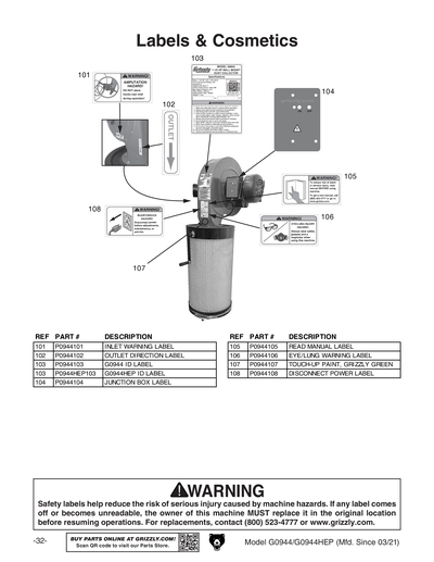

OUTLET DIRECTION LABEL
G0944HEP ID LABEL
$16.40
JUNCTION BOX LABEL
READ MANUAL 2.8W X 1.5H
106
GLASSES/RESPIRATOR 2.8W X 1.5H
107
DISCONNECT 110V 2.8W X 1.5H
