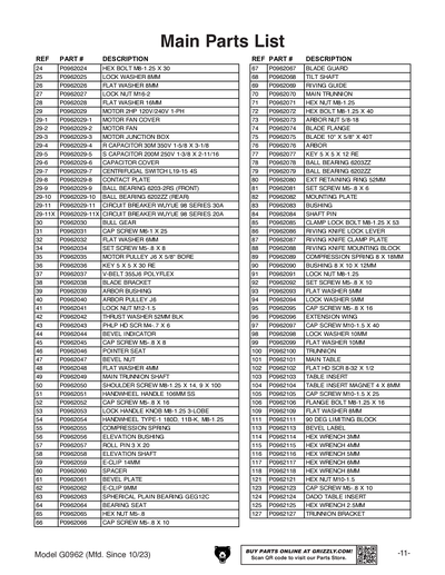

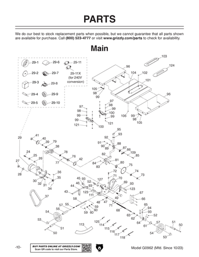

HEX BOLT M8-1.25 X 30
LOCK WASHER 8MM
Now: PW01M
FLAT WASHER 8MM
LOCK NUT M16-2
Now: PW08M
FLAT WASHER 16MM
MOTOR 2HP 120V/240V 1-PH
$379.10
29-1
MOTOR FAN COVER
29-10
BALL BEARING 6202ZZ
29-11
CIRCUIT BREAKER WUYUE 98 SERIES 30A
29-11X
CIRCUIT BREAKER WUYUE 98 SERIES 20A
29-2
MOTOR FAN
29-3
MOTOR JUNCTION BOX
29-4
R CAPACITOR 30M 350V 1-5/8 X 3-1/8
29-5
S CAPACITOR 200M 250V 1-3/8 X 2-11/16
29-6
CAPACITOR COVER
29-7
CENTRIFUGAL SWITCH W/ CONTACT PLATE
29-8
29-9
BALL BEARING 6203-2RS
BULL GEAR
CAP SCREW M6-1 X 25
Now: PW03M
FLAT WASHER 6MM
SET SCREW M5-.8 X 8
MOTOR PULLEY J6 X 5/8" BORE V2.06.15
Now: PK12M
KEY 5 X 5 X 30
POLY-V BELT 355J6
BLADE BRACKET
ARBOR BUSHING
ARBOR PULLEY
LOCK NUT M12-1.5
THRUST WASHER 52MM BLACK
Now: PS17M
PHLP HD SCR M4-.7 X 6
BEVEL INDICATOR
45
CAP SCREW M5-.8 X 8
46
POINTER SEAT
BEVEL NUT
48
SHIM WASHER
49
MAIN TRUNNION SHAFT
50
HANDLE BOLT
51
HANDWHEEL HANDLE 106MM SS
52
CAP SCREW M5-.8 X 16
53
LOCK HANDLE
54
HANDWHEEL TYPE 1 180D X 11B-K X M8-1.25
55
COMPRESSION SPRING
56
ELEVATION BUSHING
57
ROLL PIN 3 X 20
58
ELEVATION SHAFT
59
E-CLIP 14MM
60
SPACER
61
BEVEL PLATE
62
E-CLIP 9MM
63
SPHERICAL PLAIN BEARING GEG12C
64
BEARING SEAT
65
Now: PN06M
HEX NUT M5-.8
66
CAP SCREW M5-.8 X 10
67
BLADE GUARD
68
TILT SHAFT
69
RIVING GUIDE
71
Now: PN03M
HEX NUT M8-1.25
72
Now: PB15M
HEX BOLT M8-1.25 X 40
73
Now: PN09
HEX NUT 5/8-18
74
BLADE FLANGE
75
BLADE 10" X 5/8" X 40T
76
ARBOR
77
Now: PK10M
KEY 5 X 5 X 12
78
BALL BEARING 6203ZZ
79
BALL BEARING 6202ZZ
80
Now: PR76M
EXT RETAINING RING 52MM
81
SET SCREW M5-.8 X 6
82
MOUNTING PLATE
83
BUSHING
84
SHAFT PIN
85
RIVING CLAMP LOCK BOLT M8-1.25 X 53
86
***USE P0771086***
86V2
***USE P0771086***
87
RIVING CLAMP
88
RIVING DECK
89
COMPRESSION SPRING
90
RIVING SEAT
91
LOCK NUT M8-1.25
92
SET SCREW M5-.8 X 10
93
Now: PW02M
FLAT WASHER 5MM
94
LOCK WASHER 5MM
95
96
EXTENSION WING
97
CAP SCREW M10-1.5 X 40
98
LOCK WASHER 10MM
99
Now: PW04M
FLAT WASHER 10MM
100
TRUNNION

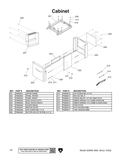

$28.55
207
MOTOR COVER
$63.70
208
CAP SCREW M6-1 X 16
209
BUTTON HD CAP SCR M5-.8 X 10
209V2
BUTTON HD CAP SCR M5-.8 X 16
210
CAP SCREW M5-.8 X 25
211
Now: PN06M
HEX NUT M5-.8
212
STRAIN RELIEF 1/2"-3/8" SNAP-IN ST
213
ARBOR WRENCH 16 X 23MM OPEN-END
214
ARBOR WRENCH 13 X 22MM CLOSED-ENDS
215
PUSH STICK
216
Now: PW03M
FLAT WASHER 6MM
217
LOCK WASHER 6MM

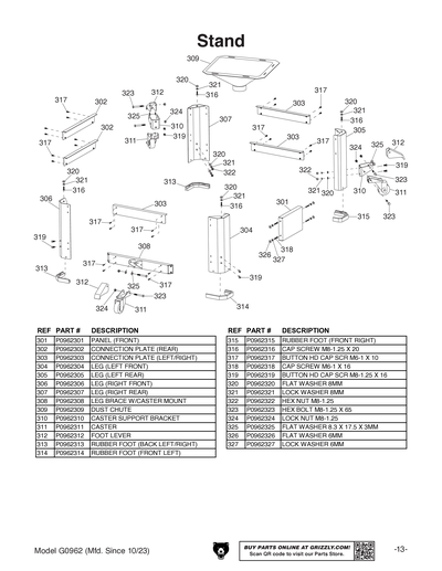

301
PANEL (FRONT)
301V2
STAND V2.02.24
$114.20
302
CONNECTION PLATE (REAR)
303
CONNECTION PLATE (LEFT/RIGHT)
304
LEG (LEFT FRONT)
305
LEG (LEFT REAR)
306
LEG (RIGHT FRONT)
307
LEG (RIGHT REAR)
308
LEG BRACE W/CASTER MOUNT
309
DUST CHUTE
310
CASTER SUPPORT BRACKET
311
CASTER
312
FOOT LEVER
313
RUBBER FOOT BACK LEFT/RIGHT
314
RUBBER FOOT FRONT LEFT
315
RUBBER FOOT FRONT RIGHT
316
CAP SCREW M8-1.25 X 20
316V2
CAP SCREW M10-1.5 X 30
317
BUTTON HD CAP SCR M6-1 X 10
318
CAP SCREW M6-1 X 16
319
BUTTON HD CAP SCR M8-1.25 X 16
320
Now: PW01M
FLAT WASHER 8MM
320V2
Now: PW04M
FLAT WASHER 10MM
321
LOCK WASHER 8MM
321V2
LOCK WASHER 10MM
322
Now: PN03M
HEX NUT M8-1.25
323
Now: PB86M
HEX BOLT M8-1.25 X 65
324
LOCK NUT M8-1.25
325
FLAT WASHER 8.3 X 17.5 X 3MM
$1.60
326
Now: PW03M
FLAT WASHER 6MM
327
LOCK WASHER 6MM
328
Now: PN02M
HEX NUT M10-1.5

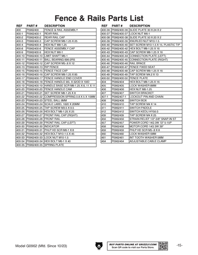

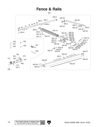

400
FENCE & RAIL ASSEMBLY
400-1
REAR RAIL
400-10
LIMIT SHAFT M6-1
400-11
BALL BEARING 696-2RS
400-12
CAP SCREW M5-.8 X 12
400-13
RIP FENCE
400-15
FENCE FACE CAP V1
400-16
CAP SCREW M8-1.25 X 85
400-17
FENCE HANDLE END COVER
400-18
FENCE HANDLE 19ID X 32OD X 90L
400-19
HANDLE BASE SCR M8-1.25 X 8, 11 X 11
400-2
REAR RAIL CAP
400-20
FENCE HANDLE CAM
400-21
SET SCREW M8-1.25 X 8
400-22
COMPRESSION SPRING .8 X 5 X 15
400-23
STEEL BALL 6MM
400-24
SCALE LABEL V2.03.18
400-25
TAP SCREW 3.5 X 9.5 V2.06.19
400-26
Now: PB07M
HEX BOLT M8-1.25 X 25
400-27
FRONT RAIL CAP RIGHT
400-28
FRONT RAIL
400-29
FRONT RAIL CAP LEFT
400-3
CAP SCREW M8-1.25 X 25
400-30
INDICATOR
400-31
Now: PS03M
PHLP HD SCR M6-1 X 8
400-32
HEX BOLT M10-1.5 X 45
400-33
LOCK NUT M10-1.5
400-34
Now: PB47M
HEX BOLT M6-1 X 40
400-35
SPRING PLATE
400-36
SLIDE PLATE 30 X 24 X 2
400-37
LOCK NUT M6-1
400-38
SLIDE PLATE 50 X 20 X 2
400-39
KNURLED NUT M10-1.5
400-4
Now: PN03M
HEX NUT M8-1.25
400-40
SET SCREW M10-1.5 X 15, PLASTIC TIP
400-42
Now: PB03M
HEX BOLT M8-1.25 X 16
400-43
CAP SCREW M8-1.25 X 16
400-44
CONNECTION PLATE (L)
400-45
CONNECTION PLATE (R)
400-46
RAIL BRACE
400-47
FENCE FIXED SEAT
400-48
400-49
TAP SCREW M4.2 X 13
400-50
FENCE PLATE
400-8
FENCE ASSEMBLY CAP
400-9
Now: PN01M
HEX NUT M6-1
404
Now: PB03M
405
LOCK WASHER 8MM
406
Now: PN03M
HEX NUT M8-1.25
407
SWITCH BRACKET
407-1
LOCKOUT PIN AND CHAIN
408
SWITCH BOX V2.08.17
408V2
SWITCH BOX V3.06.24
410
TAP SCREW M4 X 14
411
SWITCH PADDLE W/KEDU HY56-3 V2.09.17
412
SWITCH KEDU HY56-3 V2.09.17
412V2
SWITCH KEDU KJD17B V3.06.24
412V2X
SWITCH KEDU KJD17B/240V
439
TAP SCREW M4 X 25
456
457
POWER CORD 14G 3W 72" 5-15P
457V2
MOTOR CORD 14G 3W 47" V2.06.24
457V2X
POWER CORD 14G 3W 78" 6-15P
458
MOTOR CORD 14G 3W 39"
458V2
POWER CORD 14G 3W 78" 5-15P V2.06.24
459
Now: PS05M
PHLP HD SCR M5-.8 X 8
460
LOCK WASHER 5MM
461
EXT TOOTH WASHER 5MM
464
ADJUSTABLE CABLE CLAMP

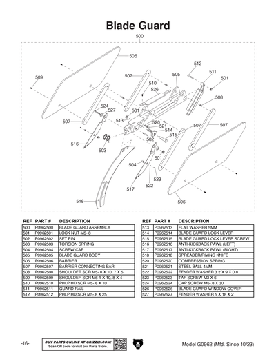

500
BLADE GUARD ASSEMBLY
501
LOCK NUT M5-.8
502
SET PIN
503
TORSION SPRING
504
SCREW CAP
505
BLADE GUARD BODY V2.01.21
506
BARRIER
507
BARRIER CONNECTING BAR V2.01.21
508
SHOULDER SCR M5-.8 X 10, 7 X 5 V2.01.21
509
SHOULDER SCREW M6-1 X 10, 8 X 4 V2.01.21
510
Now: PS09M
PHLP HD SCR M5-.8 X 10
511
GUARD RAIL
512
Now: PS22M
PHLP HD SCR M5-.8 X 25
513
Now: PW02M
FLAT WASHER 5MM
514
BLADE GUARD LOCK LEVER
515
BLADE GUARD LOCK LEVER SCREW
516
ANTI-KICKBACK PAWL (L)
517
ANTI-KICKBACK PAWL (R)
518
SPREADER/RIVING KNIFE
520
COMPRESSION SPRING
521
STEEL BALL 4MM
522
FENDER WASHER 3.2 X 9 X 0.8
$1.60
523
TAP SCREW M3 X 6
524
CAP SCREW M5-.8 X 30
526
BLADE GUARD WINDOW COVER
527
FENDER WASHER 5 X 18 X 2
$1.60

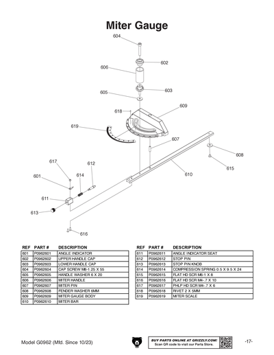

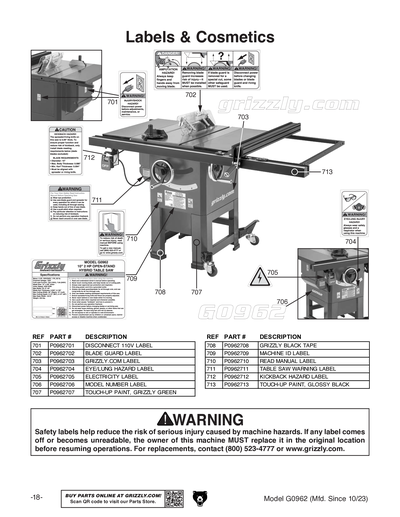

701
DISCONNECT 110V 1.5W X 2.5H
702
BLADE GUARD LABEL
703
GRIZZLY.COM LABEL
$11.50
704
GLASSES/RESPIRATOR 1.5W X 2.5H
705
ELECTRICITY 1.4W X 1.2H
706
MODEL NUMBER LABEL
$11.50
707
N/S GRIZZLY GREEN G1023S
708
GLOSSY BLACK
709
MACHINE ID LABEL V1
$10.95
709V2
MACHINE ID LABEL V2.02.24
$10.95
710
READ MANUAL 1.5W X 2.5H
711
TABLE SAW WARNING LABEL
712
KICKBACK HAZARD LABEL
713
GLOSSY BLACK
714
Now: H4609
Oblong Nameplate-Small
715
MODEL NUMBER LABEL
MAN
MANUAL G0962 MFD-10.23- 01.24 V1.12.23
