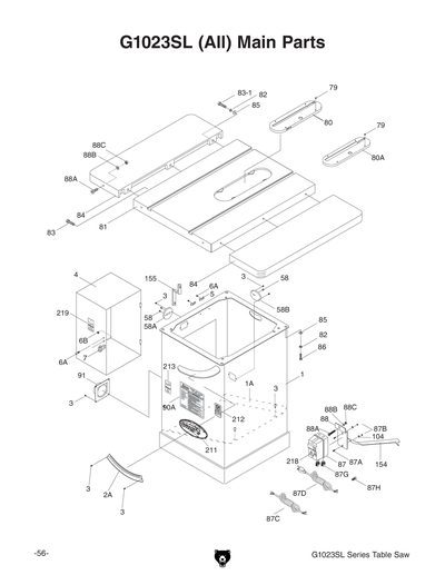

CABINET
$416.60
1A
PANEL LOWER
SCALE V1.09.01
$7.25
2A
SCALE V2.03.06
TAP SCREW 10-24 X 3/8
MOTOR COVER
$94.20
CORD CLAMP
6A
Now: PS01
PHLP HD SCR 10-24 X 1/2
6B
Now: PN07
HEX NUT 10-24
LATCH
7A
STRIKE
*DISCD*HANDWHEEL LOCK
8A
LOCK KNOB
$43.15
HANDLE V1.12.95
9B

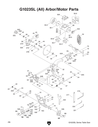

WORM 1.410" OD
COLLAR
Now: PSS05
SET SCREW 5/16-18 X 1/4
TILT SHAFT
$15.45
26A
BRASS WASHER 3/4
DOWEL PIN
27A
WAVY WASHER 30MM
Now: PK15M
KEY 5 X 5 X 35
29A
*DISCD*GEARED TRUNNION
$109.35
29B
BUSHING
$6.40
Now: PN02
HEX NUT 5/16-18
30A
CAP SCREW 5/16-18 X 1-1/2
30B
SPACER
$1.60
Now: PB03
HEX BOLT 5/16-18 X 1
FLANGE
$100.90
*DISCD*SHAFT
*DISCD*GEAR BEARING HOUSING V1.09.01
35A
GEAR BEARING HOUSING V2.09.03
$141.30
35B
HOUSING CAP
$6.10
35C
Now: PS06
PHLP HD SCR 10-24 X 3/8
35D
Now: PLW03
LOCK WASHER #10
35E
*DISCD*COMPLETE ARBOR ASSY
CAP SCREW 3/8-16 X 1-1/2
37A
Now: PLW04
LOCK WASHER 3/8
37B
Now: PK03
KEY 1/4 X 1/4 X 2
BALL BEARING 6203-2RS
Now: PR23M
INT RETAINING RING 40MM
THIN LOCK NUT 5/8-18 LH
COLLAR
ARBOR PULLEY
Now: PSS11
SET SCREW 1/4-20 X 1/4
43A
Now: PSS07
SET SCREW 1/4-20 X 1/2
Now: PK02M
KEY 5 X 5 X 40
45
*DISCD*BLADE ARBOR
46
BLADE
ARBOR FLANGE
48
ARBOR NUT 5/8-12 RH
50

79
Now: PSS07
80
*DISCD*STANDARD TABLE INSERT
80A
*DISCD*DADO TABLE INSERT
80B
SPRING CLIP 10 X 30.7 X 7.5
$1.49
80C
Now: PS06
81
*DISCD*TABLE
82
Now: PLW04
LOCK WASHER 3/8
83
Now: PB24
HEX BOLT 3/8-16 X 1-1/4
83-1
Now: PB18
HEX BOLT 3/8-16 X 1
84
*DISCD*EXT WING 10" W/BLACK EDGE
84L
EXT WING LEFT
$287.15
84R
EXTENSION WING RIGHT
$353.55
85
Now: PW02
FLAT WASHER 3/8
86
CAP SCREW 3/8-16 X 3/4
87
MAGNETIC SWITCH 3HP 1PH
$137.70
87-1
MAG SWITCH COVER
$25.75
87A
Now: PS31
PHLP HD SCR 10-24 X 1-3/4
87B
Now: PN07
HEX NUT 10-24
87C
POWER CORD 12G X 3W 36"L
87D
POWER CORD 12G X 3W 86"L
87E
Now: G7301
1,000 pc. Cable Tie Assortment
87G
STRAIN RELIEF TYPE-3 MG20A
$5.45
87H
*DISCD*STATOR
88
SWITCH MOUNT BRACKET
$22.40
88A
Now: PFH07
FLAT HD SCR 5/16-18 X 1-1/4
88B
Now: PW07
FLAT WASHER 5/16
88C
Now: PN02
HEX NUT 5/16-18
89
Now: PK02
KEY 1/4 X 1/4 X 3
90A
MACHINE ID LABEL
91
DUST PORT
$4.60
92
Now: PW07
FLAT WASHER 5/16
94
*DISCD*DUST DEFLECTOR
95
MOTOR FRAME SUPPORT SCREW 5/16-18 X 1-1/
$1.49
95A
Now: PSS08
SET SCREW 5/16-18 X 1/2
95B
Now: PN02
HEX NUT 5/16-18
99

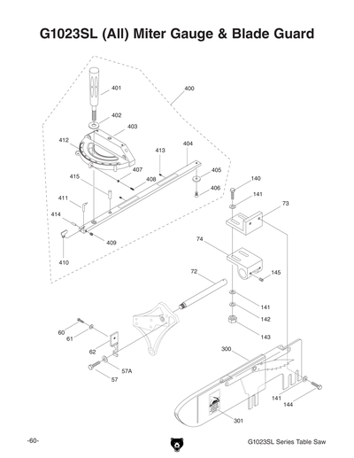

300
BLADE GUARD ASSEMBLY
$90.55
301
BLADE GUARD LABEL
302
***USE P1023SL300***
400
*DISCD*COMPLETE MITER GAUGE
401
MITER GAUGE HANDLE V2.10.01
402
Now: PW07
FLAT WASHER 5/16
403
MITER GAUGE BODY V2.05.07
404
MITER BAR ASSY V2.04.03
405
T-SLOT WASHER 22
$2.70
406
Now: PFH26
FLAT HD SCR 10-24 X 1/4
407
Now: PN07
HEX NUT 10-24
408
Now: PSS31
SET SCREW 10-24 X 5/8
409
Now: PSS29
SET SCREW 10-24 X 1/4
410
MITER GAUGE STOP
411
*DISCD*POINTER
412
MITER GAUGE SCALE
413
Now: PSS31
414
ROLL PIN 1.5 X 13
415
MITER GAUGE HINGE PIN

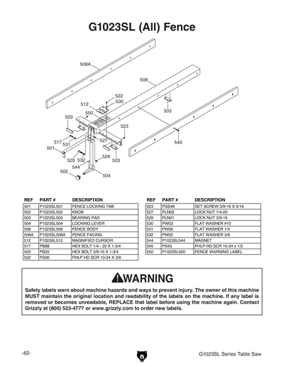

HANDWHEEL UPGRADE KIT
501
FENCE LOCKING TAB
$10.50
502
KNOB 3/8-16, D1-9/16, TAPERED BALL V2.04.07
503
BEARING PAD
504
LOCKING LEVER
508
FENCE BODY
$172.95
508A
FENCE FACING
512
MAGNIFIED CURSOR
$4.70
514
SCALE 26"
$6.95
515

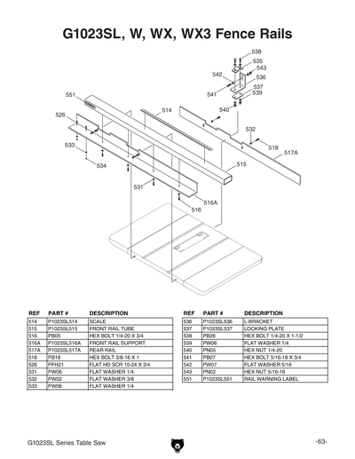

FRONT RAIL TUBE
$129.80
516
Now: PB05
HEX BOLT 1/4-20 X 3/4
516A
FRONT RAIL 46-1/2"
$126.80
517
Now: PB88
HEX BOLT 1/4-20 X 1-3/4
517A
REAR RAIL 46-1/2"
$126.80
518
Now: PB18
HEX BOLT 3/8-16 X 1
520
Now: PB25
HEX BOLT 3/8-16 X 1-3/4
522
Now: PS06
523
Now: PSS48
SET SCREW 1/4-28 X 5/8
526
Now: PFH21
FLAT HD SCR 10-24 X 3/4
527
Now: PLN02
LOCK NUT 1/4-20
528
Now: PLN01
LOCK NUT 3/8-16
530
Now: PW03
FLAT WASHER #10
531
Now: PW06
FLAT WASHER 1/4
532
Now: PW02
FLAT WASHER 3/8
533
Now: PW06
FLAT WASHER 1/4
534
Now: PN05
HEX NUT 1/4-20
535
V-CLAMP
536
L-BRACKET
537
LOCK PLATE
$1.60
538
Now: PB26
HEX BOLT 1/4-20 X 1-1/2
539
Now: PW06
FLAT WASHER 1/4
540
Now: PN05
HEX NUT 1/4-20
541
Now: PB07
HEX BOLT 5/16-18 X 3/4
542
Now: PW07
FLAT WASHER 5/16
543
Now: PN02
HEX NUT 5/16-18
544
MAGNET
545
Now: PS01
550
FENCE WARNING LABEL
$4.25
551
RAIL WARNING LABEL
$4.25
