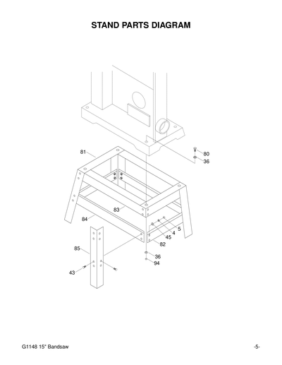

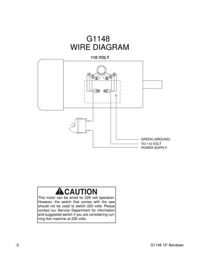

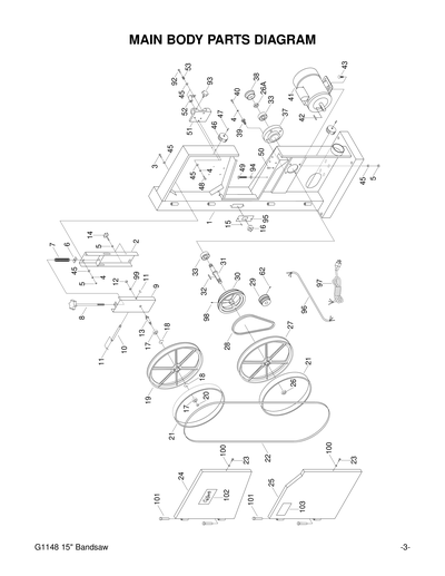

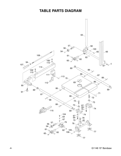

Parts for G1148 Heavy-Duty 15" Bandsaw

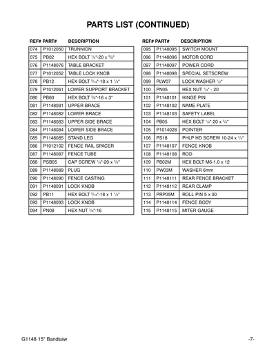

Parts Diagrams for G1148 - Heavy-Duty 15" Bandsaw
Parts List for Parts for G1148 Heavy-Duty 15" Bandsaw
