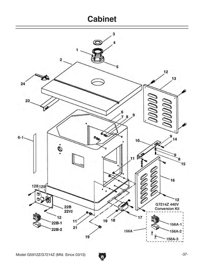

TABLE
SMALL INNER
MID-SIZED INSERT
LARGE INSERT
STAND ASSY
6-1
DEGREE SCALE
Now: PN08
HEX NUT 3/8-16
Now: PLW04
LOCK WASHER 3/8
Now: PW02
FLAT WASHER 3/8
RIGHT TABLE BRACE
Now: PN07
HEX NUT 10-24
Now: PS12
PHLP HD SCR 1/4-20 X 5/8
REMOVABLE DUST DOOR
Now: PB24
HEX BOLT 3/8-16 X 1-1/4
Now: PB21
HEX BOLT 3/8-16 X 3/4
MOTOR COVER
Now: PS08
PHLP HD SCR 10-24 X 3/4
TERMINAL BOX ASSY
18A
TERMINAL BOX W/O BUSBAR
STRAIN RELIEF M14.5 TYPE-6 ST
CORD ELECTRIC
STRAIN RELIEF 5/8" TYPE-9 ELBOW
*DISCD*SWITCH BOX ASSEMBLY V1.03.99
22-1
*DISCD*SQUARE GREEN ON SWITCH V1.08.03
22-1A
ON SWITCH ROUND V2.03.06
$25.50
22-2
*DISCD*SQUARE RED OFF SWITCH V1.08.03
22-2A
OFF SWITCH ROUND V2.03.06
$38.75
22-3
E-STOP BUTTON 230V 6A V2.03.06
$52.20
22-4
CONTACTOR
22-5
*DISCD*F/O/R SWITCH KEDU ZH-HC-33-BY V1
22-5V2
F/O/R SWITCH KEDU ZH-HC-433-BY V2.03.06
$92.15
22-6
THERMAL OVERLOAD TH-20 18-26A
$91.55
22A-7
RED AND GREEN 220V LIGHT BULB 2PC
$7.60
22B
CONTACTOR
22B-1
CONTACTOR
$105.80
22B-2
OL RELAY
$100.00
22C
22D
CONTACTOR
22E
22F
SWITCH BOX ASSEMBLY V2.10.09
22V2
$799.40
LEFT TABLE BRACE

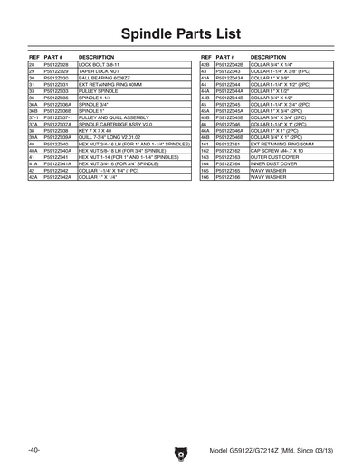

BALL BEARING 6008ZZ
***USE PR68M***
$1.00
Now: PR50M
INT RETAINING RING 80MM
PULLEY AND QUILL ASSEMBLY
*DISCD*STAR WASHER 30MM
*DISCD*SPANNER NUT
SPINDLE ASSEMBLY 1-1/4"
36-2
MULTI-WRENCH
36A
***USE P5912Z036A-1***
36B
SPINDLE 1" ASSY
36B-2
MULTI-WRENCH
37A
Now: PK55M
KEY 7 X 7 X 40
*DISCD*QUILL 7-3/4" LONG V1.08.98
39A
QUILL 7-3/4" LONG V2.01.02
HEX NUT 3/4-16 LH
Now: PN32
HEX NUT 1-14
42A
COLLAR 1" X 1/4"
42B
***USE P5912Z042B***
$6.50
COLLAR 1-1/4" X 3/8" 1PC
43A
COLLAR 1" X 3/8"
***USE P5913Z115***
44A
COLLAR 1" X 1/2"
44B
COLLAR 3/4" X 1/2"
45
COLLAR 1-1/4" X 3/4" (2PC)
45A
COLLAR 1" X 3/4" 2PC
45B
SPINDLE 3/4" ASSY
46
COLLAR 1-1/4" X 1" 2PC
46A
COLLAR 1" X 1" 2PC
46B
COLLAR 3/4" X 1" 2PC
50

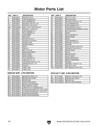

MOTOR 7.5HP 220V/440V 3-PH
$922.60
80-1
MOTOR FAN COVER
$63.60
80-2
MOTOR FAN
$48.85
80-3
MOTOR JUNCTION BOX
$42.70
81
SHAFT
82
Now: PW01
FLAT WASHER 1/2
83
MOTOR BASE
84
KNOB
85
***USE PLW07***
$1.00
86
Now: PB54
HEX BOLT 1/2-20 X 1
87
POINTER
88
Now: PS06
PHLP HD SCR 10-24 X 3/8
89
Now: PB07
HEX BOLT 5/16-18 X 3/4
90
SHAFT GUIDE
91
PLATE
92
MOTOR PLATE
93
SHAFT GEAR
94
BASE GEAR SHAFT
95
METAL HANDWHEEL
96
HANDLE
97
Now: PB31
HEX BOLT 1/4-20 X 1
98
Now: PN05
HEX NUT 1/4-20
Now: PSS24
SET SCREW 10-32 X 3/16
Now: PSS53
SET SCREW 3/8-16 X 1
Now: PSS09
SET SCREW 3/8-16 X 1/2
ADJ HANDLE 1/2" - 12
