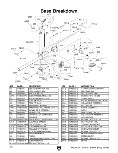

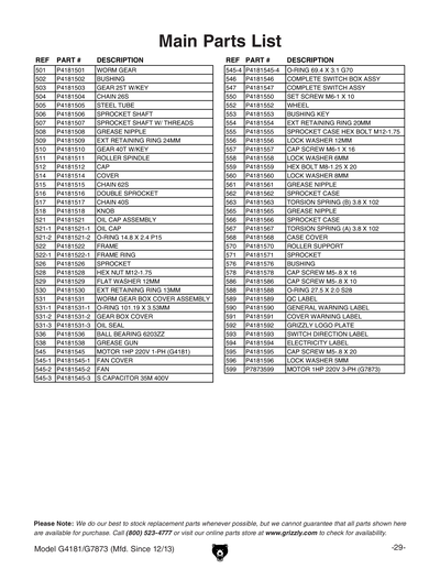

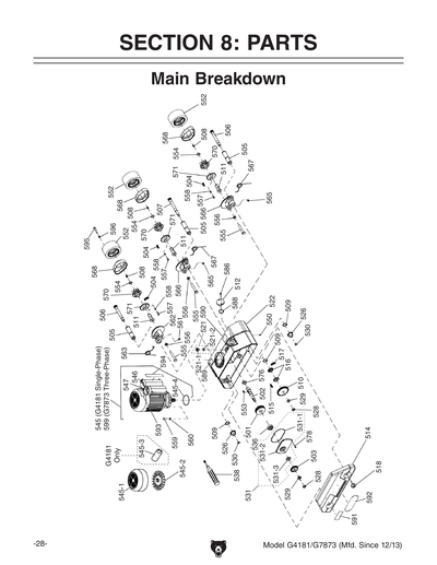

Parts for G7873 1 HP 4-Speed 3-Roller Power Feeder, 3-Phase
Parts Diagrams for G7873 - 1 HP 4-Speed 3-Roller Power Feeder, 3-Phase
Parts List for Parts for G7873 1 HP 4-Speed 3-Roller Power Feeder, 3-Phase
MOTOR 1HP 220V 3-PH
***USE P1096170-1***
1A
SPROCKET CASE KIT RIGHT
1A-1
GREASE NIPPLE M6 X 1.0
1A-2
SPROCKET CASE
1A-3
SPRING 38 X 11.4
1A-4
CASE COVER
$1.60
2A
SPROCKET CASE KIT LEFT
2A-1
2A-2
SPROCKET CASE
2A-3
SPRING 3.8 X 102
2A-4
CASE COVER
$1.60
3A
ROLLER SUPPORT KIT
3A-1
ROLLER SUPPORTER
$15.25
3A-2
SPROCKET
$11.80
3A-3
Now: PW03M
FLAT WASHER 6MM
3A-4
CAP SCREW M6-1 X 16
3A-5
LOCK WASHER 8MM
3A-6
CAP SCREW M8-1.25 X 40
4A
CHAIN KIT 26S
$45.35
5A
TUBE KIT
5A-1
TUBE
$28.20
5A-2
Now: PR17M
EXT RETAINING RING 26MM
6A
SPROCKET SHAFT KIT
6A-1
SPROCKET SHAFT
$40.00
6A-2
Now: PR47M
EXT RETAINING RING 13MM
7A
SPROCKET SHAFT KIT
7A-1
SPROCKET SHAFT
$41.15
7A-2
Now: PW01
FLAT WASHER 1/2
7A-3
Now: PN09M
HEX NUT M12-1.75
8A
SHAFT KIT
$16.70
8A-1
8A-2
ROLLER SPINDLE
8A-3
LOCK WASHER 12MM
8A-4
SHAFT
18A
KNOB BOLT M6-1 X 30
21A
OIL CAP ASSEMBLY
21A-1
OIL CAP
21A-2
O RING 11.8 X 2.4 P12
22A
FRAME KIT MODEL 34/38
$472.15
22A-1
FRAME
$470.70
22A-2
BUSHING
22A-3
SET SCREW M6-1 X 10
26A
TRANSMISSION KIT
$62.25
26A-1
SPROCKET 12T X 3/8"
26A-2
CHAIN 62S
$15.25
26A-3
DOUBLE SPROCKET/KEY 12T X 3/8
26A-4
CHAIN 40S
$10.10
28A
WORM GEAR SHAFT KIT-50HZ
$122.00
28A-1
WORM GEAR SHAFT
28A-2
Now: PW01
FLAT WASHER 1/2
28A-3
Now: PN09M
HEX NUT M12-1.75
31A
WORM GEAR BOX COVER KIT
31A-1
WORM GEAR BOX COVER O-RING 101.19 X 3.53
31A-2
WORM GEAR BOX COVER
31A-3
OIL SEAL
31A-4
CAP SCREW M5-.8 X 16
32A
WORM GEAR SHAFT KIT 60HZ
32A-1
WORM GEAR SHAFT
$67.00
32A-2
Now: PW01
FLAT WASHER 1/2
32A-3
Now: PN09M
HEX NUT M12-1.75
35A
GEAR KIT 25T/40T
35A-1
GEAR 25T W/KEY
$24.75
35A-2
GEAR 40T W/KEY
$43.15
36A
O-RING
38A
GREASE GUN
45A
*DISCD*MOTOR 1 HP/WORM SHAFT
45A-1
MOTOR 1HP 220V 3-PH
45A-10
MOTOR 1HP 220V 3-PH
45A-11
MOTOR 1HP 220V 3-PH
45A-2
MOTOR 1HP 220V 3-PH
45A-3
MOTOR 1HP 220V 3-PH
45A-4
MOTOR 1HP 220V 3-PH
45A-5
MOTOR 1HP 220V 3-PH
45A-6
MOTOR 1HP 220V 3-PH
45A-7
MOTOR 1HP 220V 3-PH
45A-8
MOTOR 1HP 220V 3-PH
45A-9
MOTOR 1HP 220V 3-PH
45A1
MOTOR 1HP 220V 3-PH
45A3
MOTOR 1HP 220V 3-PH
46A
***USE P1096170-2***
46A-1
46A-2
46A-3
46A-4
46A-5
47A
SWITCH
501
WORM GEAR
502
BUSHING
503
GEAR 25T
504
CHAIN 26S
505
STEEL TUBE
506
SPROCKET SHAFT
507
SPROCKET SHAFT W/THREADS
508
GREASE NIPPLE
509
Now: PR58M
EXT RETAINING RING 24MM
510
GEAR 40T
511
***USE P1096125***
512
COVER
514
COVER
515
CHAIN 62S
516
DOUBLE SPROCKET
517
CHAIN 40S
518
KNOB
521
OIL CAP ASSEMBLY
521-1
OIL CAP
521-2
O-RING 14.8 X 2.4 P15
522
FRAME
526
SPROCKET
528
Now: PN09M
HEX NUT M12-1.75
529
Now: PW06M
FLAT WASHER 12MM
530
Now: PR47M
531
WORM GEAR BOX COVER ASSEMBLY
531-1
O-RING 101.19 X 3.53MM
531-2
GEAR BOX COVER
531-3
OIL SEAL
536
BALL BEARING 6203ZZ
538
GREASE GUN
545-1
FAN COVER
545-2
FAN
545-4
O-RING 69.4 X 3.1 G70
546
547
SWITCH
550
SET SCREW M6-1 X 10
552
Now: G4182
Extra Roller for G4181 & G7873
553
KEY 6 X 6 X 18
554
Now: PR09M
EXT RETAINING RING 20MM
555
SPROCKET CASE HEX BOLT M12-1.75
556
LOCK WASHER 12MM
557
CAP SCREW M6-1 X 16
558
LOCK WASHER 6MM
559
Now: PB09M
HEX BOLT M8-1.25 X 20
560
LOCK WASHER 8MM
561
GREASE NIPPLE
562
SPROCKET CASE
563
TORSION SPRING 3.8 X 102
565
GREASE NIPPLE
566
SPROCKET CASE
567
568
CASE COVER
570
ROLLER SUPPORT
571
SPROCKET
576
BUSHING
578
586
CAP SCREW M5-.8 X 10
588
O-RING 27.5 X 2.0 S28
589
QC LABEL
590
GENERAL WARNING LABEL
591
COVER WARNING LABEL
592
Now: H4608
Oblong Nameplate-Mini
593
SWITCH DIRECTION LABEL
594
ELECTRICITY 1.4W X 1.2H
595
CAP SCREW M5-.8 X 20
596
LOCK WASHER 5MM
599
***USE P1096045A3***
$498.40
601
SET SCREW M8-1.25 X 20
602
LOCK WASHER 8MM
603
Now: PN03M
HEX NUT M8-1.25
6203
BALL BEARING 6203ZZ
623
OVER ARM 720MM V1
623V2
OVER ARM 720MM V2.12.13
627
RACK 650MM
629
SET SCREW M8-1.25 X 12
634
ROLL PIN 6 X 22
635
ROLL PIN 6 X 36
636
HANDWHEEL W/HANDLE V1
636A
HANDWHEEL ASSEMBLY
636V2
***USE P1095079A-1***
649
SWIVEL CONE
649A
SWIVEL CONE ASSEMBLY
650
MOTOR CLAMP CONNECTOR
651
T-HANDLE
657
676
VERTICAL COLUMN ASSEMBLY
676-1
VERTICAL COLUMN 560MM V1
676-1V2
***SEE EXT. DESCRIPTION***
676-2
ELEVATING KEY 450 X 8
676-3
676-4
678
ELEVATING BRACKET ASSEMBLY
678-1
***USE P1096214***
678-2
Now: PB43M
HEX BOLT M12-1.75 X 75
678-2V2
Now: PB43M
678-3
Now: PW06M
FLAT WASHER 12MM
678-4
T-HANDLE W/THREADS
678-5
INT TOOTH WASHER 12MM
680
PINION
680A
***USE P109580A***
681
OVER ARM CONE ASSY V1
681-1
OVER ARM CONE
681-2
STANDOFF-HEX V1
681-2V2
SHOULDER STUD
681-3
T-HANDLE W/HOLE FOR PIN
681-4
ROLL PIN 6 X 22
681-5
Now: PW04M
FLAT WASHER 10MM
681-6
Now: PB73M
HEX BOLT M10-1.5 X 50
681-7
STRAIN RELIEF TYPE-6 ST
681V2
OVER ARM CONE ASSY V2.12.13
684
ELEVATING SCREW M19-4 X 380
685
COLUMN CAP V1
685A
COLUMN CAP ASSEMBLY
686
ELEVATION HANDLE ARM 130L
686A
CRANK ASSEMBLY
687
HANDLE M10-1.5 X 70
698
BASE ASSEMBLY
698-1
COLUMN BASE
698-2
Now: PB43M
698-2V2
Now: PB43M
698-3
Now: PW06M
FLAT WASHER 12MM
698-4
T-HANDLE W/THREADS
698-5
698-6
LOCK WASHER 12MM
698-7
Now: PB33M
HEX BOLT M12-1.75 X 50
698A
COLUMN BASE ASSEMBLY
699
MOTOR CLAMP ASSEMBLY
699-1
MOTOR CLAMP
699-2
Now: PB22M
HEX BOLT M8-1.25 X 50
699-4
LEVER
72A
COVER KIT
$5.50
72A-1
O-RING
$1.60
72A-2
COVER
$3.65
72A-3
76A
VERTICAL COLUMN KIT
$135.25
76A-1
VERTICAL COLUMN
$127.75
76A-2
76A-3
76A-4
77A
OVER ARM KIT
$174.20
77A-1
OVER ARM
$100.90
77A-2
RACK
$44.10
77A-3
79A
HANDWHEEL ASSEMBLY
79A-1
HANDWHEEL
$17.25
79A-2
ROLL PIN 6 X 36
80A
PINION KIT
80A-1
PINION
80A-3
80A-4
LOCK WASHER 8MM
80A-5
Now: PN03M
HEX NUT M8-1.25
82A
82A-1
SWIVEL CONE
82A-2
STUD-SE M 16-1.5 X 90 30
82A-3
T-HANDLE
82A-4
ROLL PIN 6 X 22
83A
83A-1
MOTOR CLAMP
83A-2
Now: PB22M
83A-4
T-HANDLE W/THREADS
84A
85A
COLUMN CAPE KIT
85A-1
COLUMN CAPE
$28.20
85A-2
COLUMN CAPE KIT
85A-3
86A
HANDWHEEL KIT
$26.00
86A-1
*DISCD*HANDWHEEL
86A-2
ROLL PIN 6 X 36
86A-3
*DISCD*HANDWHEEL
87A
HANDLE M10-P1.5 X 70L
90A
BASE KIT
$86.00
90A-1
COLUMN BASE
90A-2
STUD-FT M12-1.75 X 70
$1.60
90A-3
Now: PW01
FLAT WASHER 1/2
90A-4
T-HANDLE W/THREADS
91A
91A-1
ELEVATING BRACKET
$160.45
91A-2
THREADED ROD M12-1.75 X 70
91A-3
Now: PW01
FLAT WASHER 1/2
91A-4
T-HANDLE W/THREADS
92A
OVER ARM CONE KIT
$103.85
92A-1
OVER ARM CONE
$52.35
92A-2
SHOULDER STUD
92A-3
HANDLE ASSEMBLY
$14.10
92A-4
ROLL PIN 6 X 22
92A-5
Now: PW04M
FLAT WASHER 10MM
92A-6
Now: PB73M
99A-4
LEVER
