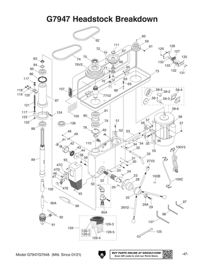

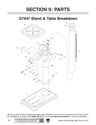

Parts for G7948 20" Floor Drill Press
Parts Diagrams for G7948 - 20" Floor Drill Press
Parts List for Parts for G7948 20" Floor Drill Press

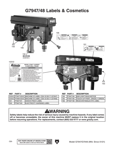

HEX WRENCH 5MM
191
READ-ENTANGLE-EYE LABEL
193
ELECTRICITY 0.7W X 0.6H
194
60W LIGHT BULB NOTICE
195
N/S GRIZZLY GREEN G1023S
196
SHOCK PINCH WARNING LABEL
