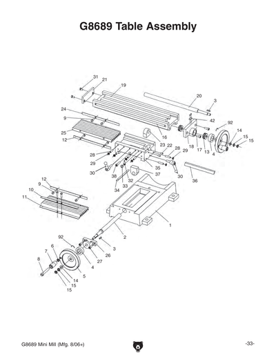

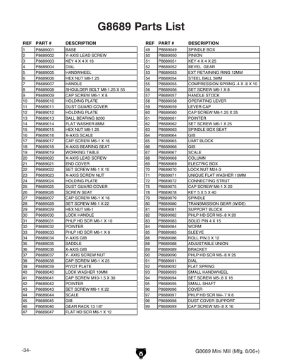

BASE
$62.60
Y-AXIS LEAD SCREW
$12.25
2-1
Now: PK37M
KEY 4 X 4 X 16
Now: PK37M
KEY 4 X 4 X 16
DIAL
$9.65
HANDWHEEL
$14.40
Now: PN03M
HEX NUT M8-1.25
KNOB
$3.25
PHLP HD SCR M8-1.25 X 55 SLOTTED
CAP SCREW M6-1 X 8
HOLDING PLATE
$1.90
DUST GUARD COVER
$6.50
HOLDING PLATE
$1.90
BALL BEARING 8200
$9.65
Now: PW01M
FLAT WASHER 8MM
Now: PN03M
HEX NUT M8-1.25
X-AXIS SCALE
$2.60
CAP SCREW M6-1 X 16
17-1
*DISCD*SCREW M6 X 10
X-AXIS BEARING SEAT
$7.20
WORKING TABLE
$81.45
X-AXIS LEAD SCREW
$9.75
20A
X-AXIX LEADSCREW W/NUT
END COVER
$2.60
CAP SCREW M6-1 X 10
X-AXIS SCREW NUT
$18.70
HOLDING PLATE
$1.90
DUST GUARD COVER
SCREW SEAT
$16.95
CAP SCREW M6-1 X 16
SET SCREW M6-1 X 22
Now: PN01M
HEX NUT M6-1
HANDLE
Now: PS68M
PHLP HD SCR M6-1 X 10
POINTER
$1.90
Now: PS03M
PHLP HD SCR M6-1 X 8
Y-AXIS GIB
$2.45
SADDLE
$39.20
X-AXIS GIB
$1.90
Y-AXIS SCREW NUT
$16.95
CAP SCREW M6-1 X 25
PIVOT PLATE
$17.25
39-1
SHAFT
$1.90
39-2
Now: PK70M
KEY 8 X 8 X 12
Now: PW04M
FLAT WASHER 10MM
40-1
Now: PW04M
FLAT WASHER 10MM
CAP SCREW M10-1.5 X 30
POINTER
$1.90
DOG PT SET SCR M6-1 X 22
$1.90
SCALE
$1.90
45
$1.90
46
GEAR RACK 13-1/8"
$12.25
CAP SCREW M6-1 X 16
48
NAME PLATE

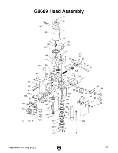

49
SPINDLE BOX
$84.50
49A
COMPLETE HEAD ASSY
$178.25
50
PINION
$8.00
51
Now: PK30M
KEY 4 X 4 X 25
52
BEVEL GEAR
$9.75
53
Now: PR03M
EXT RETAINING RING 12MM
54
STEEL BALL 5MM
55
SPRING .4 X .8 X 10
$1.90
56
SET SCREW M6-1 X 8
57
HANDLE STOCK
$15.60
58
OPERATING LEVER
59
LEVER CAP
60
CAP SCREW M8-1.25 X 25

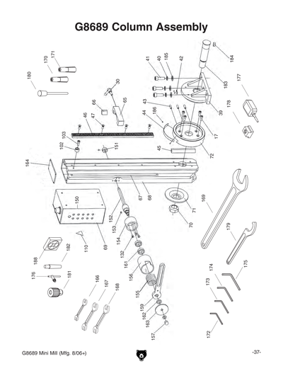

61
POINTER
62
63
SPINDLE BOX SEAT
$35.95
64
$1.90
65
LIMIT BLOCK
$9.75
66
$1.90
67
SCALE
$2.60
68
COLUMN
$142.35
69
ELECTRIC BOX
$12.25
69-1
ELECTRICAL BOX ASSY
$246.15
70
LOCK NUT M24-3
$1.90
71
FLAT WASHER M10
$3.25
72
CONNECTING STRUT
$15.50
73
*DISCD*CONNECTING BOARD
74
PITMAN SHAFT
$2.05
75
CAP SCREW M6-1 X 20
76
CONNECTING BLOCK
$2.05
77
CUSHIONING CYLINDER
$88.10
78
Now: PK02M
KEY 5 X 5 X 40
79
SPINDLE
$31.95
80
TRANSMISSION GEAR WIDE
$8.35
81
SUPPORT BLOCK
$15.50
82
Now: PS06M
PHLP HD SCR M5-.8 X 20
83
ROLL PIN 4 X 14
84
WORM
$5.45
85
SLEEVE
$5.75
86
STEEL PIN 3 X 11
$1.90
87
STEEL PIN 3 X 14
$1.90
88
ADJUSTABLE UNION
$4.00
89
BRACKET
$2.60
90
CAP SCREW M5-.8 X 25
91
DIAL
$5.75
92
FLAT SPRING
$1.90
93
SMALL HANDWHEEL
$10.10
94
CONE SET SCREW M5-.8 X 16
$1.90
95
SMALL SHAFT
$6.50
96
COVER
$1.90
97
Now: PS17M
PHLP HD SCR M4-.7 X 6
98
DUST COVER SUPPORT
$1.90
99
CAP SCREW M5-.8 X 16

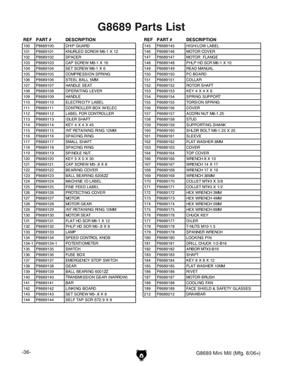

100
CHIP GUARD
$8.60
KNURLED SCREW M6-1 X 12
$2.60
SPACER
$1.90
CAP SCREW M6-1 X 16
SET SCREW M6-1 X 6
COMPRESSION SPRING
$1.90
106
STEEL BALL 5MM
107
HANDLE SEAT
$5.10
108
OPERATING LEVER
$1.90
109
HANDLE
$1.90
110
ELECTRICITY 1.4W X 1.2H
111
CONTROLLER BOX W/ELECTRICAL
$59.70
111-1
CONTROL BOX GROMET
$1.90
111-2
CONTROLLER BOX COVER
$5.45
111-3
EMPTY CONTROLLER BOX
$13.35
112
CONTROLLER BOX LABEL
$1.90
113
IDLER SHAFT
$5.75
114
Now: PK53M
KEY 3 X 3 X 45
115
Now: PR03M
116
SPACING RING
$1.90
117
BAR
118
SPACING RING
$5.75
119
SPINDLE NUT
$3.25
120
Now: PK34M
KEY 5 X 5 X 20
121
CAP SCREW M5-.8 X 8
122
BEARING COVER
$1.90
123
BALL BEARING 6206ZZ
124
MACHINE ID LABEL
125
FINE FEED LABEL
$1.25
126
PROTECTING COVER
$2.20
127
MOTOR 3/4HP 110V 1-PH
$197.10
127-1
COOLING FAN
$30.60
127-2
MOTOR BRUSH CAP
$2.60
127-3
MOTOR BRUSHES
$7.20
127A
*DISCD*MOTOR BRUSH
128
MOTOR GEAR
$10.40
129
Now: PR16M
EXT RETAINING RING 9MM
130
MOTOR SEAT
$12.25
131
FLAT HD SCR M6-1 X 12
132
Now: PS09M
PHLP HD SCR M5-.8 X 10
133
LAMP
$2.60
134
SPEED CONTROL KNOB
$1.90
134-1
POTENTIOMETER
$6.50
135
SWITCH
$15.50
136
FUSE BOX
$2.45
137
E-STOP BUTTON KEDU 02A1131
138
GEAR 30T
138A
Now: PK65M
KEY 4 X 4 X 8
139
BALL BEARING 6001ZZ
140
TRANSMISSION GEAR NARROW
$6.50
141
$2.90
142
LINKING BOARD
$5.10
143
SET SCREW M5-.8 X 8
144
SELF TAP SCR ST2.9 X 8
$1.90
145
HIGH/LOW LABEL
$1.25
146
MOTOR COVER
$1.90
146-1
*DISCD*SCREW
147
MOTOR FLANGE
$7.20
148
Now: PS68M
149
SAFETY GLASSES LABEL
$1.25
150
PC BOARD
$177.95
150-1
YELLOW LAMP
$2.20
151
COLLAR
$7.20
152
ROTOR SHAFT
$12.25
153
Now: PK72M
KEY 4 X 4 X 6
154
SPRING SUPPORT
$9.00
155
TORSION SPRING
$4.35
156
COVER
$4.85
157
Now: PN18M
ACORN NUT M8-1.25
158
STANDOFF-HEX MF
$5.10
159
SUPPORTING SHANK
$7.60
160
SHLDR BOLT M8-1.25 X 25
$4.35
161
SLEEVE
$5.45
162
Now: PR49M
INT RETAINING RING 12MM
163
COVER
$1.90
164
TOP COVER
$1.90
165
Now: PS12M
PHLP HD SCR M3-.5 X 6
166
WRENCH 8 X 10MM OPEN-ENDS
167
WRENCH 14 X 17MM OPEN-ENDS
168
WRENCH 17 X 19MM OPEN-ENDS
169
WRENCH 36MM
$14.40
170
COLLET MT#3 X 3/8
$30.95
171
COLLET MT#3 X 1/2
$30.95
172
HEX WRENCH 3MM
173
HEX WRENCH 4MM
174
HEX WRENCH 5MM
175
HEX WRENCH 6MM
176
DRL CHK KEY 7.92MM TH 11T SD-16.2MM
$3.25
177
OILER
$2.20
178
T-NUTS M10-1.5
$4.70
179
SPANNER WRENCH
$9.75
180
LOCK PIN
$2.90
181
DRILL CHUCK 1/2-B16
$64.00
182
DRILL CHUCK ARBOR MT3 X JT33, 110MM L
$9.40
183
SHAFT
$23.40
184
Now: PK70M
KEY 8 X 8 X 12
185
Now: PW04M
FLAT WASHER 10MM
186
RIVET 2 X 4MM NAMEPLATE, ALUMINUM
187
MOTOR BRUSH 2 PIECE SET
$6.50
188
COOLING FAN
$11.90
189
FACE SHIELD & SAFETY GLASSES 1.5W X 2.5H
200
PC BOARD
201
GREAT WRENCH 36
$14.40
202
DRILL CHUCK W/SHANK
$64.00
202A
DRILL CHUCK W/O SHANK
$51.20
203
OIL CAN
204
FIXING PIN
$2.30
205
HEX WRENCH
$2.90
206
SOCKET HEAD WRENCH
$2.90
207
DOUBLE END WRENCH
$9.75
208
DRILL CHUCK KEY
$11.90
209
HANDLE
$1.90
210
T-NUT 3/8-16
$3.35
210A
T-NUT M8-1.25
$1.90
211
FUSE
$1.90
212
DRAWBAR
$23.40
213
COLLET MT#3 X 3/8
214
COLLET MT#3 X 1/2
215
*DISCD*COOLING FAN
216
POWER INDICATOR LIGHT NHC 220V ORG
217
PLUG W/LINE
218
GREY WIRE CONDUIT
$3.25
219
CONTROL BOX GROMMET
$1.90
220
TRANSFORMER BOARD
$11.20
221
