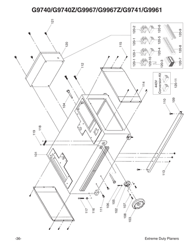

TENSIONER REPAIR KIT
CABINET 20" MODEL
SPEED CHANGE NUT 1 3/8"-16
HANDWHEEL
SLIP BOLT M20 - 2.5 X 20
Now: PW06
FLAT WASHER 1/4
106
CAP SCREW 1/4-20 X 1-1/2
107
LOCK WASHER 8MM
108
Now: PB07M
HEX BOLT M8-1.25 X 25
109
MOTOR MOUNT
110
Now: PB01M
HEX BOLT M10-1.5 X 30
111
Now: PB25M
HEX BOLT M12-1.75 X 25
112
Now: PB24M
HEX BOLT M12-1.75 X 45
113
Now: PN02M
HEX NUT M10-1.5
114
CABINET DOOR
115
Now: PS26M
PHLP HD SCR M6-1 X 20
116
Now: PW02
FLAT WASHER 3/8
117
Now: PB60
HEX BOLT 3/8-16 X 3
118
SPEED CHANGE LEVER
119
RIVET 3 X 40
120

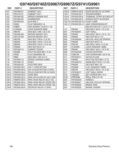

ELECTRIC BOX V1
120-1
*DISCD*CONTACTOR TECO CN-11 V1
120-10
FUSE 3A
120-11
CONVERSION KIT 440V RHN-10 V2.07.07
120-11A
120-11V2
440V CONVERSION KIT V2.07.12
120-12
120-12V2
CONTACTOR TECO CU-11 3A1A V2.05.08
120-13
CONTACTOR TECO CU-16 3A1B
120-14
STAR-DELTA TIMER TRD-N
120-1V2
CONTACTOR TECO CU-11 3A1B V2.05.08
120-2
CONTACTOR 110V CN-18 TECO
120-2V2
CONTACTOR TECO CU-16 3A1A V2.07.12
120-3
FUSE HOLDER
120-4
*DISCD*OL RELAY TECO RHN-10 1.8-2.7A V2.
120-4A
120-4V3
OL RELAY RHU-10 1.8-2.5A V3.01.11
120-5
OL RELAY TECO RHN-10 2.4-4A V2.06.07
120-5A
120-5V3
OL RELAY TECO RHU-10 2.9-4.0A V3.01.11
120-6
RELAY 7.5HP 5/25A EOCR-SP-20-220 TECO
120-6V2
OL RELAY TECO RHU-10 11.3-16A V2.07.12
120-7
TRANSFORMER 110VA 220V-110V
120-8
TERMINAL STRIP 26 CIRCUIT
120-8V2
TERMINAL BAR 29-POST V2.07.12
120-9
WIRING DUCT WITH COVER
120-9V2
WIRING DUCT W/COVER V2.07.12
121
Now: PB49M
HEX BOLT M12-1.75 X 20

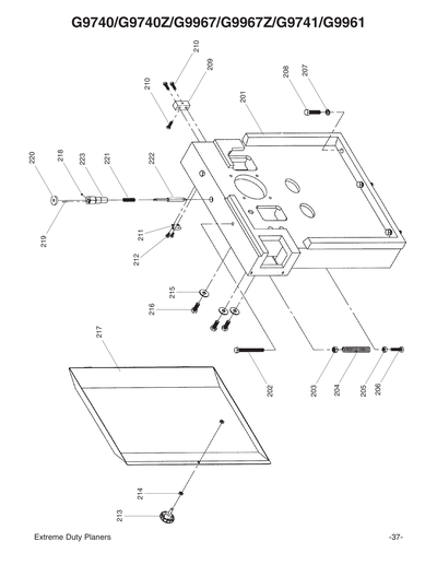

201
WALL LEFT
202
Now: PB76M
HEX BOLT M12-1.75 X 110
203
Now: PN09M
HEX NUT M12-1.75
204
HELICAL ROLLER SPRING 19.5 X 109MM
205
Now: PN02M
HEX NUT M10-1.5
206
Now: PB31M
HEX BOLT M10-1.5 X 40
207
LOCK WASHER 12MM
208
Now: PB33M
HEX BOLT M12-1.75 X 50
209
COVER SUPPORT 7/2 X 52
210
CAP SCREW M8-1.25 X 25
211
CATCH PLATE
212
Now: PS68M
PHLP HD SCR M6-1 X 10
213
KNOB BOLT M10-1.5 X 20
214
Now: PN03M
HEX NUT M8-1.25
215
Now: PW06M
FLAT WASHER 12MM
216
Now: PB27M
HEX BOLT M12-1.75 X 30
217
WALL DOOR LEFT
218
SET SCREW M6-1 X 6
219
ROLL PIN 3 X 18
220
HANDLE ASSEMBLY
221
HELICAL PULLEY SPRING 11 X 46MM
222
BRAKE ROD
223
BRAKE CASING

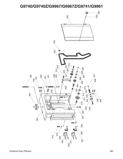

301
WALL RIGHT
302
Now: PN09M
HEX NUT M12-1.75
303
Now: PN04
HEX NUT 5/8-11
304
SPROCKET SHAFT
305
SPROCKET
306
BALL BEARING 6201ZZ
307
Now: PR29M
INT RETAINING RING 32MM
308
Now: PW01M
FLAT WASHER 8MM
309
CAP SCREW M8-1.25 X 10
310
SPROCKET SHAFT
311
SPROCKET
312
BALL BEARING 6203ZZ
313
Now: PR18M
EXT RETAINING RING 17MM
314
Now: PR23M
INT RETAINING RING 40MM
315
SPROCKET PLATE
316
CAP SCREW M12-1.75 X 50
317
BEARING WASHER 12.7X23MM
318
Now: PLW07
LOCK WASHER 1/2
319
Now: PB33M
320
Now: PB76M
321
322
Now: PN02M
HEX NUT M10-1.5
323
SET SCREW M10-1.5 X 23
324
Now: PB31M
325
*DISCD*HANDWHEEL V1.09.03
326
CATCH PLATE
327
Now: PS68M
328
KNOB BOLT M8-1.25 X 20
329
Now: PN02M
HEX NUT M10-1.5
330
COVER SUPPORT
331
332
WALL DOOR RIGHT
333
ROLLER CHAIN 5/8 X 3/8" X 106LINK
334
CHAIN CONNECTOR LINK 5/8
335
Now: PS17M
PHLP HD SCR M4-.7 X 6
336
Now: PW05M
FLAT WASHER 4MM
337
LIMIT SWITCH
338
UPPER LIMIT SWITCH PLATE
339
Now: PB08M
HEX BOLT M6-1 X 20
340
Now: PW06
FLAT WASHER 1/4
341
LIMIT SWITCH PLATE LOWER
342
SEAT
343
Now: PB31M
344
Now: PN02M
HEX NUT M10-1.5
345
Now: PW04M
FLAT WASHER 10MM
346
HELICAL SPRING 19 X 110MM
347
CAP SCREW M8-1.25 X 16
348
LOCK WASHER 8MM
349
CAP SCREW M8-1.25 X 40

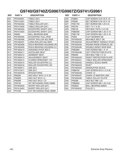

401
TABLE
402
TABLE ROLLER
403
ECCENTRIC SHAFT 20" MODEL 7/8 X 600MM
404
BALL BEARING 6006ZZ
405
ECCENTRIC PULL ROD
406
SHORT ROLLER ADJ BAR 6X25X148MM
407
ROLLER ADJ BAR LONG 6 X 25 X 400MM
408
ROLLER BEARING HOUSING R
409
ROLLER BEARING HOUSING L
410
HOUSING PIVOT BOLT M16-2 X 17MM
411
ACCOLADE SEAT
412
ADAMANT SEAT
413
ADJUSTMENT SEAT
414
CLOSED SPROCKET 1/2 X 14T
415
ROLLER ECCENTRIC L
416
ROLLER ECCENTRIC R
417
GIB 12 X 32 X 160MM
418
SPACER RING
419
Now: PB32M
HEX BOLT M10-1.5 X 25
420
Now: PN02M
HEX NUT M10-1.5
421
Now: PN09M
HEX NUT M12-1.75
422
Now: PR51M
INT RETAINING RING 55MM
423
SHORT ROLLER
424
Now: PR15M
EXT RETAINING RING 30MM
425
CAP SCREW 5/16-18 X 1/4
426
Now: PSS08
SET SCREW 5/16-18 X 1/2
427
SET SCREW M8-1.25 X 6
428
Now: PK27M
KEY 7 X 7 X 25
429
Now: PB31M
430
431
432
Now: PW02
FLAT WASHER 3/8
433
MOVABLE BOLT 3/8-16 X 40MM
434
ADJUSTMENT HANDLE STUD
435
ROUND KNOB FEMALE 3/8 X 34
436
DOUBLE SIDED IRON BAR
437
CAP SCREW M6-1 X 12
438
PROTECTION PLATE 1/2 X 1/2 X 375MM LEFT
439
Now: PB02M
HEX BOLT M6-1 X 12
440
PROTECTION PLATE RIGHT
441
TABLE ROLLER SPROCKET 5/8-13 X 25 X 30
442
HANDLE SCALE MARK
443
RIVET 2.2 X 6
444
GRADUATED SCALE
445
CAP SCREW M10-1.5 X 20
446
CHAIN 1/2 X 425 X 120MM
447
CHAIN 1/2 MASTER LINK
448
TABLE PULLEY PLATE M8-1.25
449
Now: PN03M
HEX NUT M8-1.25
450
CAP SCREW M8-1.25 X 65
451
Now: G3845
Bearing - 22mm x 8mm
452
PULLEY W/HEX NUT M8 X 12

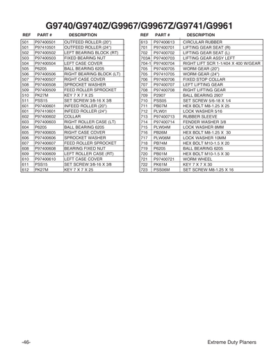

501
OUTFEED ROLLER
502
BEARING BLOCK LEFT
503
FIXED BEARING NUT M25-16
504
CASE COVER LEFT
505
BALL BEARING 6205ZZ
506
BEARING BLOCK LT RIGHT
507
CASE COVER RIGHT
508
SPROCKET WASHER 25.5X11.5MM
509
FEED ROLLER SPROCKET
510
Now: PK27M
KEY 7 X 7 X 25
511
Now: PSS15
SET SCREW 3/8-16 X 3/8

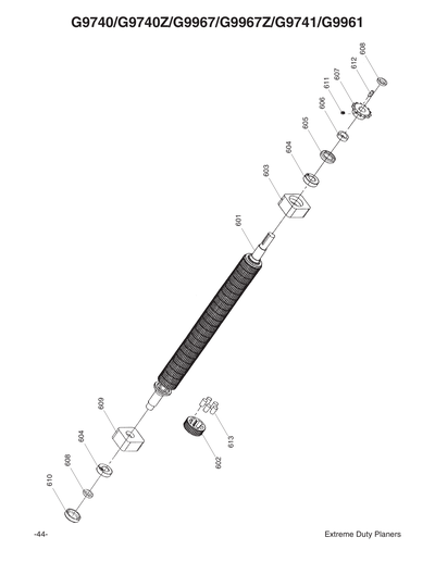

601
INFEED ROLLER 42 X 732MM
602
COLLAR
603
FOLLER CASE LT RIGHT
604
BALL BEARING 6205ZZ
605
CASE COVER RIGHT
606
607
608
BEARING FIXED NUT M25-16
609
ROLLER CASE LEFT
610
CASE COVER LEFT
611
Now: PSS15
612
Now: PK27M
KEY 7 X 7 X 25
613
CIRCULAR RUBBER
701
LIFTING GEAR SEAT RIGHT
702
LIFTING GEAR SEAT LEFT
703
LIFTING GEAR ASSY LEFT
704
LIFT SCREW LONG 1-1/4 - 4 X 400
705
WORM GEAR
706
FIXED STOP COLLAR
707
708
RIGHT LIFT SCR 1-1/4-4 X 400 W/ GEAR
709
Now: P2907
THRUST BEARING 2907
710
Now: PSS05
SET SCREW 5/16-18 X 1/4
711
Now: PB07M
712
Now: PLW01
LOCK WASHER 5/16
713
RUBBER SLEEVE
714
FENDER WASHER 8MM
715
LOCK WASHER 8MM
716
Now: PB26M
HEX BOLT M8-1.25 X 30
717
LOCK WASHER 10MM
718
Now: PB74M
HEX BOLT M10-1.5 X 20
719
BALL BEARING 6205ZZ
720
Now: PB01M
721
WORM WHEEL
722
Now: PK28M
KEY 7 X 7 X 29
723
SET SCREW M8-1.25 X 16

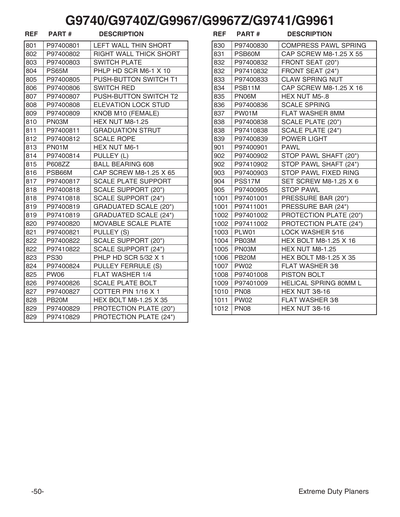

801
WALL LEFT THIN SHORT
802
WALL THICK SHORT RIGHT
803
SWITCH PLATE
804
Now: PS68M
805
PUSH BUTTON SWITCH T1 RED
806
SWITCH RED
807
PUSH BUTTON SWITCH T2 GREEN
808
ELEVATION LOCK STUD
809
KNOB M10 FEMALE
810
Now: PN03M
HEX NUT M8-1.25
811
GRADUATION STRUT
812
SCALE ROPE
813
Now: PN01M
HEX NUT M6-1
814
PULLEY L
815
Now: G3845
816
817
SCALE PLATE SUPPORT
818
SCALE SUPPORT
819
GRADUATED SCALE
820
MOVABLE SCALE PLATE
821
PULLEY
822
SCALE SUPPORT
823
Now: PS30
PHLP HD SCR 8-32 X 1
824
PULLEY FERRULE S
825
Now: PW06
FLAT WASHER 1/4
826
SCALE PLATE BOLT M16-1 X 16
827
COTTER PIN 5/32 X 1-1/2"
828
Now: PB20M
HEX BOLT M8-1.25 X 35
829
PROTECTION PLATE
830
COMPRESS PAWL SPRING 2MM
831
CAP SCREW M8-1.25 X 55
832
FRONT SEAT
833
CLAW SPRING NUT M8-1.25
834
835
Now: PN06M
HEX NUT M5-.8
836
SCALE SPRING HELICAL D6 X 385MM
837
Now: PW01M
FLAT WASHER 8MM
838
SCALE PLATE
839

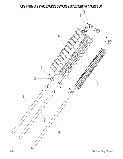

POWER INDICATOR LIGHT 22MM RED
901
PAWL
902
STOP PAWL SHAFT
903
STOP PAWL FIXED RING M8X6MM
904
905
STOP PAWL

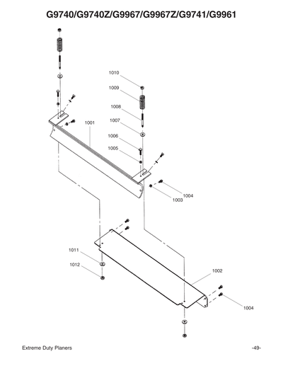

1001
PRESSURE BAR 26-13/16" V1.09.03
$158.45
1001A
PRESSURE BAR 22-7/8" V2.06.07
1002
PROTECTION PLATE V1
1002A
PROTECTION PLATE V2.06.07
1003
Now: PLW01
LOCK WASHER 5/16
1003A
Now: PW04M
FLAT WASHER 10MM
1004
Now: PB03M
HEX BOLT M8-1.25 X 16
1004A
CAP SCREW M10-1.5 X 30
1005
Now: PN03M
HEX NUT M8-1.25
1005A
Now: PN09M
HEX NUT M12-1.75
1006
Now: PB20M
1006A
CAP SCREW M8-1.25 X 12
1007
Now: PW02
FLAT WASHER 3/8
1007A
SPRING CAP V2.06.07
1008
PISTON BOLT M8-1.25 X 90MM V1
1008A
CAP SCREW M10-1.5 X 12
1009
HELICAL SPRING 70MML V1
1009A
COMPRESSION SPRING 51MM V2.06.07
CABINET 20" MODEL
1010
Now: PN08
HEX NUT 3/8-16
1010A
PRESSURE BAR BRACKET V2.06.07
1011
Now: PW02
FLAT WASHER 3/8
1011A
CAP SCREW M10-1.5 X 40
1012
Now: PN08
HEX NUT 3/8-16
1012A
SET SCREW M12-1.75 X 40
1013
CAP SCREW M10-1.5 X 25
1014

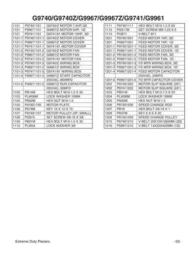

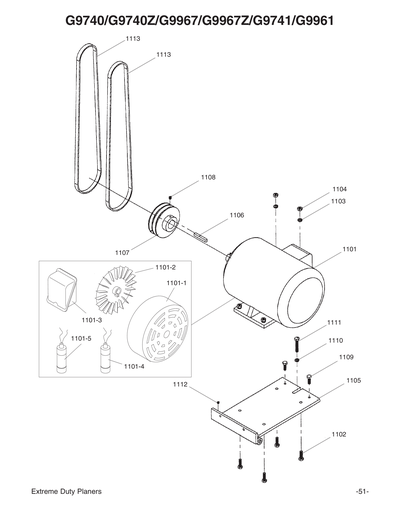

MOTOR 7.5HP 220V/440V 3-PH
1101-1
MOTOR COVER
1101-2
MOTOR FAN
1101-3
WIRING BOX
1102
Now: PB14M
HEX BOLT M10-1.5 X 35
1103
LOCK WASHER 10MM
1104
LOCK WASHER 10MM
1105
MOTOR PLATE
1106
Now: PK78M
KEY 10 X 8 X 70
1107
MOTOR PULLEY 1" 2PC SMALL
1108
Now: PSS15
1109
Now: PB01M
111
1110
Now: PLW04
LOCK WASHER 3/8
1111
Now: PB34M
HEX BOLT M10-1.5 X 60
1112
1113
Now: PVB71
V-BELT B71
112
Now: PW06
FLAT WASHER 1/4
113
HANDWHEEL
114
Now: PN02M
HEX NUT M10-1.5
115
SPEED CHANGE LEVER
116
RIVET 3 X 40
117
ELECTRIC BOX V1
118
Now: PB49M
119
CABINET DOOR
120
Now: PS26M

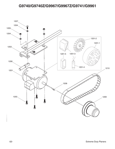

1201
FEED MOTOR 1HP 220V 3-PH
1201-1
FEED MOTOR COVER 3PH
1201-2
FEED MOTOR FAN 3PH
1201-3
FEED MOTOR WIRING BOX 3PH
1202
MOTOR SLIP SQUARE
1203
Now: PB01M
1204
LOCK WASHER 10MM
1205
Now: PN02M
HEX NUT M10-1.5
1206
SPEED CHANGE ROD
1207
Now: PB18
HEX BOLT 3/8-16 X 1
1208
Now: PK07M
KEY 6 X 6 X 20
1209
*DISCD*SPEED CHANGE PULLEY V1
121
Now: PB24M
1210
*DISCD*V-BELT 20 X 10 X 1085MM V1.09.03

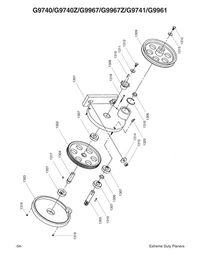

1301
TRANSMISSION BOX
1302
TRANSMISSION BOX GEAR
1303
TRANSMISSION BOX CAP
1304
TRANSMISSION SHAFT
1305
GEAR SHAFT
1306
BEARING SPACER
1307
BALL BEARING 6204ZZ
1308
TRANSMISSION SPROCKET 5/8X20X30MML 9T
1309
TRANNY PULLEY 8" 3PH
1310
Now: PK34M
KEY 5 X 5 X 20
1311
Now: PW02
FLAT WASHER 3/8
1312
Now: PB03M
1313
Now: PW07
FLAT WASHER 5/16
1314
Now: PW01
FLAT WASHER 1/2
1315
Now: PN09M
HEX NUT M12-1.75
1316
Now: PR25M
INT RETAINING RING 47MM
1317
Now: PK06M
KEY 5 X 5 X 10
1318
Now: PB77M
HEX BOLT M4-.7 X 45
1319
Now: PN04M
HEX NUT M4-.7
1320
GREASE FITTING 1/8-27

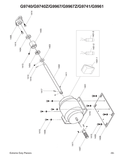

1401
ELEV MOTOR 1/2HP 220V 3-PH
1401-1
ELEV MOTOR WIRING BOX 3 PHASE
1402
SHORT ELEVATION ROD
1403
ELEVATION COLLAR
1404
BALL BEARING 6004ZZ
1405
BEARING HOUSING
1406
PILLON BLOCK BEARING UCLF 204-20
1407
LIFTING MOTOR WORM
1408
LIFTING MOTOR PLATE
1409
Now: PLW01
LOCK WASHER 5/16
1410
Now: PB03M
1411
SET SCREW M10-1.5 X 12
1412
SET SCREW M8-1.25 X 8
1413
1414
Now: PB09M
HEX BOLT M8-1.25 X 20
1415
ROLL PIN 4 X 15
1416
ROLL PIN 4 X 25
1417
ROLL PIN 4 X 20

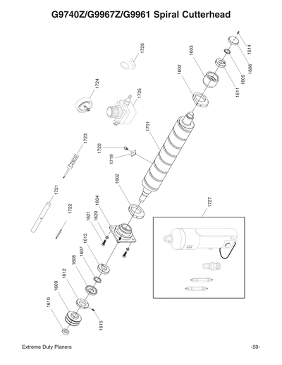

1601
*DISCD*SPIRAL CUTTERHEAD
1602
PISTON RING
1603
1608
KNOB M10 FEMALE
1622
1623
LOCK WASHER 10MM
1624
FENDER WASHER 10MM
1625
GREASE FITTING 1/8" PT 45-DEG
1626
KEY 10 X 8 X 45
1701
***SEE EXT. DESCRIPTION***
1701V2
CUTTERHEAD 20" SPIRAL V2.10.13
$2,843.70
1702
PISTON RING
1703
SMALL CUTTERHEAD CASE W/COVER
1703-1
SET SCREW M10-1.5 X 15
1704
LARGE CUTTERHEAD CASE W/ COVER
1705
NUT M35-1.5
1706
1707
SPANNER NUT M40-1.5P
1708
1709
CUTTERHEAD PULLEY V1
1709V2
CUTTERHEAD PULLEY V2.10.13
1710
CUTTERHEAD PULLEY NUT M30-1.5
1711
BALL BEARING 6208ZZ
1712
CUTTERHEAD STOP PLATE
1713
BALL BEARING 6208ZZ
1714
1715
Now: PSS18
SET SCREW 5/16-18 X 3/4
1716
*DISCD*CUTTER KNOB
1717
LOCK WASHER 12MM
1718
Now: PB75M
HEX BOLT M12-1.75 X 35
1719
Now: H7319
Indexable Carbide Inserts - 14 x 14 x 2mm, 10-Pk.
1720
FLAT HD TORX T20 M6-1 X 15
1721
CHEATER BAR FOR T-20 BIT
$23.90
1722
T-20 TORX BIT
$7.25
1723
T-20 TORX DRIVER
$7.00
1724
PRESSURE GAUGE
$10.35
1725
REDUCING VALVE FOR KIT
1726
L-BRACKET
1727
AIR SCREWDRIVER KIT
$150.05
