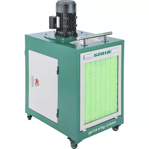

If grinding, buffing, or polishing metals is your thing, our G0818 Metal Dust Collector will help you keep your shop safe and clean. This sturdy steel-constructed dust collector features a removable chip clean-out drawer for easy disposal of metal chips and collected particulate. Incoming air from the dual 4" inlets must pass through a three-stage filtering system that includes a 30-micron stainless steel filter, 5-micron active carbon filter, and a pleated 1-micron filter. An industrial-duty 220V, 1.5 HP direct-drive motor powers the 12-3/4" aluminum impeller for a whopping 755 CFM! Also features locking caster wheels and a push handle for easy placement and positioning.
  • Motor: 1.5 HP, 220V, single-phase, TEFC, 3450 RPM, 8.2A
  • Airflow capacity: 755 CFM
  • First-stage filter: 30 microns, stainless
  • Second-stage filter: 5 microns, active carbon
  • Third-stage filter: 1 micron, pleated micro-filter
  • Filter size: 15-3/4" x 19-3/4" x 1-3/16"
  • Impeller size: 12-3/4"
  • Overall size: 39"W x 20"D x 41-1/2"H
  • Main inlet size: 6"
  • Number of Adapter Inlets: 2
  • Adapter inlet size: 4"
  • Sound rating: 85 dB
  • Chip clean-out drawer capacity: 1 cu. ft.
  • Approximate shipping weight: 309 lb.
Features:
  • 3-Stage filter system
  • Aluminum impeller
  • Toggle ON/OFF switch
  • Dual 4" inlets for two machines
  • Built in an ISO 9001 Factory
