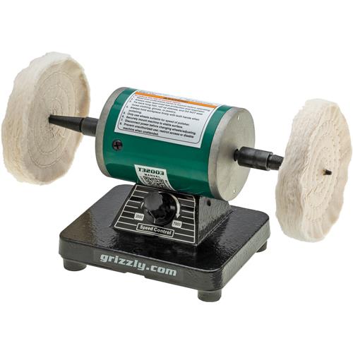

T32003 1/4 HP Variable-Speed Mini Benchtop Polisher
With our new lineup of pint-sized hobby machines, sometimes smaller is better.
The T32003 1/4 HP Variable-Speed Mini Benchtop Polisher is perfect for artisans creating smaller pieces without the need of taking up a ton of space.
Whether you're making model train sets, jewelry, doll furniture, or custom ammunition, these space-saving, lightweight machines are just what you need for your delicate work.
The T32003 comes with dual cotton buffing wheels that you add polishing compounds to for buffing and polishing your workpiece.
The tapered spindle sleeves on each end of the spindle make it easy to swap out different buffing wheels for different projects.
Their tapered design also allows for a range of bore thicknesses up to 3/8", especially useful for polishing wheels that may break down after a lot of polishing use.
When the dial is turned clockwise, the variable-speed motor increases the buffing wheels from 2000 RPM to a maximum 7000 RPM.
Even though you may be able to install hard polishing wheels on this machine, the T32003 was designed for delicate polishing and is not suitable for hard polishing.
The 1/4 HP Variable-Speed Mini Benchtop Polisher may be small but is definitely not a toy.
Like all of the Grizzly polish machines, the T32003 comes with a 1-year warranty covering parts and assuring the unit is free from factory defects. (Consumables are not covered by the warranty.)
The T32003 manual was written by our U.S. based Documentation Department and is packed with useful information. The complete and easy-to-read manual makes it easier to assemble and maintain your polisher.
The Grizzly Customer Service and Technical Support Teams are U.S. based. Parts for the polisher may be available online and shipped from the Grizzly parts warehouse in Springfield, MO.
  • Motor: 1/4 HP, 110V, single-phase, 1.8A
  • Max wheel diameter: 4-1/2"
  • Max wheel thickness: 2"
  • Max wheel bore: 3/8"
  • Spindle speed: 2000–7000 RPM
  • Spindle diameter: 5/16"
  • Tapered Spindle Sleeve Length (Threaded): 2"
  • Tapered Spindle Sleeve Length (Overall): 3"
  • Tapered Spindle Sleeve Diameter: 1/16"–1/2"
  • Tapered Spindle Sleeve Thread Pitch: 20 TPI
  • Overall dimensions: 11" W x 4-1/2" D x 5-1/2" H
  • Approximate shipping weight: 8 lbs.
  • Cast-iron base
  • Dual cotton buffing wheels
  • Two tapered spindle sleeves
  • Variable-speed dial
  • 2mm Hex wrench included
