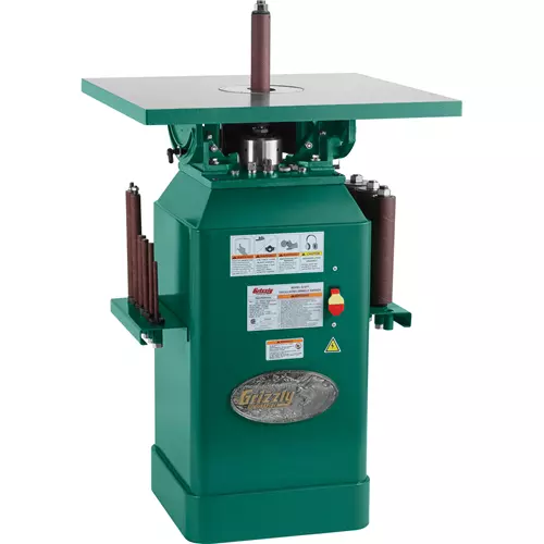

G1071 1 HP Oscillating Spindle Sander
A sander to satisfy the needs of both the professional and serious hobbyist.
The big 25" x 25" table of the G1071 1 HP Oscillating Spindle Sander makes cabinet doors and other large projects a breeze to edge sand.
The solid cast-iron table provides a solid platform for supporting workpieces and can tilt for sanding beveled edges.
The G1071 is powered by a 1 HP motor that spins the spindle at 1725 RPM and oscillates at 72 OPM with a 1-1/2” stroke.
The included variety of interchangeable spindles store on spindle racks attached to the cabinet.
The G1071 manual was written by our U.S.-based Documentation Department is packed with useful information. The complete and easy-to-read manual makes it easier to assemble and maintain your sander.
CSA certified
  • Motor: 1 HP, 120V/240V (prewired for 120V), single-phase, 12A/6A
  • Spindle speed: 1725 RPM
  • Stroke length: 1-1/2"
  • Spindle oscillation: 72 OPM
  • Spindle diameters: 1/4", 3/8", 1/2", 5/8", 3/4", 1", 1-1/2", 2", 3", 4"
  • Spindle length: 5", 6", 9"
  • Table size: 25" x 25"
  • Table tilt: 45° Front, 15° Back
  • Floor-to-table height: 35-1/2"
  • Dust port size: 4"
  • Overall dimensions: 25-1/2" W x 30" D x 45" H
  • Shipping weight: 340 lbs.
  • Features ground-steel table inserts
  • Includes formed and welded steel stand
  • Ten spindle sizes, tapered and threaded
  • 100-grit sleeve for each spindle
  • Built-in 4" dust collection port
  • Lubricated-for-life ball bearings
  • Tilting cast-iron table 45° front and 15° back
