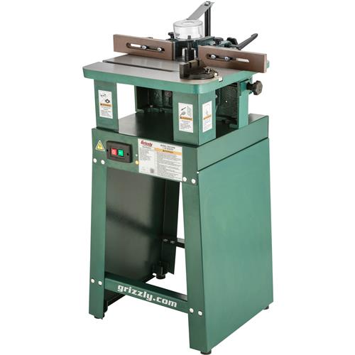

Many times over the years, customers have asked us to produce a quality shaper at a bargain price. That may be impossible for others, but not for Grizzly! Our G0510ZW has plenty of power with its 1 HP motor. Its surface-ground cast-iron table is both durable and slippery-smooth, while the cast-iron fence assembly with MDF facing allows for easy and precise adjustments. But, best of all, this is a real shaper with a 1/2" spindle and it accepts 1/4" and 1/2" router bits! Equipped with a spindle lock and motor reversing switch, the G0510ZW is just like the big boys, so put away your router and start shaping today!
  • Motor size: 1 HP, 110V, single-phase
  • Amps: 9A
  • Table size: 15-1/2" x 17-7/8"
  • Floor to table height: 34-1/4"
  • Table counterbore: 3" dia. x 3/8" deep
  • Spindle travel: 7/8"
  • Spindle diameter: 1/2"
  • Spindle length: 5-1/4"
  • Spindle capacity under nut: 1-9/16"
  • Spindle speed: 11,000 RPM
  • Overall height (including fence): 40"
  • Overall depth: 23"
  • Overall width: 20-1/2"
  • Footprint: 19" x 16-1/2"
  • Approximate shipping weight: 222 lb.
Features:
  • Independently adjustable fence halves
  • Push button ON/OFF switch
  • Includes miter gauge and starting pins
  • Cast-iron body construction
  • Pre-formed steel stand
  • Shielded and permanently lubricated spindle bearings
  • Split cast-iron fence assembly for offset profile shaping
  • Reversing switch
  • Includes 1/4" & 1/2" router bit adapter
