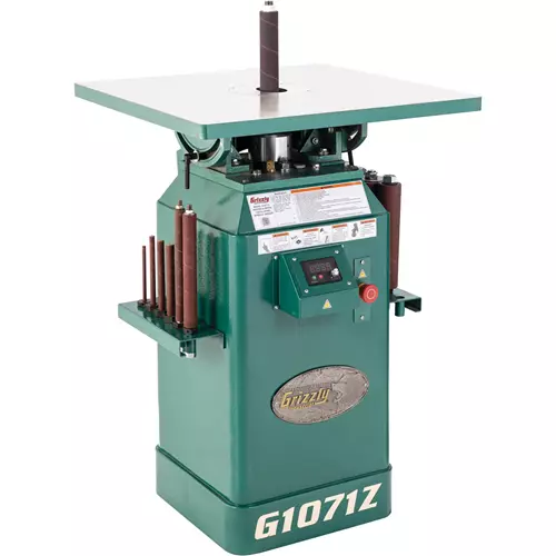

G1071Z 1 HP Variable-Speed Oscillating Spindle Sander
Precision and versatility for woodworking and metalworking.
Achieve professional-level results with exceptional control and burn-free finishes on a wide range of materials, from delicate wood to tough metal.
This sander is built to last, featuring a cast-iron table for stability and a powerful 1 HP motor to handle even the most demanding projects. The Digital Readout (DRO) ensures precise speed adjustments, while the tilting table lets you tackle complex shapes with ease.
Who's this for?
This spindle sander is perfect for woodworkers of all skill levels, from hobbyists to pros. It's also an excellent choice for metalworkers looking for a versatile sanding solution.

  • Digital Readout (DRO): Shows the exact spindle speed for precise adjustments and ensures repeatable settings, taking the guesswork out of achieving consistent sanding results.
  • Variable-Speed Control (900-1800 RPM): Fine-tune sanding for optimal results on a variety of materials, minimizing burn risk and enabling work with delicate pieces or heat-sensitive metals.
  • 1-1/2" Stroke Length: Effectively removes material and smoothly shapes curves with ample stroke length.
  • 72 OPM Spindle Oscillation: Reduces burning and extends abrasive life for cleaner sanding by constantly moving the spindle across the workpiece.
  • Tilting Precision-Ground Cast-Iron Table: Provides a stable work surface and allows for angled sanding for tackling complex shapes.
  • Ten Spindle Sizes (1/4"–4" diameter): Offers exceptional versatility to handle various sanding tasks with a single machine, eliminating the need to switch sanders for different jobs.
  • Required power source: 120V, single-phase, min. 20A circuit
  • Motor: 1 HP, 120V, 3A
  • Spindle speed: 900–1800 RPM
  • Stroke length: 1-1/2"
  • Spindle oscillation: 72 OPM
  • Sanding drum diameters: 1/4", 3/8", 1/2", 5/8", 3/4", 1", 1-1/2", 2", 3", 4"
  • Sanding drum lengths: 5", 6", 9"
  • Table tilt: 45° front, 20° back
  • Dust port: 4"
  • Floor-to-table height: 35-3/4"
  • Overall dimensions: 25-1/2" x 30" x 45"
  • Shipping weight: 300 lbs.
