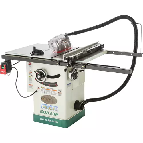

Grizzly G0833P - 10" 2 HP 230V Hybrid Table Saw with Riving Knife, Polar Bear Series
Get the best of both contractor style and cabinet style table saws with this Polar Bear Series™ Hybrid Table Saw. You get the easy to transport weight and size of a high-end contractor saw, but with the dust control and full features of a cabinet saw. Just like our other table saws, this hybrid also has a quick-change blade guard, but with anti-kickback pawls that can be positioned away from the workpiece. The interchangeable riving knife offers protection for operations that require you to remove the blade guard, such as with "non-through" cutting operations. This is a saw that will be the envy in any shop. Also features a serpentine belt/pulley system for quiet operation and more efficient power transfer.
Made in an ISO 9001 Factory
SPECIFICATIONS
  • Motor: 2 HP, 115V/230V*, single-phase, prewired to 230V
  • Amps: 16A at 115V, 8A at 230V
  • Precision-ground cast iron table w/wings: 27"D x 40"W
  • Table height: 34-1/4"
  • Footprint: 20-1/2"L x 19-1/2"W
  • Arbor: 5/8"
  • Arbor speed: 3850 RPM
  • Capacity @ 90°: 3-1/8"
  • Capacity @ 45°: 2-3/16"
  • Rip capacity: 31-1/2" right, 11-3/8" left
  • Overall size: 62"L x 39"W x 47-3/4"H
  • Approximate shipping weight: 416 lbs.
FEATURES
  • White powder-coated paint on cabinet
  • Cabinet mounted trunnions
  • 4" dust port
  • T-slot miter gauge
  • Camlock T-shaped fence with two-position extruded-aluminum face
  • Easy-glide fence system
  • Quick-release riving knife and blade guard assembly
  • Knurled knobs for adjusting fence
  • Includes regular, as well as dado blade table inserts
  • Device on blade guard allows enabling or disabling of anti-kickback pawls
  • Poly-V serpentine belt drive
  • Includes 10" x 40T carbide-tipped saw blade
NOTICE: *115V operation requires part T23999 circuit breaker and wiring procedures that must be completed by an electrician or other qualified service personnel. See Owner's Manual for details.
