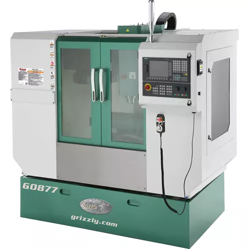

G0877 10" x 31" Enclosed CNC Mill with Auto Tool Changer
If you are producing parts with cycle time as a priority, this is your machine.
The G0877 Enclosed CNC Mill with Auto Tool Changer is packed with features, including a 10-position automatic tool changer and powered pull stud for fast, worry-free tooling changeovers.
With the Siemens® Sinumerik 808D CNC controller, programming is simple. Just hit start and focus on other shop tasks while your mill efficiently handles the job.
The 3 HP motor and smooth servo motors drive ball screws on all axes for the highest degree of accuracy.
Variable spindle speeds from 50 to 10000 RPM and rapid feed rates of up to 400 in./min. gets the job done fast.
A built-in 42-gallon, high flow coolant system helps keep parts cool and improves tool-life.
All of this is wrapped in an easy access enclosed cabinet with large viewing windows.
The G0876 comes with a 1-year warranty which covers parts and assures the unit is free from factory defects. (Consumables are not covered by the warranty.)
Parts for the mill are available online and shipped from the Grizzly parts warehouse in Springfield, MO.
  • Spindle motor: 3 HP, 220V, 3-Phase, 6.4A
  • X- and Y- motors: 1 HP, 2.1A
  • Z- motor: 1.3 HP, 3A
  • Spindle taper: BT30
  • Spindles speeds: Variable, 50–10,000 RPM
  • Spindle to column: 12-1/2"
  • Spindle to table: 18-5/8"
  • Longitudinal travel: 15-5/8"
  • Cross travel: 9"
  • Vertical travel: 15-5/8"
  • Position resolution: +-0.0008"
  • Repeat position resolution: +-0.0005"
  • Tool changer: 10 positions
  • Tool change speed: 6 seconds
  • Max tooling weight: 13 lbs.
  • Table size: 10-1/4" x 31-1/2"
  • Table T-slots: (5) 5/8"
  • Table weight capacity: 330 lbs.
  • Rapid feed rate: 400 in./min.
  • Coolant tank capacity: 42 gallons
  • Footprint: 117" x 88"
  • Overall dimensions: 77" W x 68" D x 87" H
  • Approximate shipping weight: 4200 lbs.
  • Siemens® Sinumerk 808D CNC controller
  • Servo motors with ball screws on all axes
  • Built in pendant/hand controller
  • Powerful 3 HP, 3-phase main motor
  • 50–10000 RPM spindle speeds
  • Easy access to table from three sides
  • Hands-free tool changes with 10-position automatic changer
  • Rapid table speeds of up to 400 in./min.
  • Heavy duty BT30 spindle included
