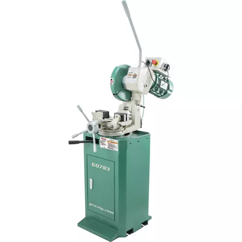

G0783 11" Slow-Speed Cold-Cut Saw
A cold saw perfect for clean, precise, spark-free metal cutting.
Unlike traditional high-speed saws, a cold saw operates at lower speeds for cutting metal without generating excessive heat.
The G0783 offers two blade speeds for a variety of cutting needs. The slower 57 RPM speed setting is most effective for steel alloy (stainless steel) and normal steel applications. The faster 114 RPM speed setting is most effective for aluminum and other non-ferrous metals.
The slow cutting speeds and specially designed tooth geometry minimize heat buildup, resulting in clean, precise, and burr-free cuts. This eliminates the need for additional finishing work.
The G0783 uses an 11" saw blade designed for cutting rectangular, square, and round metal workpieces.
Please note: Blade is not included with saw and must be purchased separately.
The T31822 2/8/55 + 4/12/64 180T Cold Saw Blade and T31823 2/8/55 + 4/12/64 180T Cold Saw Blade are available separately.
This machine features a self-centering vise that provides maximum support, while still providing enough clearance for cutting at a variety of angles. Each vise jaw is independently adjustable left or right to provide proper blade clearance for the cut.
The head and column rotate 90° left or right of center for precise angled cuts. The miter scale shows the angle of the blade and the miter lock lever secures the angle for repeated cuts.
The coolant system keeps the blade and workpiece cool, preventing heat-related damage and ensuring extended blade life.
The feed rate will vary depending upon the type of material being cut, the proper flow of cutting fluid, and the amount of pressure applied by the user.
The G0783 manual was written by our U.S.-based Technical Documentation Department and is packed with useful information. The complete and easy-to-read manual provides full instructions on how to assemble and maintain your bandsaw.
Parts for the cold saw may be available online and shipped from the Grizzly parts warehouse in Springfield, MO.
  • Motor: 2.7 HP/1.9 HP, 220V, 3-phase, 9.1A/6.3A
  • Blade size: 11"
  • Blade arbor diameter: 40mm
  • Blade speed: 57, 114 RPM
  • Cutting capacities:
    • 90° Round: 2-3/8"
    • 90° Square: 2-3/8" x 2-3/8"
    • 90° Rectangular: 2-3/4" x 2-3/8"
    • 45° Round: 2-3/8"
    • 45° Square: 2-3/8" x 2-3/8"
    • 45° Rectangular: 2-3/8" x 2-3/8"
  • Vise jaw height: 2"
  • Vise jaw depth: 4-1/2"
  • Overall dimensions: 18-1/2" W x35" D x 55-1/2" H
  • Approximate shipping weight: 441 lbs.
