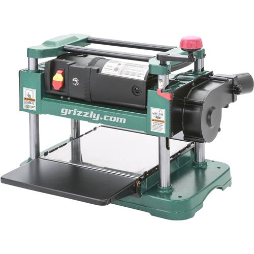

For the ultimate in portability, the Model G0790 is our most compact planer. Weighing in at just 65 lbs., this 12-1/2" planer handles stock up to 4-1/2" thick at a feed rate of 26 FPM. Solid construction, a powerful 2 HP motor, and a small footprint make this an excellent choice for off-site projects or small shops.
ETL Listed meeting CSA C22.2 #71.2-10 and UL 987-8th standards!
  • Motor: 2 HP, 110V, single-phase, 15A
  • Maximum cutting width: 12-1/2"
  • Maximum cutting height: 4-1/2"
  • Maximum cutting depth: 1/16" full width, 1/8" on 6" wide board
  • Feed rate: 26 FPM
  • Number of knives: 2, reversible HSS
  • Knife size: 12-1/2" x 1/2" x 1/16"
  • Cutterhead speed: 8750 RPM
  • Number of cuts per inch: 60
  • Top-mounted return rollers
  • Includes magnetic handles for changing knives
  • Thermal overload protection
  • 2-3/8" dust port
  • Footprint: 22-1/2" x 13"
  • Approximate shipping weight: 72 lbs.
