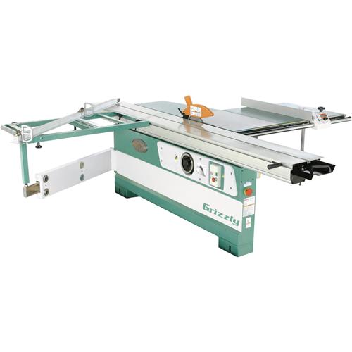

Since the introduction of the our now famous G0501 Sliding Table Saw, we have been asked numerous times if we were going to come out with a smaller version. For those customers, we now offer the G0591 12" Sliding Table Saw packed with features you want in the size you need and at the price you can afford. The fence allows precise and quick adjustments while the silky smooth sliding table makes cutting accurate panels a pleasure. The adjustable width scoring blade puts an end to tearout while the 12" main blade slices through material up to 3 3/4" thick. And, its 5 HP, single-phase motor will work all day long without breaking a sweat. You can now have Sliding Table Saw performance in your shop all at incredibly reasonable price!
Features:
  • Scoring saw blade ensures tear-out free cutting
  • Durable extruded aluminum sliding table
  • Large handle for effortless cutting operations
  • Blade tilts 45 deg. for miter cutting
  • Miter fence can be positioned at 45 deg. right and left
  • Miter fence has two swing stops for repetitive cutting
  • Table extension on right and rear side of main table permits convenient cutting of large panels
  • Rugged construction for maximum stability
  • Precision ground cast iron main table
  • Quick clamp on sliding table
  • Main blade and scoring blade not included
  • Main motor: 5 HP, 220V, single-phase
  • Main blade size: 12"
  • Main blade arbor: 1"
  • Main blade tilt: 0-45 deg.
  • Main blade speed: 4,900 RPM
  • Depth of cut at 90 deg.: 3 11/16"
  • Depth of cut at 45 deg.: 2 3/4"
  • Length of cut: 118"
  • Scoring blade size: 3 1/8" (80mm)
  • Scoring blade arbor: 20mm
  • Scoring blade tilt: 0-45 deg.
  • Sliding table size: 13 3/4" x 118 1/8"
  • Maximum cutting width: 126"
  • Main table dimensions: 33 7/8" x 22 1/16"
  • Approximate shipping weight: 1560 lbs.
