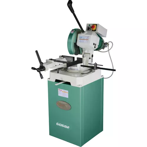

Image for Grizzly G0682 - 12" Slow Speed Cold Cut Saw with Stand
Cold cut saws can produce some of the cleanest and most accurate cuts you can imagine. Along with this, the blade geometry, speed, and optimum feed rate force almost all of the heat generated by the cut into the chip, keeping the workpiece and blade cool. And any residual heat is taken care of by the coolant pump. Our latest machine has the power, speed and capacity needed in a busy shop. Choose 42 RPM for your toughest cuts and 84 RPM for fast through-put on non-ferrous materials. Quick and easy to use – a real “must have”!
  • Motor size: 2.2 HP, 220V, 3-phase, 3450/1725 RPM
  • Blade speed: 42/84 RPM
  • Blade size: 12"
  • Arbor size: 32mm
  • Max. capacity round: 3-7/8"
  • Max. capacity square: 3-1/2"
  • Angle cutting: -45° to +45°
  • Maximum vise opening: 12"
  • Overall dimensions: 41"L x 33"W x 58"H
  • Approximate shipping weight: 440 lbs.
  • Rugged cast iron construction
  • “Spinner” style vise handle with quick release
  • Built in blade coolant system
  • Lock any angle between -45° and +45°
  • Auto-retract blade guard
  • Spring assisted return
  • Safety on and off switch
  • Heavy-duty stand
