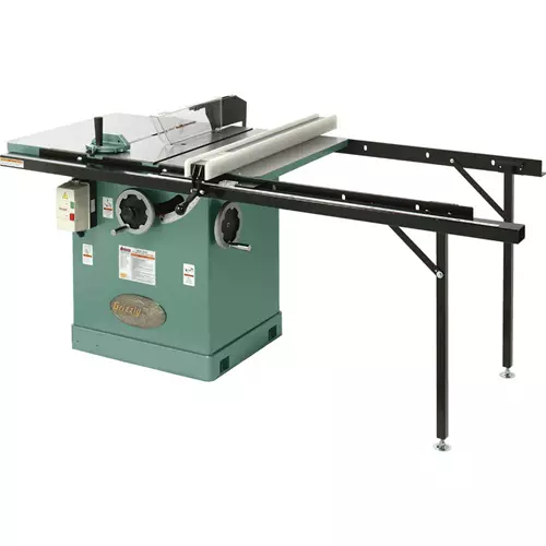

This industrial grade saw can handle the extra big jobs, all day, every day. And don't worry if you're stepping up to this beast from a 10" saw; it includes quick change 5/8" and 1" arbors, so you can keep your old blades. The G5959Z Left Tilting series has all the features you'd expect from a top quality cabinet saw, plus some you'll pay extra for elsewhere. But don't take our word for it - check it out yourself! Other features include: 34-1/2" table height from floor; rim speed of 13,000 SFPM; precision ground cast iron table; 13-1/4" distance from front of table to blade at maximum cut; 18-1/8" distance from front of table to center of blade; table size with wings of 30-1/4" deep x 48" wide; 3/8" x 3/4" T-slots; cast iron miter gauge; 4" dust port; triple v-belt power transfer; clear plastic guard with steel splitter; sloped cabinet floor assists dust collection; dual arbors measuring 5/8" and 1"; heavy-duty cam lever fence; magnetic switch with thermal overload protection; machined collar on arbor; outboard bearing; overall dimensions of 81-1/2" wide x 38-1/2" deep x 39-1/2" high; approximate shipping weight of 635 lbs.
  • Motor: 5 HP, 220V, single-phase, 27 Amps
  • Arbor speed: 4140 RPM
  • Maximum depth of cut and 90 degrees: 4"
  • Maximum depth of cut @ 45 degrees: 2 5/8"
  • Maximum rip capacity: 50"
