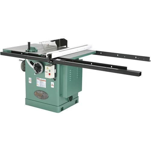

This industrial-grade saw can handle the extra big jobs, all day, every day. And don't worry if you're stepping up to this beast from a 10" saw: It includes both 5/8" and 1" arbors, so you can keep your old blades. The G5959 has all the features you'd expect from a top-quality cabinet saw, plus some you'll pay extra for elsewhere. But don't take our word for it - check it out yourself!
Features:
  • Cast iron trunnions
  • 3/8" x 3/4" T-slots
  • Cast iron miter gauge
  • 4" dust port
  • Power transfer: Triple V-belt
  • Table size w/ wings: 30-1/4" D x 48" W
  • Precision ground cast iron table
  • Clear plastic guard with steel splitter
  • Sloped cabinet floor assists dust collection
  • Dual arbors: 5/8" and 1"
  • Motor cover standard
  • Heavy-duty cam lever fence
  • Machined collar on arbor
  • Outboard bearing
  • 5 HP, 220V, single phase motor
  • Amps: 27
  • Arbor speed: 4140 RPM
  • Rim speed: 13,000 sfpm
  • Maximum depth of cut @ 90°: 4"
  • Maximum depth of cut @ 45°: 2-5/8"
  • Maximum rip capacity: 50"
  • Powder coated paint
  • Distance from front of table to blade at maximum cut: 13-1/4"
  • Distance from front of table to center of blade: 18-1/8"
  • Overall dimensions: 81-1/2"W x 38-1/2"D x 39-1/2"H
  • Shipping dimensions: 48"W x 30"D x 40"H
  • Table height from floor: 34-1/2"
  • Shipping weight approx.: 615 lbs.
