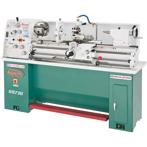

This is the best 13" Lathe we offer and is a dependable machine made for high precision work in a toolroom environment.
Features:
Standard Equipment:
            Features:
- Precision ground V-bed is made of Meehanite casting
 - Headstock gears run in an oil bath and are hardened and precision ground for smooth, quiet and vibration free operation
 - Quick change gear box is fully enclosed and makes thread selection and engagement smooth and fast
 - Feed rod is equipped with an overload clutch for safety
 - Turret micrometer stop allows operator to set absolute stop to carriage for safety and close operations
- Swing over bed: 13"
 - Swing over gap: 19-1/2"
 - Swing over cross slide: 7-1/2"
 - Distance between centers: 40"
 - Spindle size/type: D1-4 camlock
 - Spindle nose taper: MT #4
 - Hole through spindle: 1-3/8"
 - Tailstock barrel taper: MT#4.5
 - Tailstock barrel travel: 4-3/8"
 - Cross slide travel: 7-1/2"
 - Top slide travel: 3-1/2"
 - Number of speeds: 8
 - Speed range: 105-2000 RPM
 - Range of threads (inches): 4-56 TPI
 - Range of threads (metric): 0.4-7 mm
 - Width of bed: 7-1/2"
 - Motor size (Single Phase): 3 H.P.
 - Shipping weight approximate: 1700 lbs.
Standard Equipment:
- 7" 3-Jaw chuck
 - 8" 4-Jaw chuck
 - 10" face plate
 - Steady rest
 - Follow rest
 - Coolant system
 - Full length splash guard
 - Built-in stand
 - Dual inch/metric dials
 - Driving plate
 - Extra 8" D1-4 backplate
 - Centers, center sleeve, service tools, manual and toolbox
