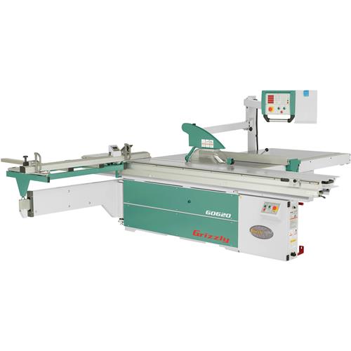

Only Grizzly can bring you a Sliding Table saw with the features found on the finest saws made in the world yet at a fraction of their cost. Set the blade height, blade angle and fence position at the touch of a button with digital accuracy. The sliding table can rip to 126" and crosscut to 118" to handle today's larger sized sheet goods. Fully equipped and ready to start working in your shop today!
Features:
  • Digital control panel for fence, height adjustments, blade tilt and calibration
  • Saw blade guard with 3" dust port
  • Hanging type CNC control panel
  • Adjustable riving knife alignment
  • Electronic scoring blade alignment controls
  • 12" and 14" riving knives included
  • Adjustable scoring blade kerf
  • 90° and 45° clear blade guards with rollers
  • Includes 12" saw blade and 4-3/4" scoring blade
  • Auto rip fence position by CNC controller
  • Crosscut digital display stop
  • 84" long miter fence
  • Rigid crosscut table
  • 5" main dust port
  • Chromed steel rails
  • Cast iron trunnions
  • Main motor: 10HP, 220V/440V, 3-phase
  • Main blade size: 14"
  • Main blade tilt: 0-45°
  • Depth of cut at 90°: 3-15/16"
  • Depth of cut at 45°: 2-3/4"
  • Main blade speed: 3000, 4000, 5000, 6000 RPM
  • Main blade arbor: 1"
  • Scoring motor: 1HP, 220V/440V, 3-phase
  • Scoring blade size: 4-3/4" Scoring blade arbor: 22mm & 7/8"
  • Scoring blade speed: 8000 RPM
  • Scoring blade tilt: 0-45°
  • Sliding table size: 15" x 126"
  • Cutting width: 59"
  • Cutting length: 126"
  • Overall dimensions: 130"W x 146"D x 65"H
  • Approx shipping weight: 2717 lbs.
    440V operation requires purchasing additional components and installation by our technicians. Please call customer service at (570) 546-9663 for more information
