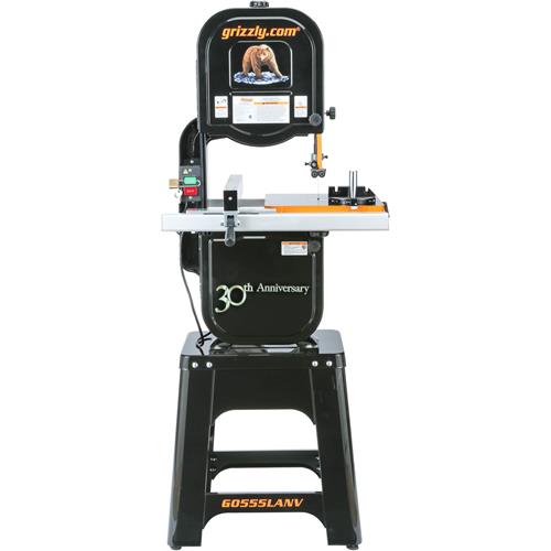

In celebration of our 30th Anniversary, we took two of our most popular saws and created a special edition color scheme that is sure to be the eye candy in workshops and small businesses nationwide. The G0555LANV is the exact same machine as our G0555LX except for our anniversary special edition colors. Grab one quick, these are sure to sell out fast!
The G0555LANV 14" Deluxe Bandsaw has many of the same great specifications and features as our extremely popular G0555, but with the following notable differences:
- Computer-balanced cast-iron wheels
- Sturdy T-shape fence design
CSA certified meeting CSA C22.2 #71.2-10 and UL 987-8th standards!
Features:
- All ball bearing construction
- Cast-iron frame
- Precision-ground cast-iron table
- Computer balanced cast-iron wheels with rubber tires
- 4" dust port
- Upper and lower ball bearing blade guides and thrust bearings
- Open frame stand
- Includes 3/8" blade and miter gauge
- Rack-and-pinion guide post adjustment for upper blade guides
- Motor: 1 HP, 110V/220V, single-phase, TEFC, 1725 RPM, prewired 110V
- Amps: 11A at 110V, 5.5A at 220V
- Table size: 14" x 14" x 1-1/2"
- Table tilt: 45 deg. right, 10 deg. left
- Floor to table height: 43"
- Cutting capacity/throat: 13-1/2"
- Maximum cutting height: 6"
- Blade size: 93-1/2" (1/8" to 3/4" wide)
- Blade speed: 1800, 3100 FPM
- Overall dimensions: 27" wide x 67-1/2" high x 30" deep
- Approximate shipping weight: 247 lbs.
