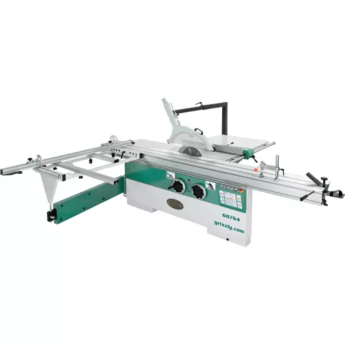

Leave it to Grizzly to offer yet another industrial sized Sliding Table Saw that’s engineered to handle the largest sheet material. A 4-1/8" maximum depth of cut at 90° also handles the thickest material for cross-cutting and ripping. The independently controlled scoring blade eliminates tear-out and two flip stops on the cross-cutting fence maximize production efficiency. The large overhead blade guard is fully adjustable and includes a 2-1/2" dust port, which supplements the 5" cabinet mounted dust port. If you require a large sliding table saw, take a good look at this one!
  • Main motor: 10 HP, 220V/440V*, 3-phase
  • Full load amps: 26A/13A
  • Main blade size: 14"
  • Main blade tilt: 0–45°
  • Depth of cut at 90°: 4-1/8"
  • Depth of cut at 45°: 2-15/16"
  • Main blade speed: 3000, 4000, and 5000 RPM
  • Main blade arbor: 1"
  • Scoring motor: 1 HP, 220V/440V*, 3-phase
  • Scoring blade size: 4-3/4"
  • Scoring blade arbor: 20mm
  • Scoring blade speed: 8000 RPM
  • Scoring blade tilt: 0–45°
  • Sliding table size: 14" x 126"
  • Maximum rip capacity: 51-1/4"
  • Maximum sheet capacity: 124" x 124"
  • Cross cutting length: 124"
  • Overall dimensions: 202" wide x 65" high x 133" deep
  • Approximate shipping weight: 1815 lbs.
Features:
  • Micro-adjustable rip fence
  • Scoring saw blade ensures tear-out free cutting
  • Sliding table on steel ball guide system with heat-treated steel ways
  • Alloy crosscut fence for miter cutting 45° right and left
  • Miter fence has two swing stops for repetitive cutting
  • Safety limit switch for blade cover
  • Adjustable riving knife adjustment
*This machine is prewired for 220V. We can rewire to 440V in a few days’ time for a fee of $325. Please contact Grizzly Technical Support at (570) 546-9663 before placing your order.
