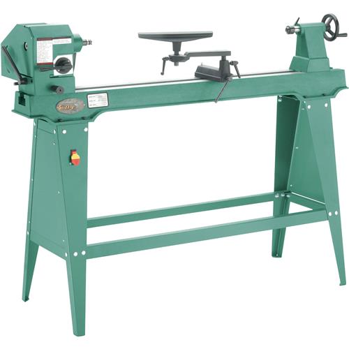

Without a doubt, this 1/2 H.P., all ball bearing lathe beats all the others when it comes to quality and value. It can be used for spindle turning, or the headstock and tool rest can be rotated for convenient faceplate turning. The Model G1067Z offers a full 14" of swing over its precision-ground cast iron bed and 40" between centers - plenty of room for most turning projects. Six speeds, ranging from 600 - 2,100 R.P.M. offers plenty of flexibility so you can maintain maximum variable-speed control. Comes with live center, spur center and faceplate. An extremely versatile machine!
Features
  • 14" swing over bed
  • 40" between centers
  • 1/2 H.P. TEFC motor, 1720 R.P.M., 110V, 8 Amps
  • Precision-ground cast iron bed
  • 6 speeds: 510, 810, 1200, 1630, 2100, and 2800 R.P.M.
  • 0°, 45°, 90°, 135°, 180° headstock rotation
  • Spindle indexes every 15°
  • 6" Faceplate
  • Fully articulated tool rest support
  • 1" x 12 T.P.I. RH spindle
  • M.T. #2 spindle taper
  • Ball bearings in motor and spindle assemblies
  • Pre-formed steel stand
  • Push-button ON/OFF switching
  • Headstock can be locked at any location on bed
  • Shipping weight approx.: 190 lbs.
