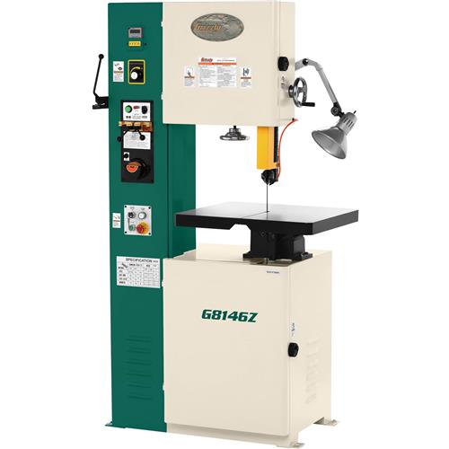

G8146Z 15-3/4" 2 HP VS Vertical Metal-Cutting Bandsaw
Looking for a bandsaw that does it all?
The versatile G8146Z 15-3/4" 2 HP VS Vertical Metal-Cutting Bandsaw is feature-packed with variable-speed control, rack-and-pinion guard, built-in light, with the ability to cut, weld, and grind your own blades.
This type of bandsaw can be used for straight cuts, angular cuts, and curved or contour cuts on aluminum, brass, and tool steel.
Straight cuts are made using workpiece fixtures and with a light, even pressure against the blade. Angular cuts are made with the table and workpiece tilted at an angle other than "0".
When an internal contour cut is to be made, a hole must be drilled in the workpiece. The blade is then cut, fed through the hole in the workpiece, welded together again using the welding station and re-installed on the bandsaw to make the cut.
The welding station can also be used to fabricate new blades and repair broken blades.
The blade is supported by upper and lower tungsten steel blade guides that keep the blade from wandering during the cut.
  • Required power source: 220V, single-phase, min. 15A circuit
  • Main motor: 2 HP, 220V, 3-phase, 6.6A
  • Grinder motor: 1/8 HP, 220V, single-phase, 0.6A
  • Electric welder: 4.2 KVA
  • Power source: 220V, single-phase, 60 Hz
  • Maximum cutting height: 10-1/4"
  • Blade speed: Variable, 105–2100 FPM
  • Blade length range: 133"–136"
  • Blade width range: 1/8"–3/4"
  • Table size: 21-11/16" x 23-5/8"
  • Table tilt: 45° right, 15° left
  • Floor to table height: 38"
  • Overall dimensions: 36-3/8" W x 19-1/8" D x 71-7/8" H
  • Approximate shipping weight: 694 lbs.
  • Variable speeds range from105–2100 FPM
  • Blade welding station includes cutter, welder, annealer, and grinder
  • Left, right table tilting control
  • Upper and lower blade guides
  • Integrated chip pan
  • Work light
  • Wheel brush
