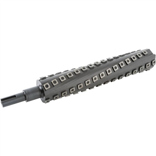

Grizzly T27695 15" Helical Cutterhead
Upgrade your 15"cutterhead and finish at the same time.
The T27695 15" Helical Cutterhead provides quiet operation, better dust collection and dramatic improvement in finish over straight-knife cutterheads.
Each indexable carbide insert can be rotated up to three times to expose a new sharp edge. No more changing and resetting knives every time a blade gets dull.
The indexable carbide inserts are positioned along a helical pattern with the cutting edges at a slight angle to the workpiece for a shearing action that leaves a glassy smooth cut even on the toughest of woods.
The T27695 comes with all 75 inserts on the cutterhead.
The T27695 installation instructions were written by our U.S. based Technical Documentation Department and is packed with useful information.
The complete and easy-to-read instructions makes it easier to change the cutterhead on your planer.
We strongly recommend replacing the old cutterhead bearings at the time of installation. The T27695 uses (1) 6204ZZ bearing and (1) 6205ZZ bearing.
Parts and accessories for the cutterhead may be available online and shipped from the Grizzly parts warehouse in Springfield, MO.
FITS:
- Grizzly G0453 15" Planers
- Grizzly G1021 series manufactured since 1995
- Grizzly G0550
- Grizzly G0551
- Grizzly G0453 series (Not compatible with G0453W/G0453ZW)
- Bridgewood BW15P
- Delta DC380
- Delta 22/675
- Delta 22/780
- Delta 22/785
- Delta 22-790X
- Delta 22-790X5
- General 30-115
- General 30-125CE
- Jet JWP-15CS
- Powermatic 1791209-15
- Powermatic 1791210-15S
- Shop Fox W1692
- Shop Fox W1723
- Shop Fox W1724
- Shop Fox W1742
- Shop Fox W1742S
- Sunhill CT-38B
- Sunhill CT-382
- Woodtek 855266
- Maximum width of cut: 15"
- Cutterhead diameter: 76 mm
- Number of indexable carbide inserts: 75
