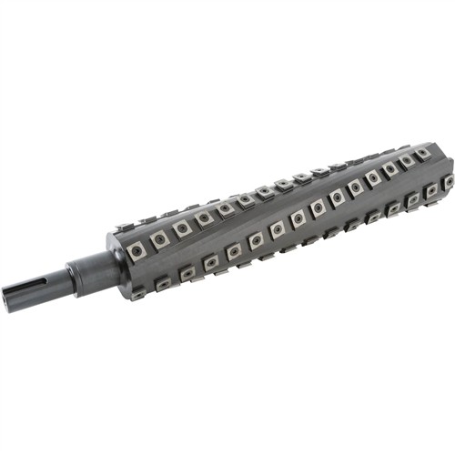

Grizzly T27695 15" Helical Cutterhead
Upgrade your 15"cutterhead and finish at the same time.
The T27695 15" Helical Cutterhead provides quiet operation, better dust collection and dramatic improvement in finish over straight-knife cutterheads.
Each indexable carbide insert can be rotated up to three times to expose a new sharp edge. No more changing and resetting knives every time a blade gets dull.
The indexable carbide inserts are positioned along a helical pattern with the cutting edges at a slight angle to the workpiece for a shearing action that leaves a glassy smooth cut even on the toughest of woods.
The T27695 comes with all 75 inserts on the cutterhead.
The T27695 installation instructions were written by our U.S. based Technical Documentation Department and is packed with useful information.
The complete and easy-to-read instructions makes it easier to change the cutterhead on your planer.
We strongly recommend replacing the old cutterhead bearings at the time of installation. The T27695 uses (1) 6204ZZ bearing and (1) 6205ZZ bearing.

  • Maximum width of cut: 15"
  • Cutterhead diameter: 76 mm
  • Number of indexable carbide inserts: 75
