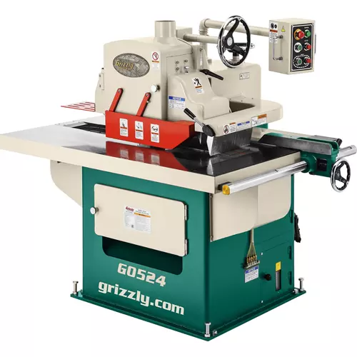

Grizzly G0524 - 15 HP 3-Phase Straight-Line Rip Saw
5.0 (1)
$14,050.00
G0524 15 HP 3-Phase Straight Line Rip Saw
An amazing saw producing quality rip cuts for your shop.
Designed for the professional shop, the Grizzly G0524 Straight Line Rip Saw features 3-7/8" depth of cut capacity, a powerful 15 HP main motor and a 2 HP feed motor.
The extra-long infeed table and rip fence were designed for handling large workpieces.
Anti-kickback fingers prevent the workpiece from being ejected out of the saw towards the operator.
The smooth-action conveyor feed system has a variable feed speed rate of 30-112 FPM.
The G0524 is supplied with 4 auxiliary rollers that can be attached when rip cutting workpieces shorter than 8". These auxiliary rollers can be left on the machine when cutting longer boards; however, the maximum thickness cutting capacity of the saw is reduced to 2-1/4".
The H5749 Optional Laser Guide w/Arm is available for purchase separately.
The G0524 manual was written by our U.S. based Technical Documentation Department and is packed with useful information. The complete and easy-to-read manual makes it easier to assemble and maintain your saw.
*This machine is prewired for 220V. We can rewire to 440V in a few days’ time for a fee. Please contact Grizzly Technical Support at (570) 546-9663 before placing your order.
  • Main motor: 15 HP, 220V/440V* (prewired 240V), 3-phase, 42A/21A
  • Feed motor: 2 HP, 6.2A/3.1A
  • Minimum circuit size: 70A @ 220V, 35A @ 440V
  • Saw blade diameter: 10"–12"
  • Maximum cutting height: 3-7/8"
  • Maximum cutting width: 18"
  • Minimum cutting length: 8"
  • Feed speed: Variable, 30–112 FPM
  • Arbor diameter: 1"
  • Spindle speed: 4500 RPM
  • Overall table dimensions: 53" x 37"
  • Floor to table height: 32-1/4"
  • Dust port size: 4"
  • Footprint: 35" x 35"
  • Overall dimensions: 43-1/2" W x 61-1/2" D x 80-1/2" H
  • Approximate shipping weight: 2243 lbs.
  • Variable-speed conveyor
  • Dual-bearing driveline for conveyor table
  • Exclusive 6" wide chain feeding conveyor table for smooth operation
  • Extra-long infeed table and rip fence
  • Dual-spindle lock prevents spindle drop while running
  • Auto-lube system is adjustable for precise lube intervals
  • Built-in anti-kickback fingers
  • Heavy-duty pressure rollers
We offer U.S.-based customer service and technical support to get your questions answered and help keep your equipment running in top condition. And to ensure your satisfaction, the G0524 comes with a 1-year warranty.
