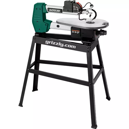

G0938 18" Scroll Saw with Stand
A scroll saw with plenty of throat to cut most intricate designs.
Recognized as the best scroll saw for intermediate users on bobvila.com! Product testers on Bob website agree; the G0938 18" Variable-Speed Scroll Saw with Stand is the perfect choice for woodworkers looking to expand their skills and create unique patterns with ease. It cuts smoothly, quietly and accurately using either pin-end or plain-end blades.
The cam-action scroll saw blade release allows for quick tool-free blade changes. Also, it helps makes those difficult time-consuming interior cuts quick and easy. Get in and out of these important cuts in only seconds. Featuring variable-speed control, the G0938 allows you the flexibility to dial in your cutting speed between 450–1500 SPM based on the hardness of your workpiece.
The cast aluminum tilting table has a built-in easy-to-read bevel scale for tilting capability from -15° to 45°. To keep your workpiece visible and free of debris, the G0938 has a built-in flexible LED work light and dust blower.
CSA certified
  • Motor: 1/9 HP, 120V, single-phase, 1.6A
  • Depth of throat: 18"
  • Maximum cut thickness: 2-1/4"
  • Maximum cutting width: 18"
  • Blade size and type: 5", pin-end or plain-end
  • Blade stroke: 3/4"
  • Blade speed: Variable, 450–1500 SPM
  • Table size: 12-5/8" x 20"
  • Table tilt: -15° to 45°
  • Dust port: 1-1/2"
  • Overall dimensions: 35" W x 24" D x 45" H
  • Approximate shipping weight: 53 lbs.
  • Tilting table with easy-to-read bevel scale
  • Cam-action blade release for quick tool-free blade changes
  • Compatible with pin-end and plain-end blades
  • Adjustable gooseneck LED work light
  • Flexible sawdust blower
  • Sturdy metal stand
Need help? We offer U.S.-based customer service and technical support to get your questions answered and help keep your equipment running in top condition. And to ensure your satisfaction, the G0938 comes with a 1-year warranty.
