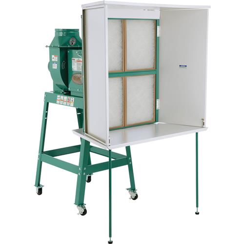

Finally an affordable means for spraying finishes in your shop. This powerful unit features foldable deflectors, a 3-stage filter system, lockable casters and a powder coated finish. Heavy-duty construction throughout means years of trouble free service. Requires ducting to outside air, after which with proper use, will remove overspray, keeping your shop cleaner and safer while improving the finish on your projects.
  • Motor: 2 HP Baldor®, 115V/230V, single-phase, 22A/11A, 1725 RPM, explosion proof, UL listed
  • Filter system: 3-stage, 30–10–5 microns
  • Air capacity: 1220 CFM
  • Outlet size: 10"
  • Impeller: 10-1/2" aluminum
  • Primary and secondary stage filter size: 15-1/2" W x 19-1/2" H x 1-3/4" D
  • Third stage filter size: 15-1/2" W x 15-1/2" H x 1-3/4" D
  • Number of primary and secondary filters: 4 each
  • Number of third stage filters: 1
  • Working area: 34" W x 42" H x 19" D
  • Overall dimensions: 48" W x 77" H x 68" D
  • Approximate shipping weight: 341 lbs.
