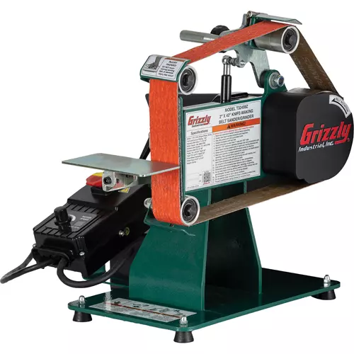

Need the flexibility to grind knives both horizontally and vertically, but your shop is 110V single-phase? With this machine, you can do both. Designed for the entry-level knife maker, this versatile knife-making belt sander/grinder is lightweight and portable. Keep it on your workbench or easily store it when not in use.
Features and Benefits:
  • Variable-Speed 1 HP motor: Dial in the perfect belt speed whether you're shaping or sharpening.
  • Versatile Vertical Grinding: Pivot the sanding frame 90° to precisely shape the tip, edge, heel, and tang of your knife.
  • Safe Horizontal Grinding: Utilize the full platen surface for efficient and safe shaping of the knife spine.
  • Precise Control: Tool rest swivels, moves in and out, and tilts -5° to 120°.
  • Easy Belt Changes: Quick-release lever with gas-strut tensioner.
  • Durable Construction: The graphite-coated platen minimizes friction and heat build-up.
It comes with a 2" x 42" 60-grit ceramic belt, with additional belts available.
Knife makers, turn your hobby into a side hustle with the dual-function T32459Z Belt Sander/Grinder!
  • Motor: 1 HP, 110V, single-phase, 7.8A
  • Belt size: 2" x 42" and 2" x 48"
  • Belt speed: Variable, 131–4974 FPM
  • Belt tilt: 0–90°
  • Platen size: 5-1/2" W x 2-1/4" D
  • Platen type: Graphite coated
  • Tool rest size: 6" W x 3" D
  • Tool rest tilt: -5°–120°
  • Footprint: 14" x 9-1/2"
  • Overall dimensions: 13-1/2" W x 21" D x 16-1/2" H
  • Approximate shipping weight: 42 lbs.
