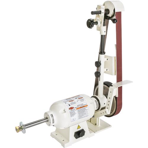

Very popular with knife makers, the W1843 Knife Belt Sander/Buffer features a cool-running 2" x 72" abrasive belt and an extended buffing wheel shaft for full-access buffing or sanding.
The sanding belt can be utilized along the platen, above the platen for free forming, or against the 10" rubber-faced drive wheel. A full range of replacement belts are available.
The belt arm tilts from 0-90°. The belt can be changed in seconds with a quick-release mechanism. Belt tracking adjustment is as easy as rotating the adjustment knob.
The left arbor accepts buffing wheels, sanding drums, or flap wheels up to a 10" diameter with a 5/8" bore.
The infinitely adjustable tool holder provides a stable platform for consistent results.
Ideal for sharpening extra-long lathe turning gouges and chisels too!

  • Motor: 1 HP, 110V, single-phase, 14A
  • Belt size: 2" x 72"
  • Belt speed: 4500 FPM
  • Belt arm tilt: 0-90°
  • Left arbor: 1" x 8" extension with 5/8" arbor
  • Footprint: 10" x 16-1/2"
  • Height with belt arm horizontal: 11-1/2"
  • Height with belt arm vertical: 37"
  • Overall dimensions: 39" W x 29-1/2" D x 37" H
  • Approximate shipping weight: 113 lbs.
  • Two-year warranty!!
  • Left arbor accepts buffing wheels, sanding drums, or flap wheels
  • Belt arm tilts from 0-90°
  • Cast-iron body
  • All ball bearing construction
