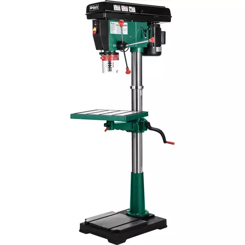

G7948 20" Floor Drill Press
Power and precision not found from a benchtop or hand drill.
Floor standing drill presses offer increased power and capacity that you can’t find in a benchtop version. The 1-1/2" HP motor of the G7948 20" Floor Drill Press smoothly powers the twelve spindle speeds ranging from 180 - 3240 RPM.
Prewired for 120V, the G7948 can plug into a standard 120V wall receptacle or can be converted to operate on a 240V power supply. If you prefer 240V, refer to the Voltage Conversion instructions in the manual.
The G7948 20" Floor Drill Press features a max drill capacity of 1-1/4" through cast-iron or mild steel, it can easily drill through fiberglass, plastic and composites.
The JT3 keyed drill chuck is fitted to the MT #4 spindle taper and offers up to 4-3/4" of travel. The chuck accepts drill bits from 3/64"–5/8". You can set the adjustable depth stop for predetermined and repeatable drilling.
The precision-ground cast-iron table is 18-3/4" x 16-3/4" and tilts 90° left and right. It swivels 360° around the steel column and has three 5/8" T-slots, 4-1/4" on center. The table has two lock knobs and a crank for easy adjustability up, down and around the column.
Like all Grizzly drill presses, the G7948 comes with a 1-year warranty which covers parts and assures the unit is free from factory defects. (Consumables are not covered by the warranty.)
The G7948 manual was written by our U.S. based Technical Documentation Department and is packed with useful information. The complete and easy-to-read manual provides full instructions on how to assemble and maintain your drill press.
The Grizzly Customer Service and Technical Support Teams are U.S. based. Parts and accessories for the drill press are available online and shipped from the Grizzly parts warehouse in Springfield, MO.
CSA certified
- Motor: 1-1/2 HP, 120V/240V (prewired 120V), single-phase, 15.8A/7.9A
- Swing: 20"
- Drill chuck: 3/64"–5/8"
- Drilling capacity: 1-1/4" steel
- Spindle taper: MT #4
- Spindle travel: 4-3/4"
- Spindle speeds: 12 speeds from 180–3240 RPM
- Quill flange/collar diameter: 3.642"
- Table T-slot size: 5/8" wide, 4-1/4" on centers
- Table size: 18-3/4" x 16-3/4"
- Footprint: 23" x 18"
- Overall height: 70-3/4"
- Approximate shipping weight: 317 lbs.
- Precision-ground cast-iron table
- Crank handle operated rack and pinion vertical table movement
- Threaded depth stop
- Cushioned grip quill handles
- Three T-slots accommodating 5/8" clamping kit
- Cast-iron base
- Includes built-in work light
