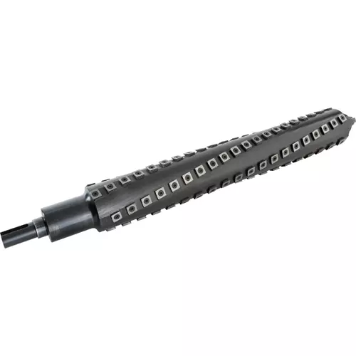

The T27694 20" Helical Cutterhead provides quiet operation, better dust collection and dramatic improvement in finish over straight-knife cutterheads.
Each indexable carbide insert can be rotated up to three times to expose a new sharp edge. No more changing and resetting knives every time a blade gets dull.
The indexable carbide inserts are positioned along a helical pattern with the cutting edges at a slight angle to the workpiece for a shearing action that leaves a glassy smooth cut even on the toughest of woods.
The T27694 comes with all 100 inserts on the cutterhead.
The T27694 installation instructions were written by our U.S. based Technical Documentation Department and is packed with useful information.
The complete and easy to read instructions makes it easier to change the cutterhead on your planer.
We strongly recommend replacing the old cutterhead bearings at the time of installation. The T27694 uses (2) P6206ZZ bearings.
Parts for the cutterhead may be available online and shipped from the Grizzly parts warehouse in Springfield, MO.
  • Maximum width of cut: 20"
  • Cutterhead diameter: 81mm
  • Number of indexable carbide inserts: 100
FITS:
  • Grizzly G0454 Series 20" Planers
  • Grizzly G1033 Series 20" Planers (mfg. since 1995)
