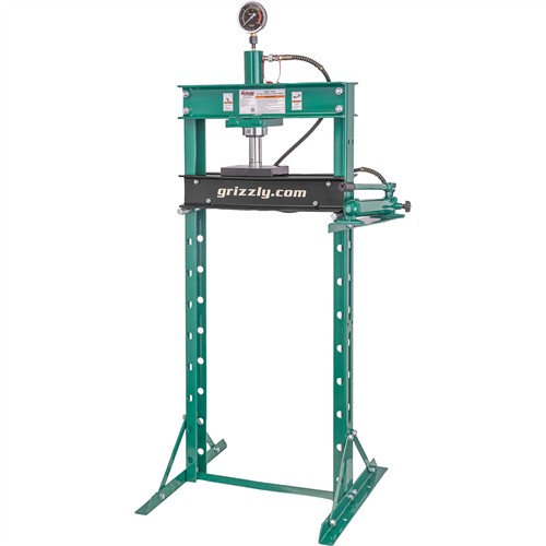

T34347 20-Ton Hydraulic Shop Press
A heavy-duty shop press with superior stability and versatility for tasks from pressing to bending.
This industrial hydraulic press offers solid construction for the reliability you need whether you are pressing bearings, riveting parts together, or coining metals.
Tough arbor plates make it easy to switch between extreme force tasks including broaching, staking, and disassembly by evening out load distribution and ensuring proper positioning.
The pump cylinder is welded for structural integrity so it can easily handle the pressure of metal bending and other processes.
Additional user-friendly features of this shop press include hand-pump operation, an interchangeable ram end, a force gauge, and adjustable table height.
Whether you use this industrial hydraulic shop press for automotive repair, large-scale manufacturing, or general metalworking, it is ready to meet all of your job requirements.
FEATURES AND BENEFITS:
  • H-Frame Design: The sturdy H-frame shape offers maximum support and ensures accuracy during every press operation.
  • Two Heavy-Duty Arbor Plates: Created to withstand high-pressure applications, these steel plates can be used for a wide range of tasks.
  • Welded Pump Cylinder: Welded construction ensures durability, minimizing wear and tear and providing reliable performance over time, even with repeated use.
  • Hand-Pump Operation: Get direct control over the amount of force applied and a more controlled press cycle.
  • Interchangeable Ram End: Easily switch between different ram ends as needed based on material type.
  • Liquid-Filled Pressure Gauge: Provides highly accurate pressure readings even in harsh conditions.
  • Adjustable Table Height: Modify the table height as needed based on workpiece size for the most effective ram travel and pressure.
  • Ram max applied force: 40,000 lbs. (20 tons)
  • Ram maximum stroke: 7-1/2"
  • Ram piston diameter: 2.36"
  • Ram face diameter: 1.89"
  • Maximum distance to table: 38-1/2"
  • Minimum distance to table: 7/8"
  • Bed support pin diameter: 1"
  • Bed adjustment holes: 9
  • Bed adjustment hole spacing: 4-1/2" on center
  • Hydraulic fluid type: Standard hydraulic jack oil
  • Footprint: 29" x 27-1/2"
  • Overall dimensions: 33" W x 27-1/2" D x 70" H
  • Approximate shipping weight: 209 lbs.
Get a multi-functional hydraulic shop press with the reliability, strength, and durability needed for professional and industrial shops.
